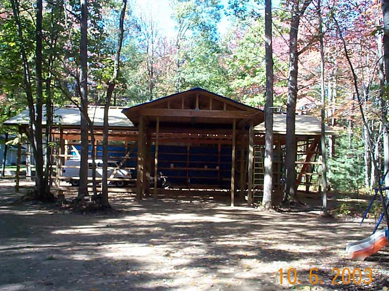

Weekend Update
I had a good day and a half to work on the pole barn roof this weekend. That is enough time to put a lot of sheathing down but not enough time to get it covered up from the elements. I priced out 1/2" plywood and the cheapest I found was at Lowe's for 15.58 per sheet. Because the price is so high it was easy for me to justify buying treated plywood instead. The 1/2" treated plywood was 16.99 a sheet so that is only 1.41 more. I could safely put up the treated plywood and not worry about it being exposed to the elements. I've got a lot of work coming up (I work on the road) so I know it will be at least November before I can attempt to put shingles up. I bought 20 sheets and got all of them put up. I still have 7 more sheets to put up on the top row and those 3 triangular pieces to finish off the one valley and then all the sheathing will be done. Then I have to trim the overhangs, put up the fly rafters, etc., etc. IT MAY NEVER END /forums/images/graemlins/frown.gif
I might be scraping snow off the roof to put shingles on this winter but even as the roof is now I know I won't have to scrape ice off my windshield /forums/images/graemlins/grin.gif
Here is the first of two pictures.

Second picture
Its weird how the perceived size of the barn changes as the building gets farther along. Before I had any trusses up the thing seemed huge. Then after the trusses were on the building seemed smaller. Now the a lot of the roof sheathing is on the building seems larger again.

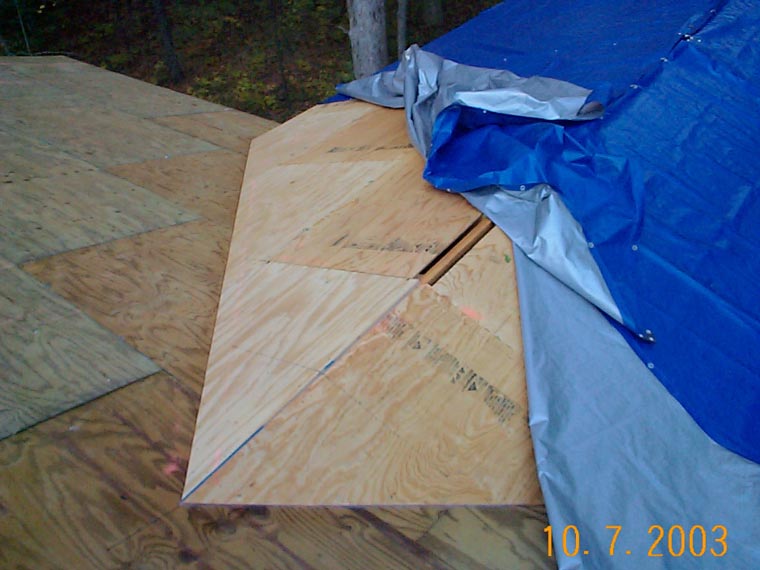

</font><font color="blue" class="small">( I still have 7 more sheets to put up on the top row and those 3 triangular pieces to finish off the one valley and then all the sheathing will be done. Then I have to trim the overhangs, put up the fly rafters, etc., etc. IT MAY NEVER END /forums/images/graemlins/frown.gif )</font>
I got those 3 triangular pieces finished up on the valley on Monday night. It may not seem like much progress but getting those valleys finished is a big relief for me. I have quite a variation of colors of wood in this photo. I have two different brands of pressure treated plywood on the main roof. On the valleys it is all the same plywood but the three pieces I put up didn't have the Thompson's water seal on them yet when I took the photo.
