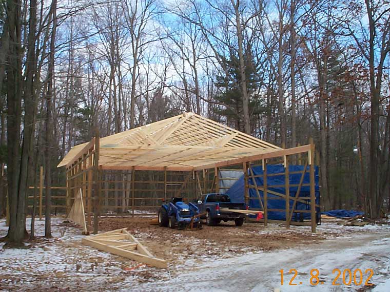

It's fully shingled now !!! /forums/images/graemlins/grin.gif
Here is a picture taken at this time last year to show how much (or little) progress has been made on this project in exactly one year.

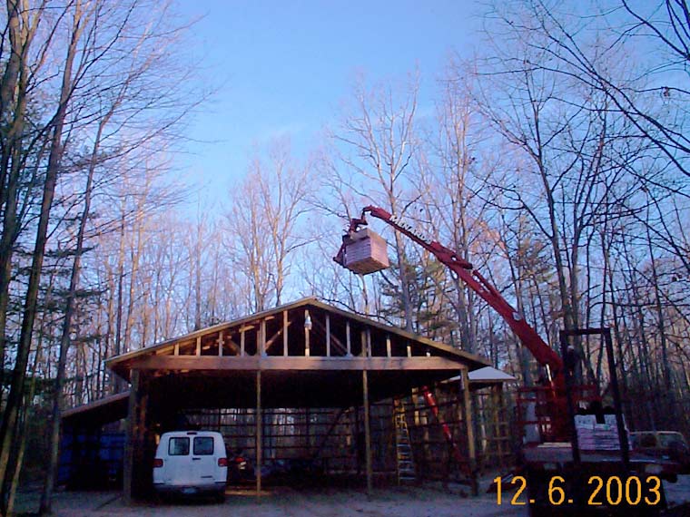

Here is a picture from this last Saturday morning. I don't have the use of my pickup truck (maybe a story for a different thread) so I had the materials delivered. As long as I was having them delivered I thought I may as well have them delivered up onto the roof. The delivery charge was $39.95 and the roof delivery was .75 cents per bundle of shingles.

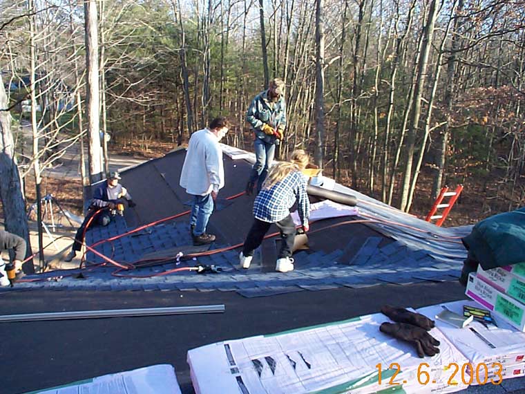

This picture shows the Ice Shield and the tar paper going on the roof. The Ice Shield was used on the bottom eves and in the valleys.

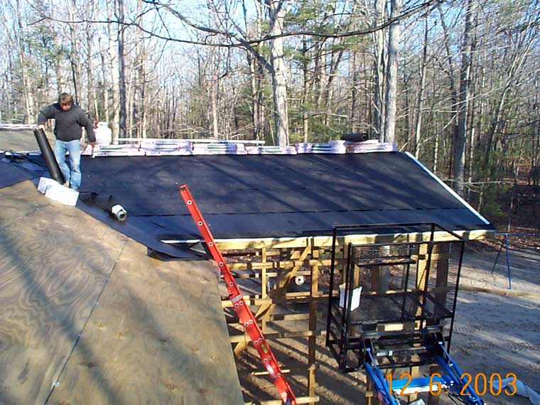

This picture shows most all of the tar paper on the roof now. If you have been following this thread at all you know that there is no way I made this much progress in a few hours working by myself. I have done at least 95% of this whole project with just me and my tractor but I decided to hire a roofing contractor to get these shingles on for me.

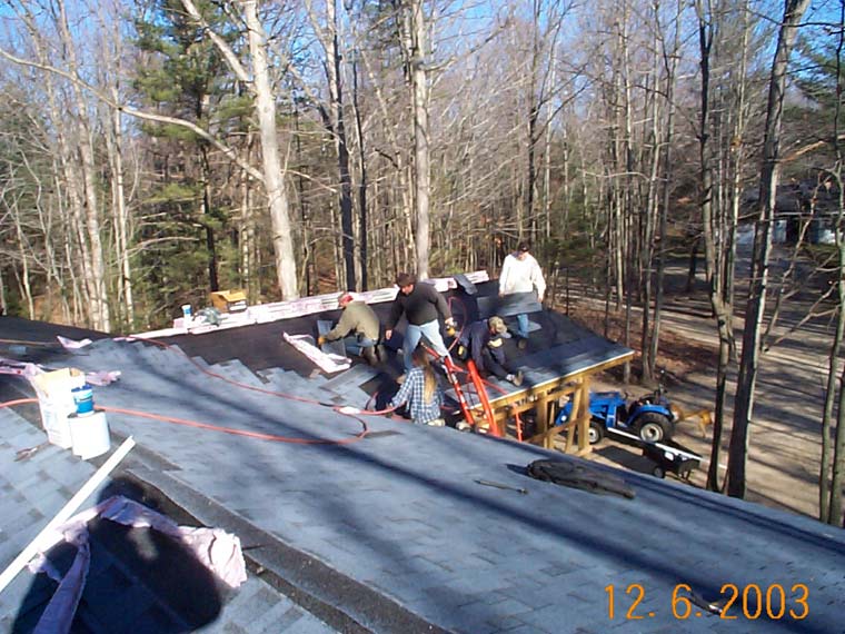

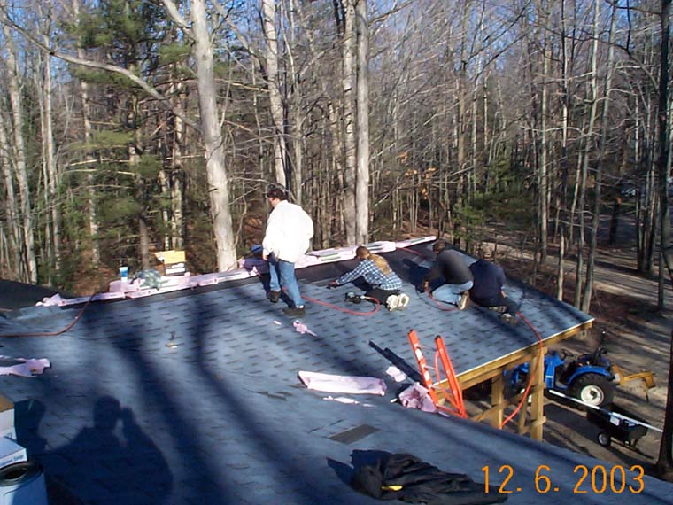

This picture shows the roof being shingled over to the first valley. There were five roofers here for a good portion of the day. Three of them were leaders and two of them were helpers (three helpers if you count me).

Re: Spencer\'s Pole Barn Project
This picture shows the shingles being run both ways into the first valley.

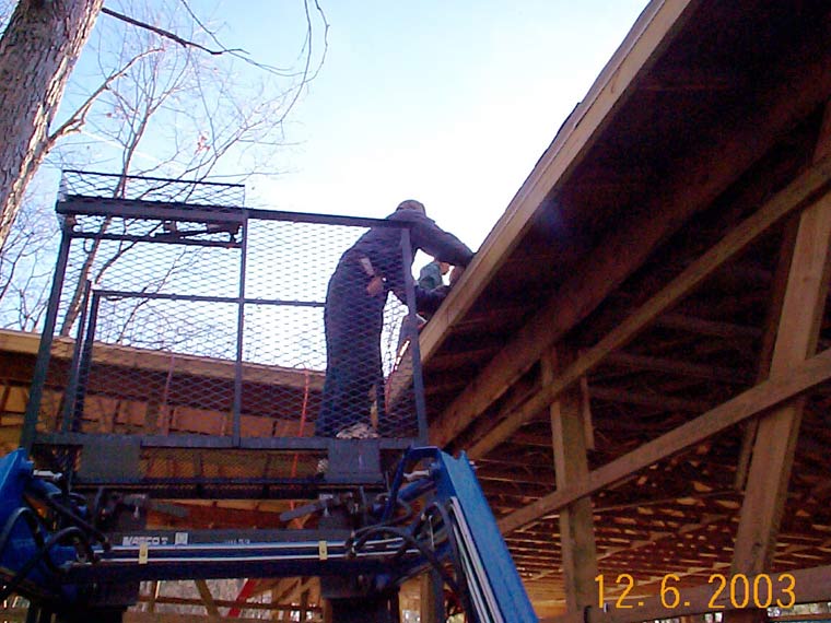

My tractor and the personnel lift that I built for it got in on the act a little bit. That Ice Shield that was put down on the bottom three feet of the eves is extremely slippery. The roofing contractor had initially told me to make sure I bought the granulated style instead of the smooth style. The employee at the building department at Menards told me the smooth style was better so I called the roofer up and asked him if it was ok to use the smooth stuff. He said sure because my roof was only a 4/12 pitch. Even though it was only a 4/12 pitch using this smooth stuff was pretty dangerous. I can see now why he initially wanted the granulated stuff. He did concede that the smooth stuff seemed to be a better product.
