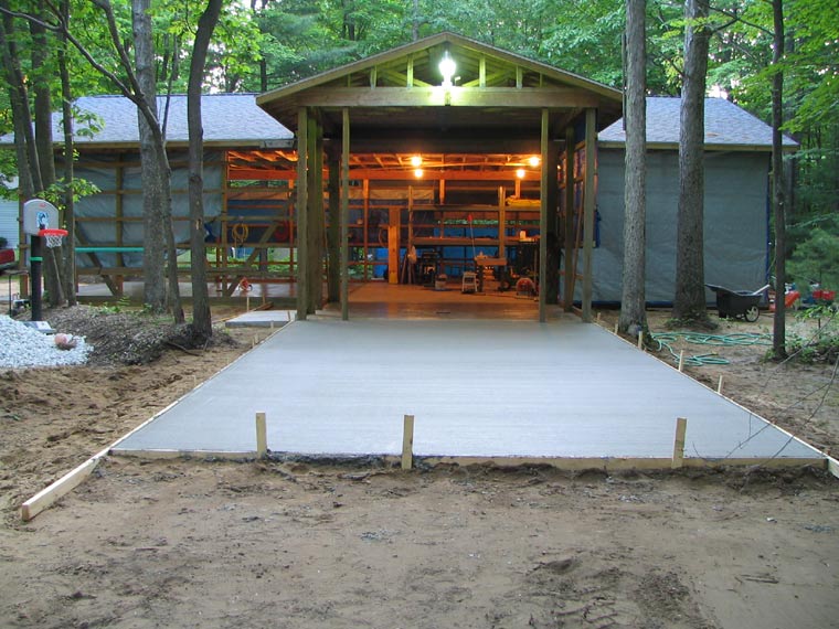

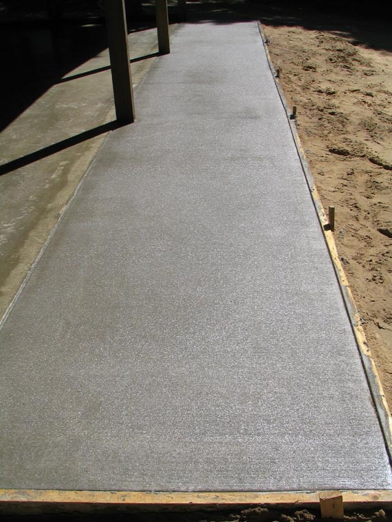

Here is a picture of the approach right before I put two coats of sealer on it. I should mention that all of the concrete that I had this crew pour was a "six-sack" mix with the fiber additive. The concrete that they poured inside the barn was on top of a vapor barrier so the concrete supplier recommended adding a "superplasticizer". When using a superplasticizer you don't need to add as much water to the mix. All of the concrete was poured 4" deep except for that 16'x16' section inside the barn. I had them pour that 16'x16' section 6" thick.

Here is the last picture for now. This shows what the 4' section looked like after two coats of sealer. The concrete crew is coming back in a day or two to cut in all of the control joints.

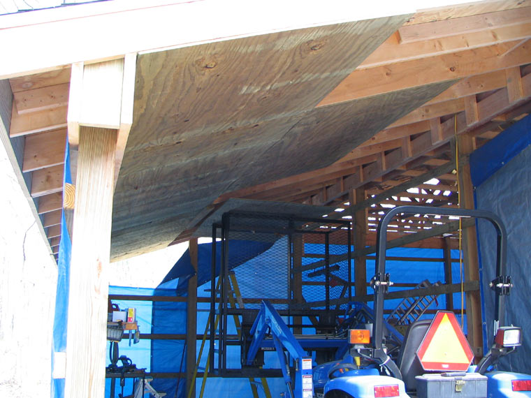

#428
Re: Spencer\'s Pole Barn Project
I'm going to back track a little bit here with the pictures. I did get some soffit up and all the plywood on the ceiling on the lean-to side of the pole barn back in April. I just never had the time to post the pictures then.
Here I am putting some plywood up on the ceiling in the lean-to with a little help from my TC33-D.

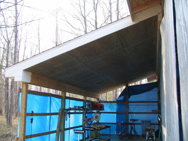

   / Spencer's Pole Barn Project
#429
Here is a picture of the ceiling finished in the lean-to.

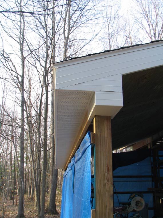

#430
Here is a picture of the soffit on the lean-to. Unfortunately, this was about all the further I got on the soffit until Thanksgiving.
