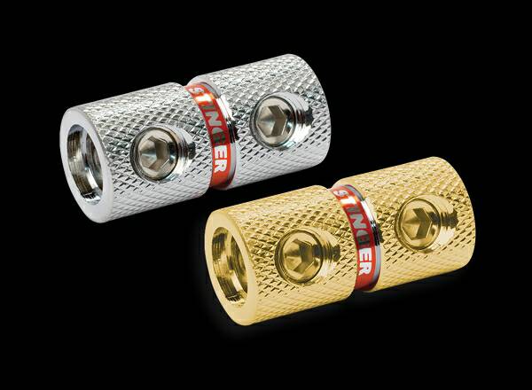

Any decent car stereo shop will have these. They work great. Just wrap or tape them up.
