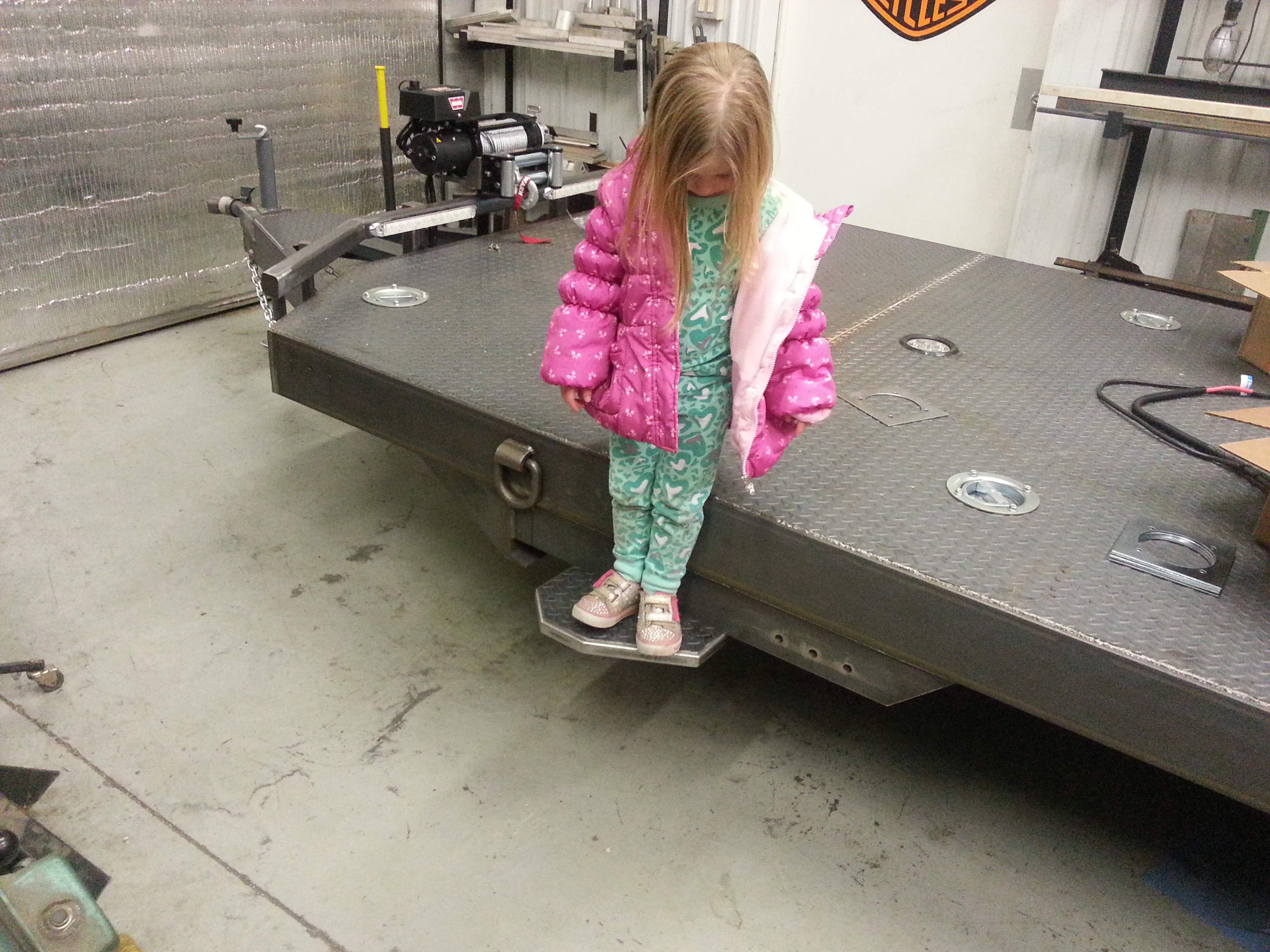

#148
Kid tested, she approved.

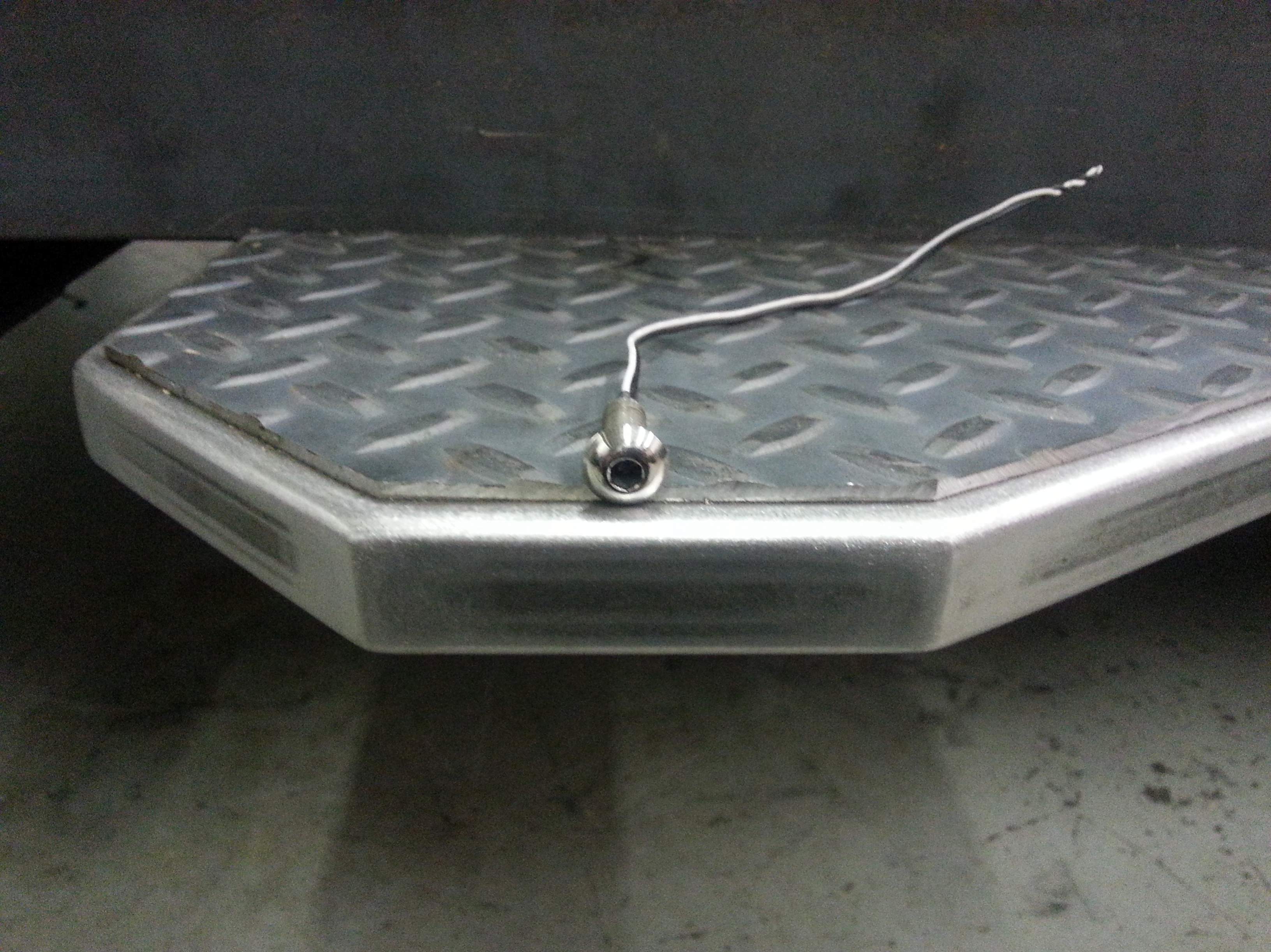

#149
I'm not sure about the light. I don't want to over do it with lights. It's a tiny single L.E.D. and I think it'll look cool but I don't want it to look like a Christmas tree semi going down the road. I'm still on the fence with this one, what do you guys think?
   / Split-dovetail car hauler trailer #150
I think it's perfect. Having a small amount of illumination will help you find the step at night. Might save a twisted knee or banged shin. Plus it will look cool.
