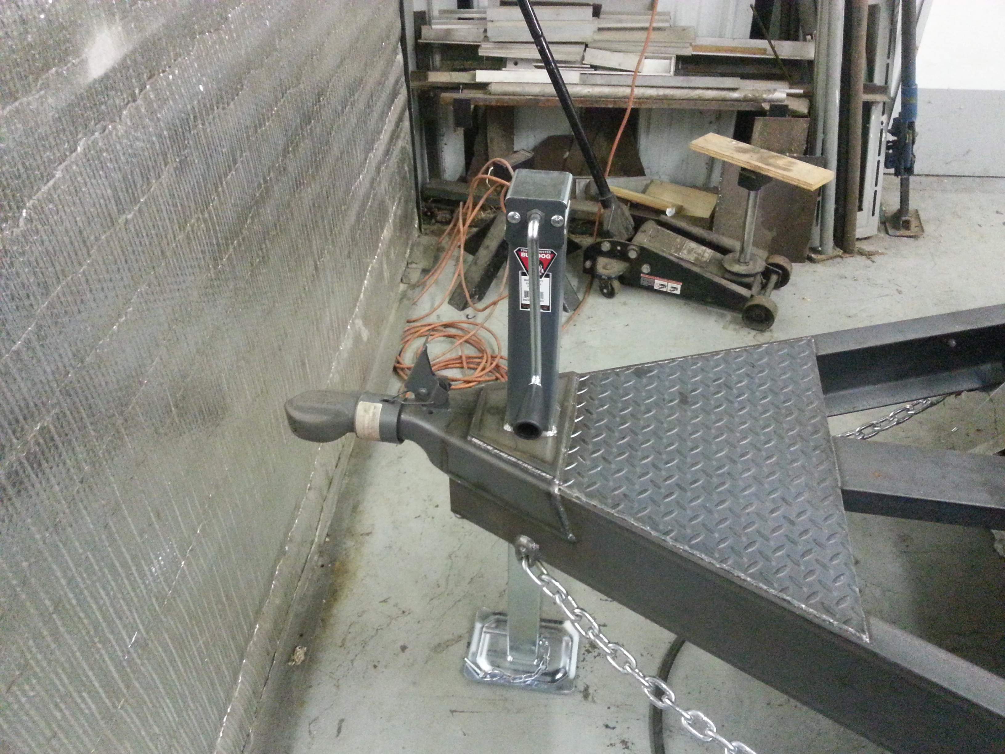

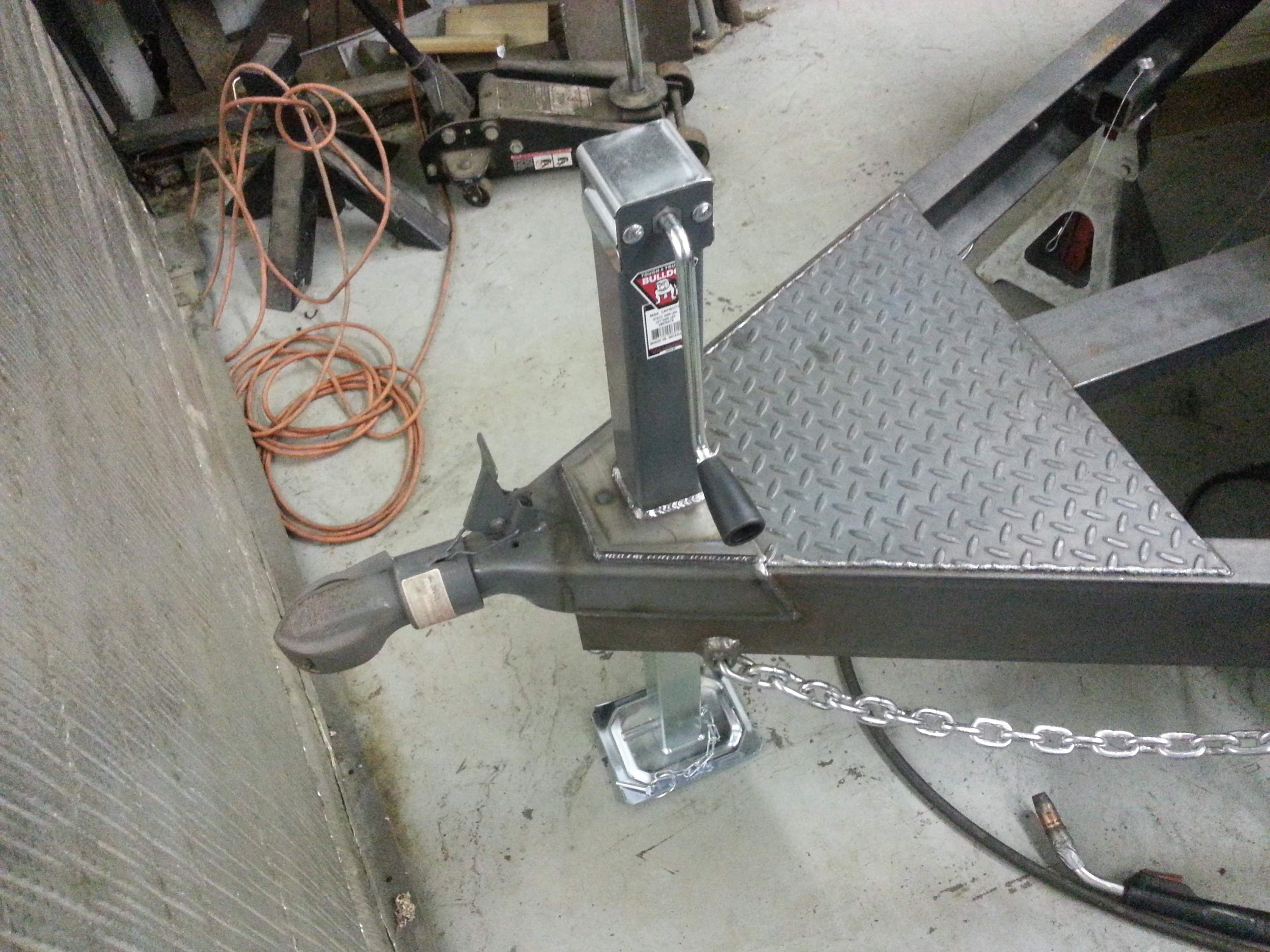

Nice work! I always install the tongue jack back a foot or so from where all trailer installers usually put them,(usually in the hole in the Atwood 2 5/16" coupler,) I like to be able to lower the tailgate on my trucks,and be able to back up with the tailgate down,without having to use an extended length receiver .

Thanks. That's a good idea if you have a tailgate.

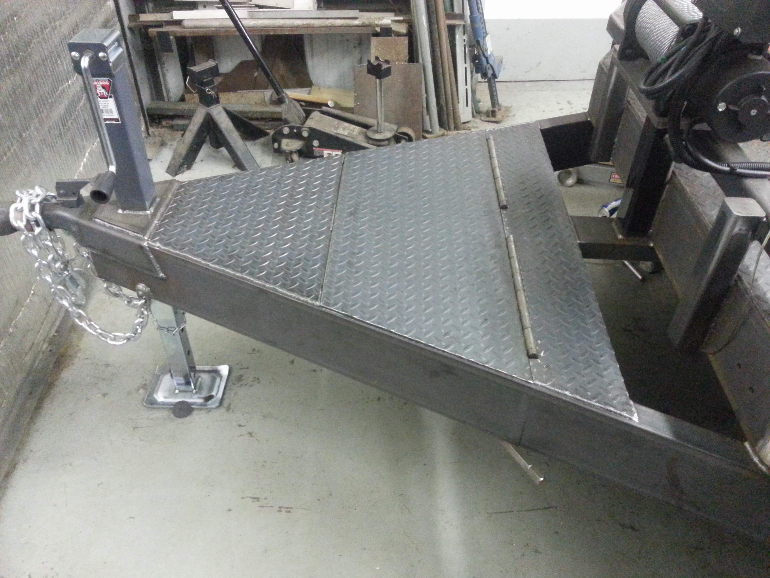

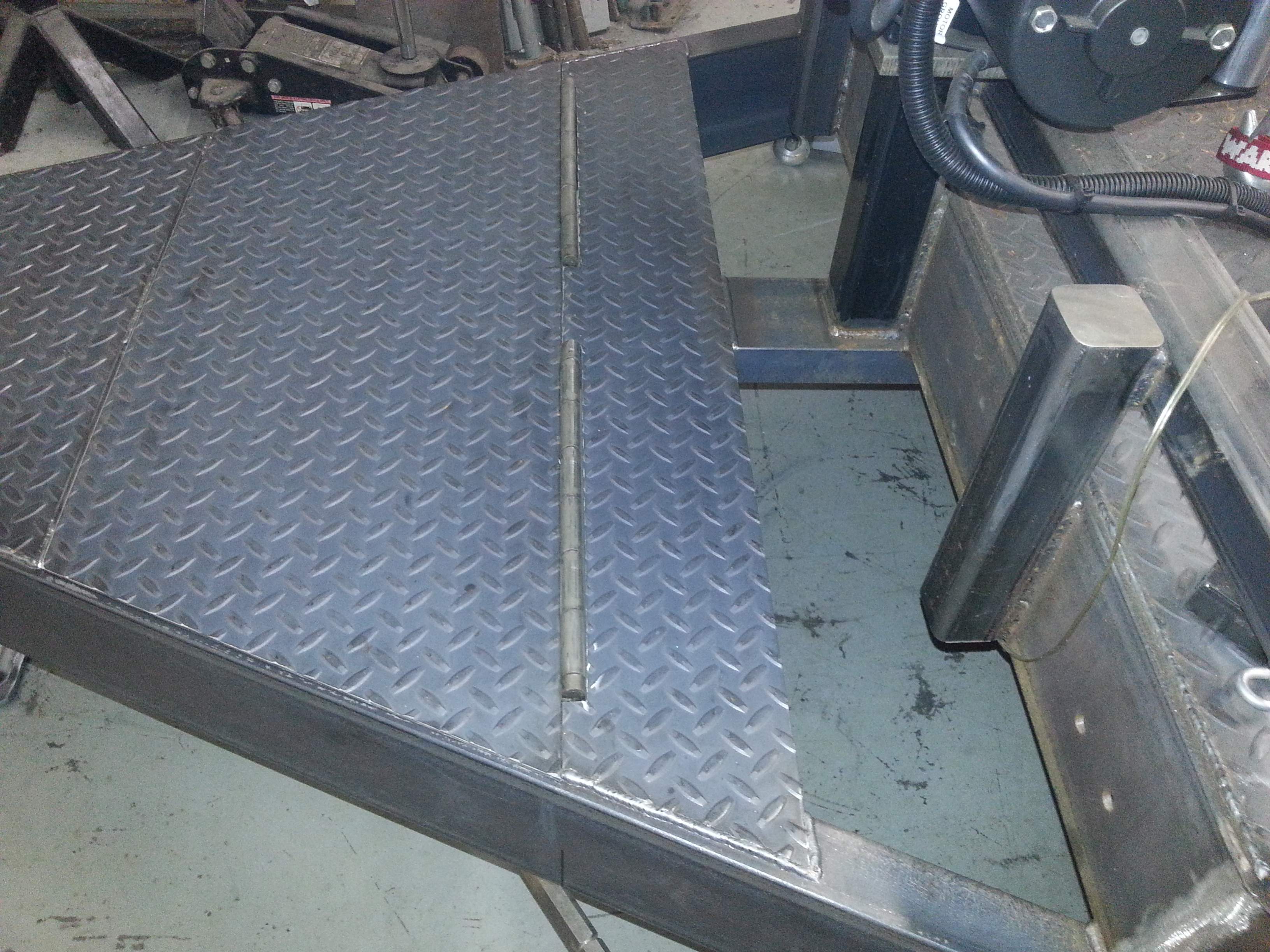

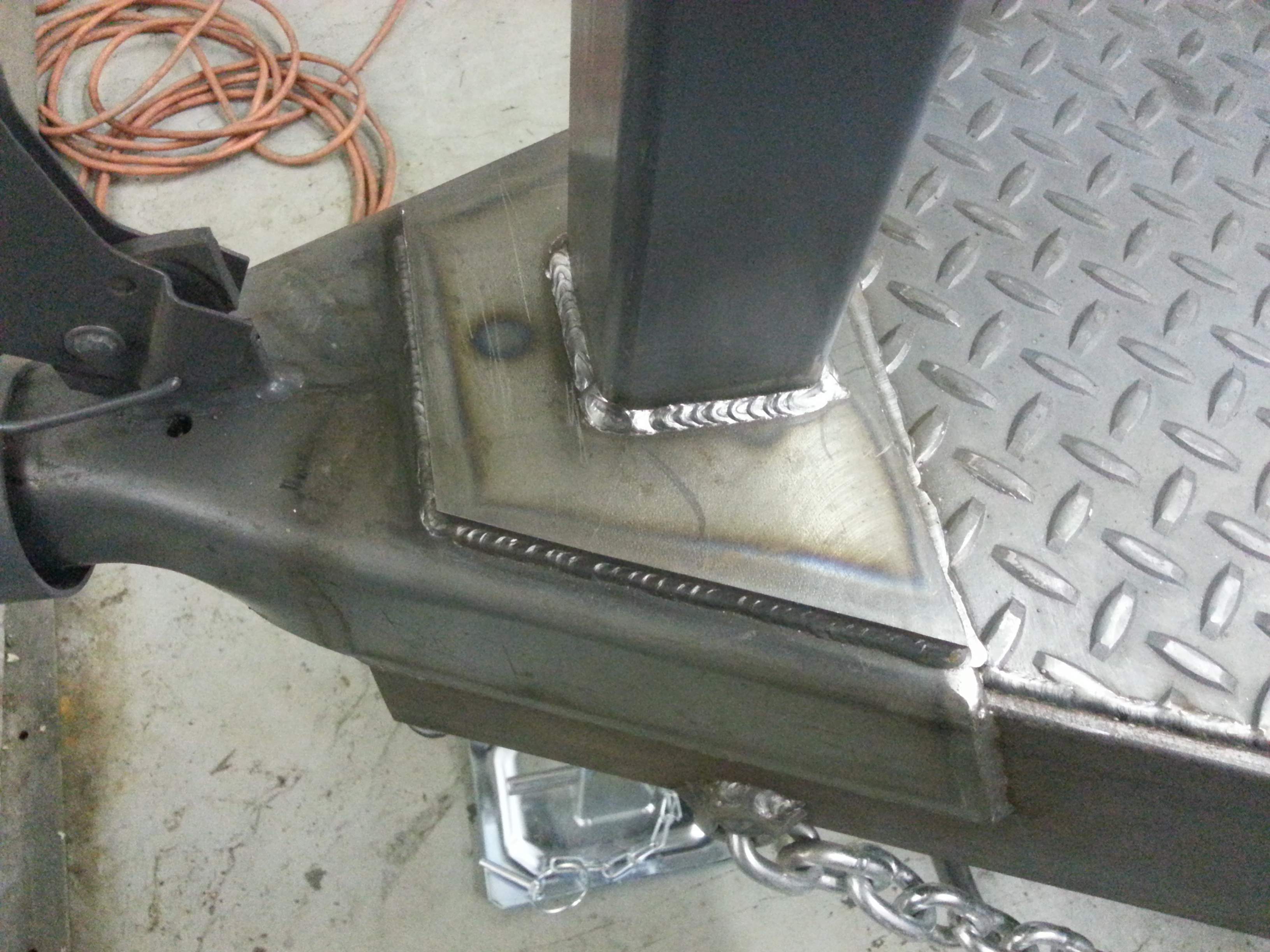

Jack welded on. I wire brushed the weld area with my grinder before welding it on. Other than the sticker being put on crooked, I like it a lot better.

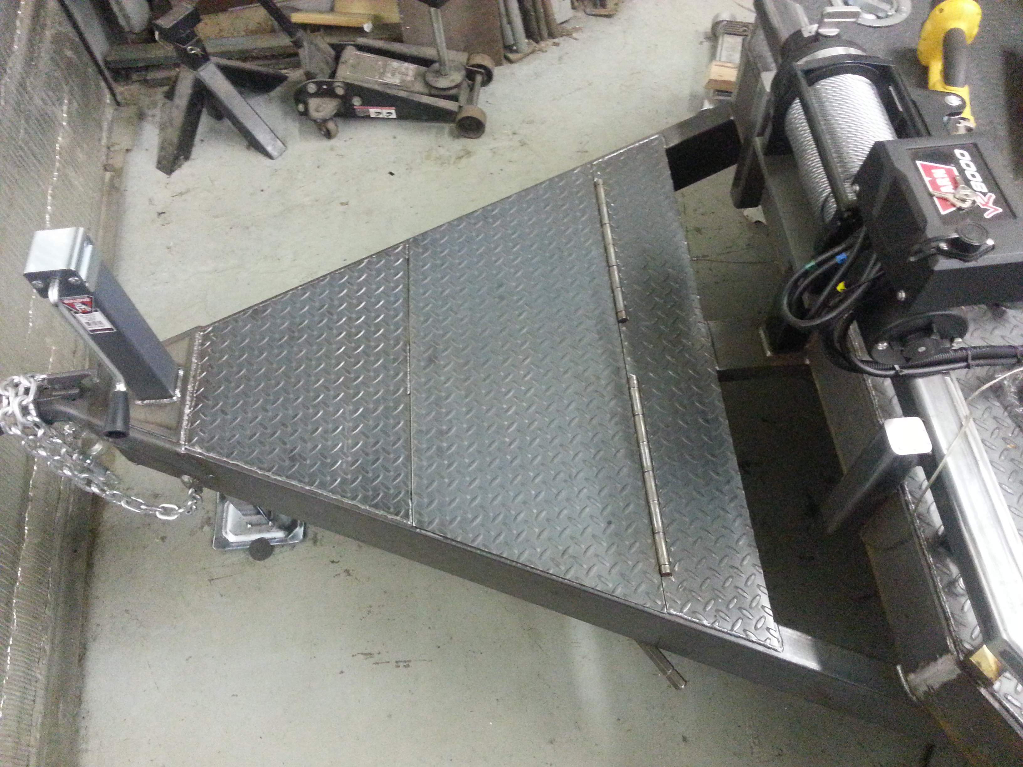

Since you put it right up front, you now have room for a winch right behind it. The first winch I mounted to my trailer I put right ahead of the deck area, and found it was too close to the loading area, a lot of vehicles hang over the a-frame area when they are all the way up on the trailer. You can't get a good pull on the vehicle the last couple feet when the vehicle is over top the winch.
So I just got done installing a new 12000lb winch from Harbor Freight, and I mounted it as far up front as I could, without it hanging over the sides where the truck bumper could smash it. Just used it today and it works a lot better up there. I also put a wooden floor in part of the a-frame to have a place for the battery and a little bit of storage for chains and binders.

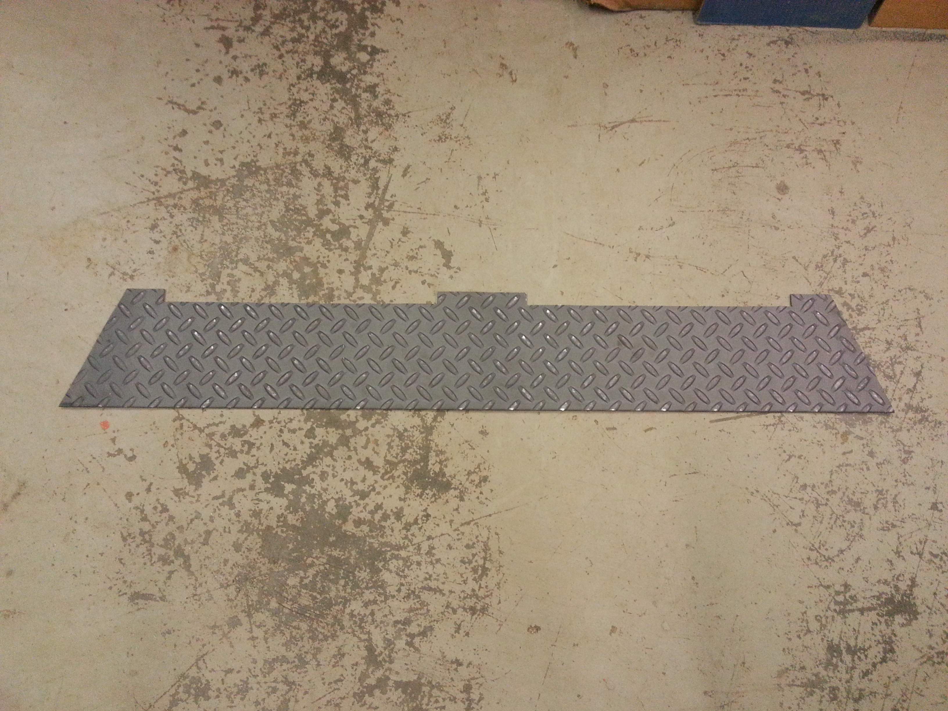

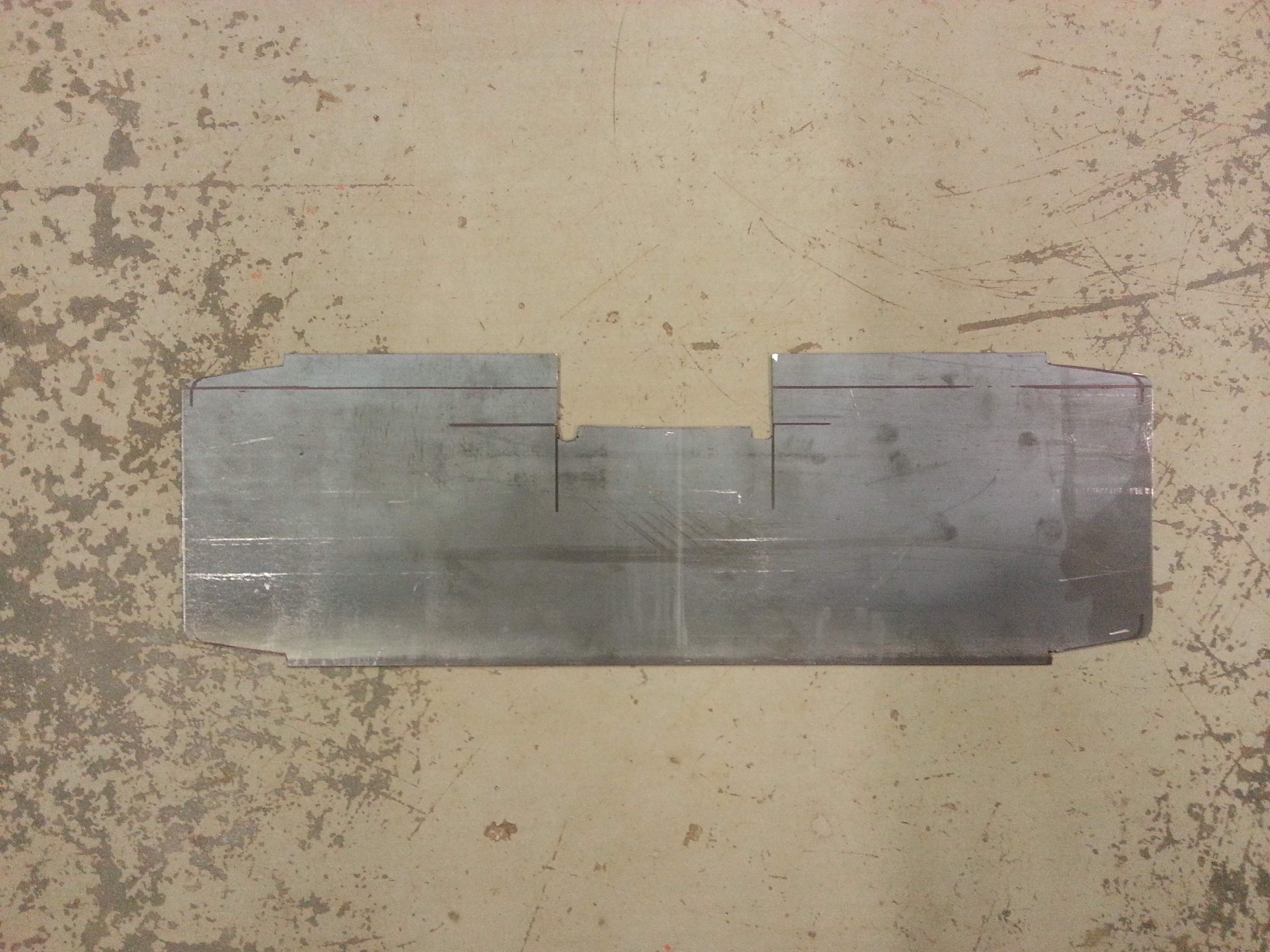

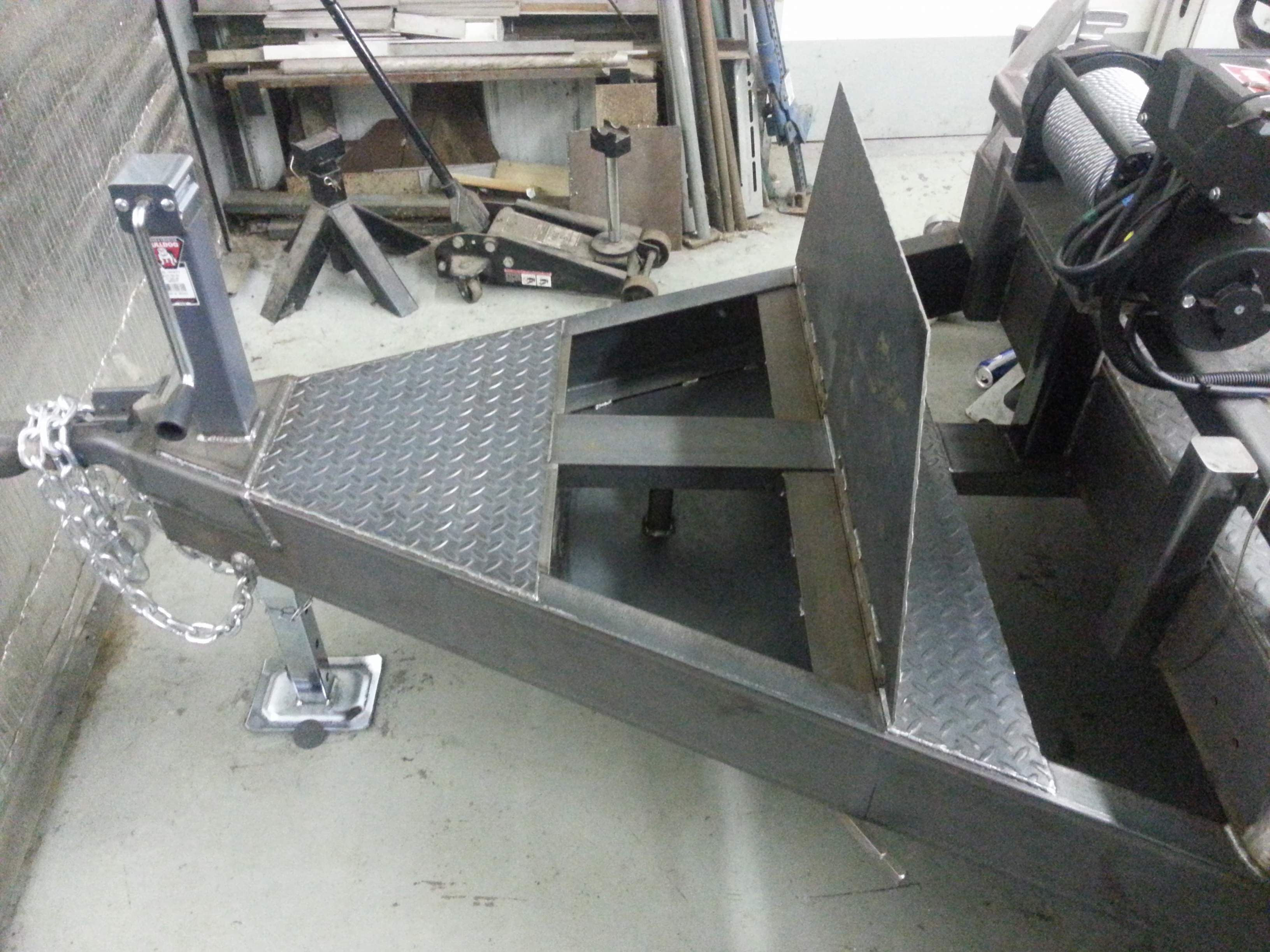

I haven't had a lot of free time to work on the trailer lately, but I've got a little bit done on it. I've been working on a toolbox to store straps and chains etc. I decided to box in between the a- frame and make a storage box that will be flush. I boxed it in with 14 gauge sheet, it was kind of tricky to get the cuts right.

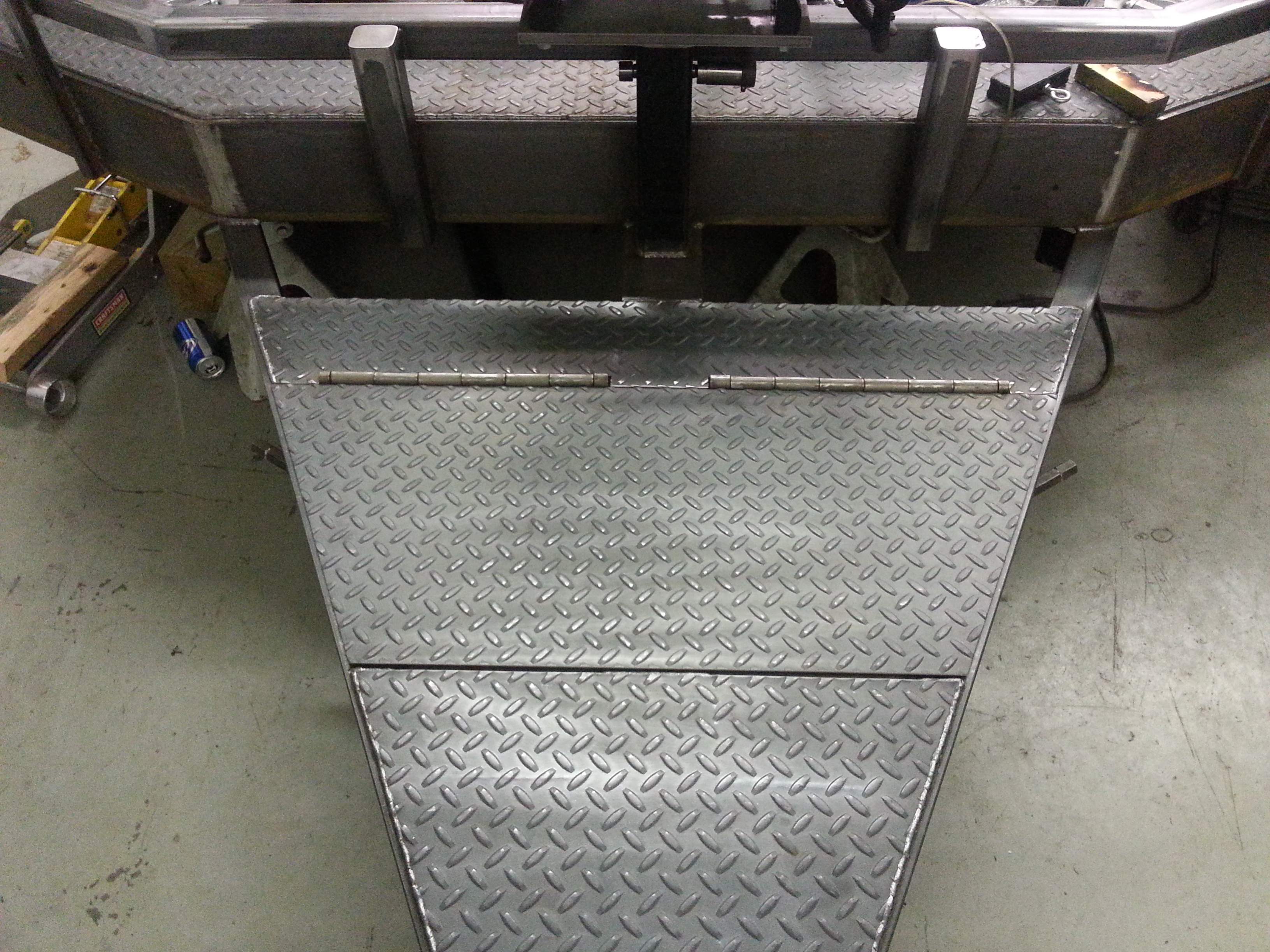

I made the lid and bottom out of the left over diamond plate from the deck, I wanted the top strong enough to stand on. I also made a trim piece to kinda bridge the gap between the box and the headache rack.

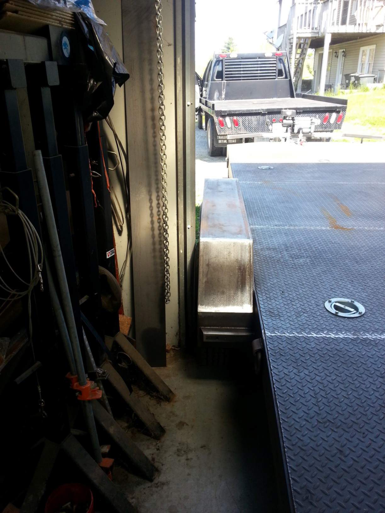

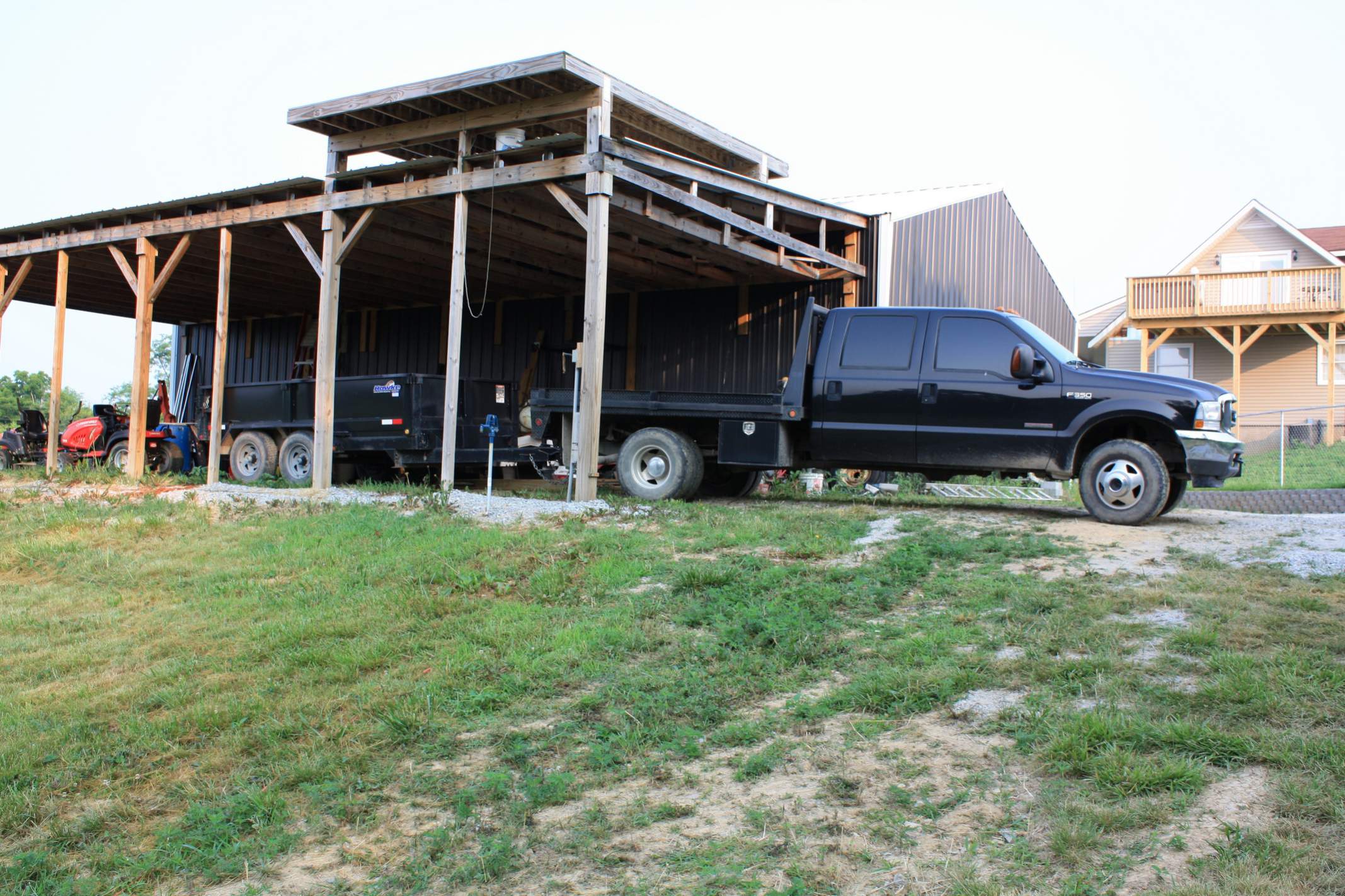

Pulled the trailer out of the shop, it was a close fit.
