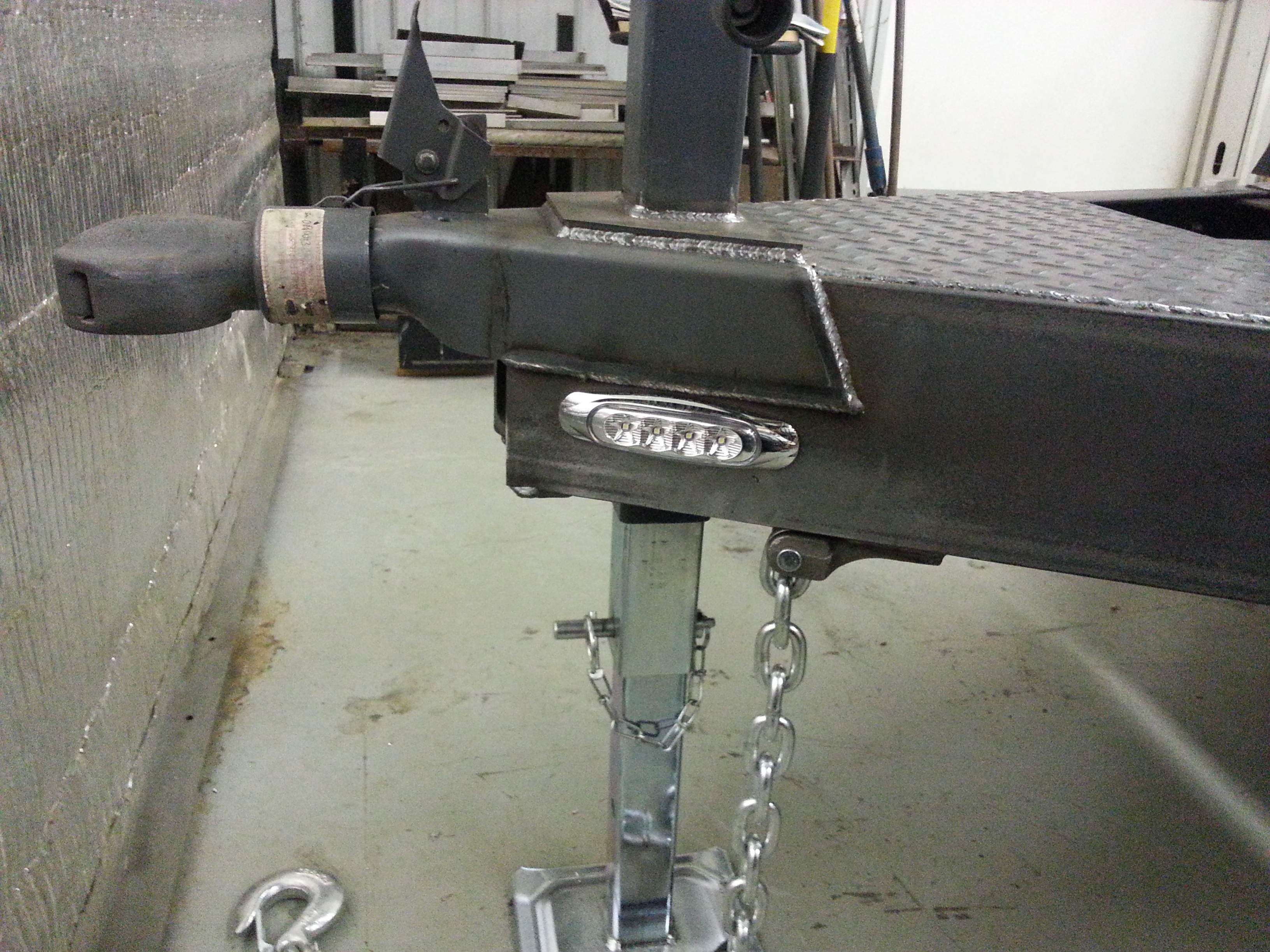

I reworked my safety chains, got the old mounts off with my grinder and welded the new connectors on.

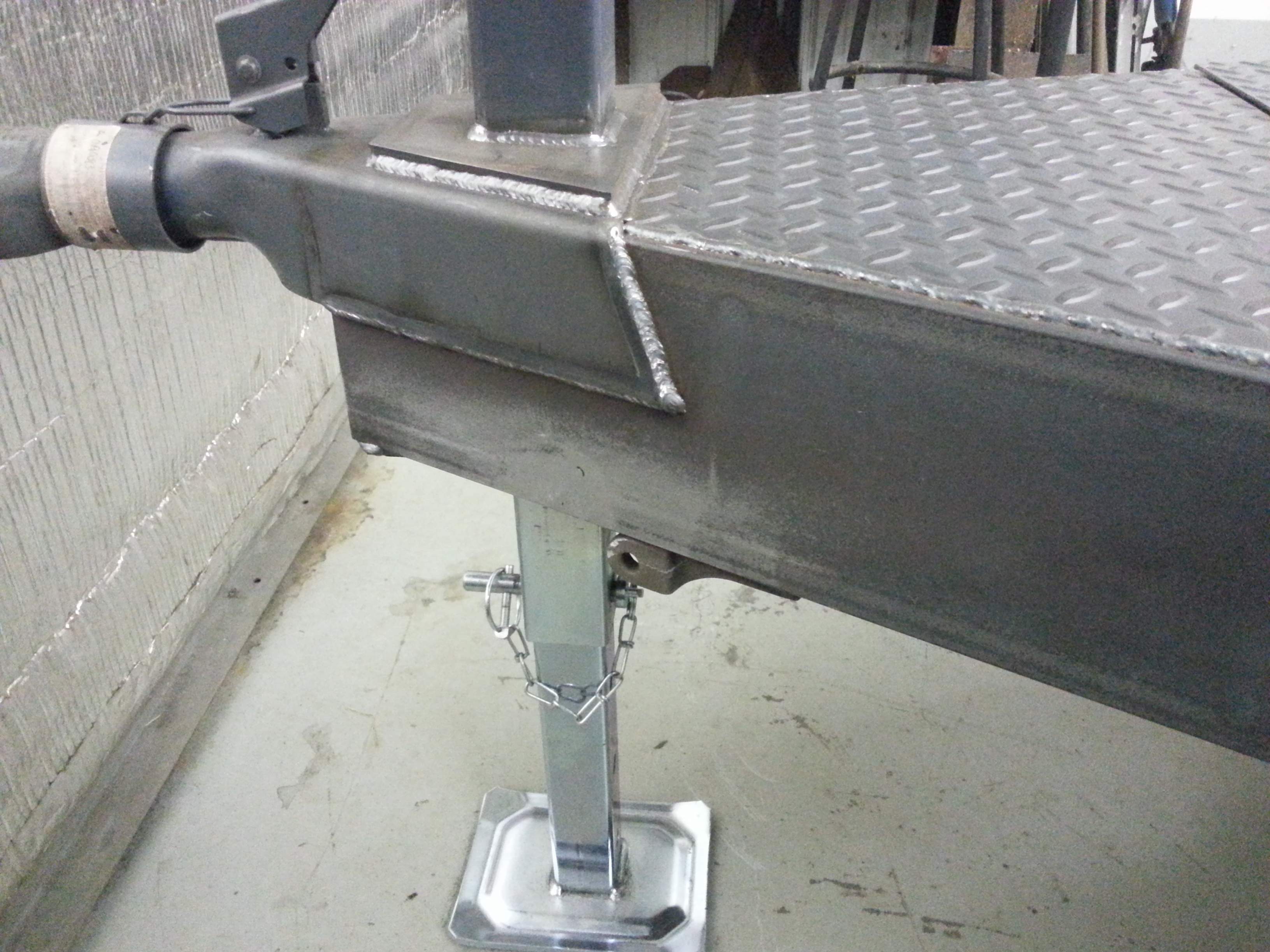

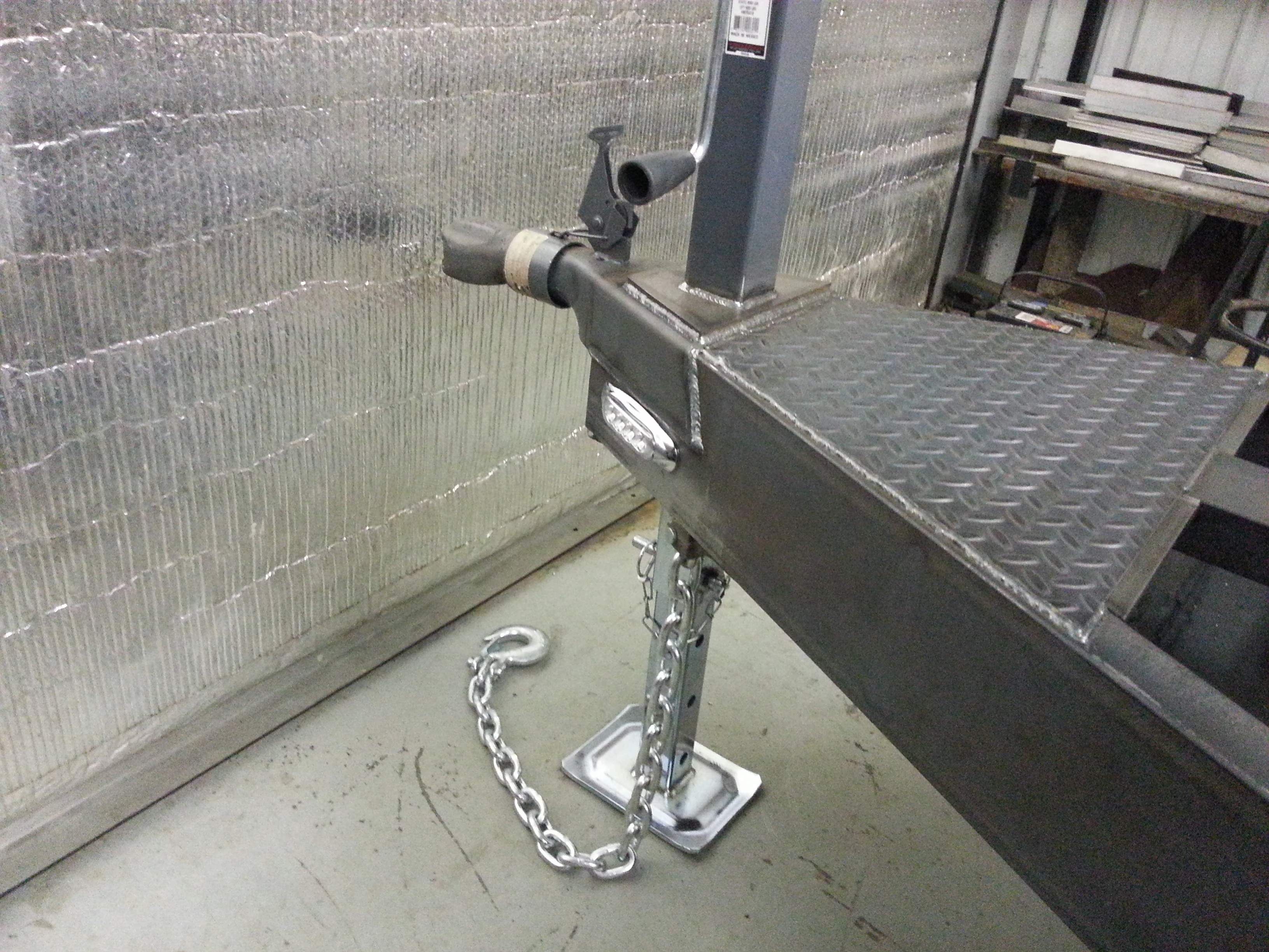

I also added a hitch light, not sure if it'll work with the angle its at, we'll see, I hid the switch under the trim piece of diamond plate. I also added a light inside the toolbox, hope to wire it so it come's on when the lid raises. The weather is supposed to be good Wed. and Thur. and i'm off work...time to paint.

have you thought of adding a hanger in the side of the tongue to hang the safety Chains from when them trailer isn't hooked up? Something so they aren't just sitting on the ground?
