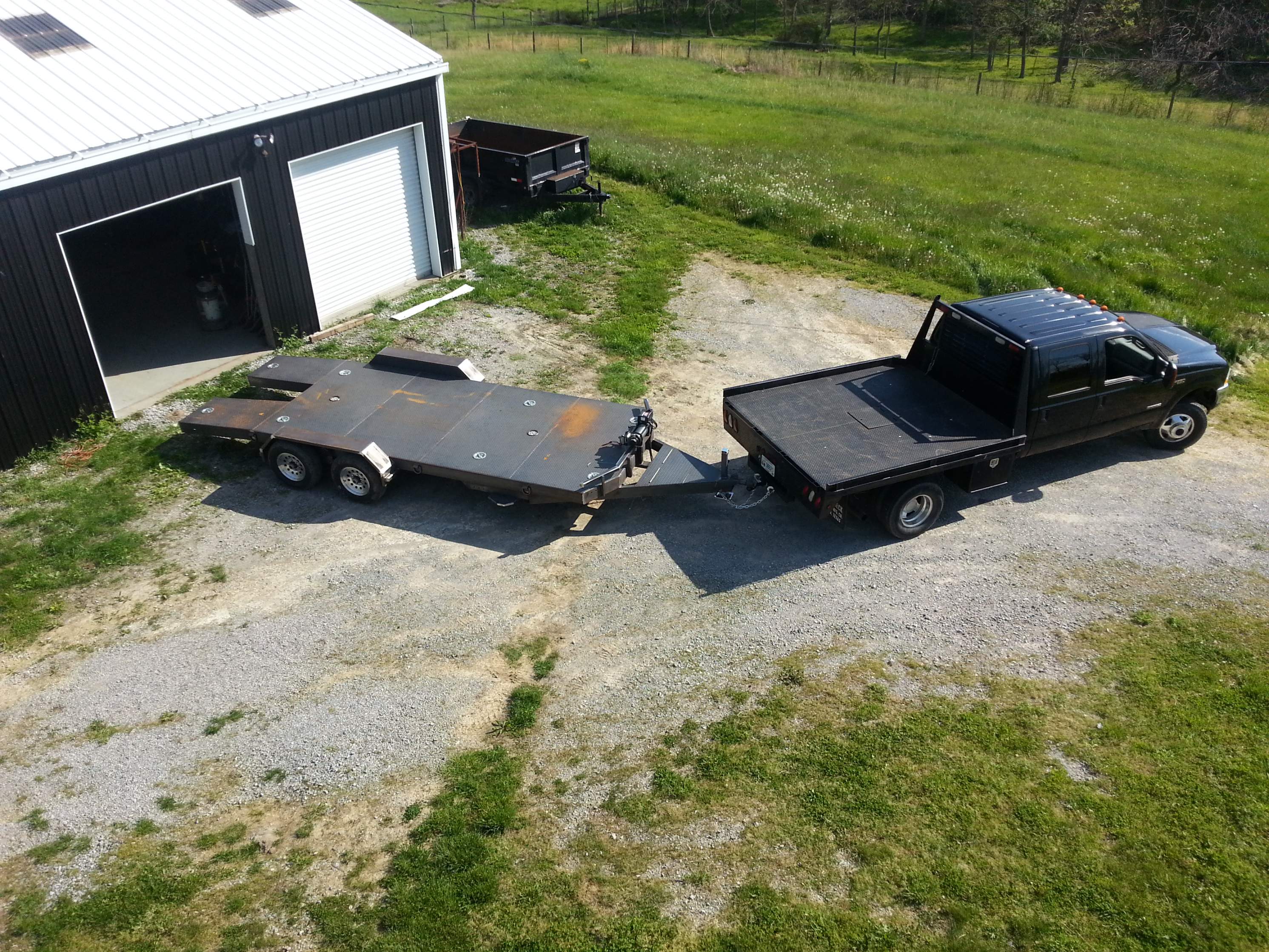

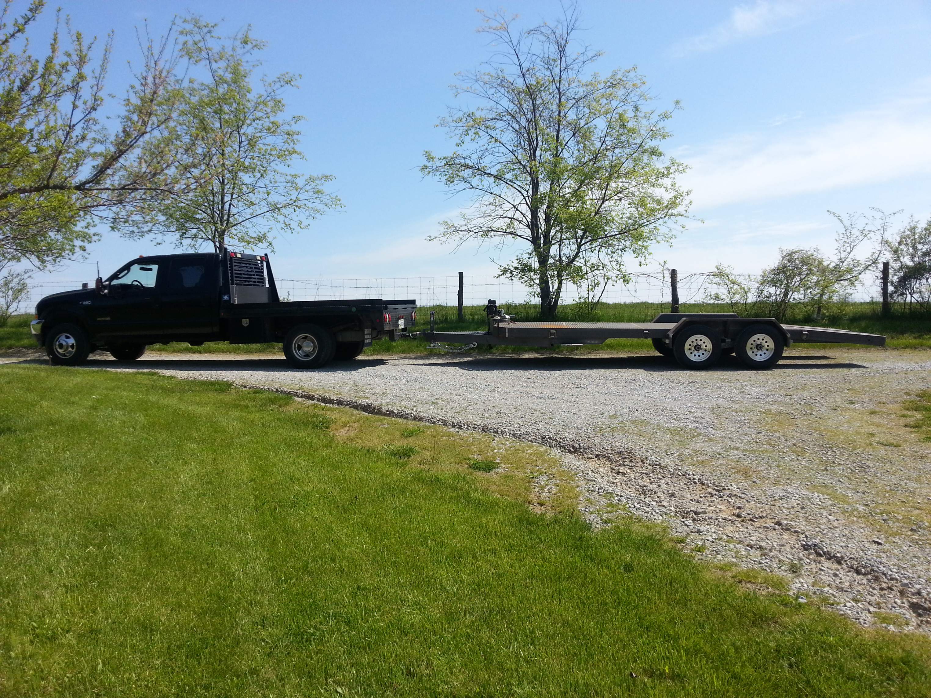

Here she is, less paint and a few other things. I pulled it down the road a few miles to see how it towed, was real happy with it. It seems a lot lighter than my dump trailer.

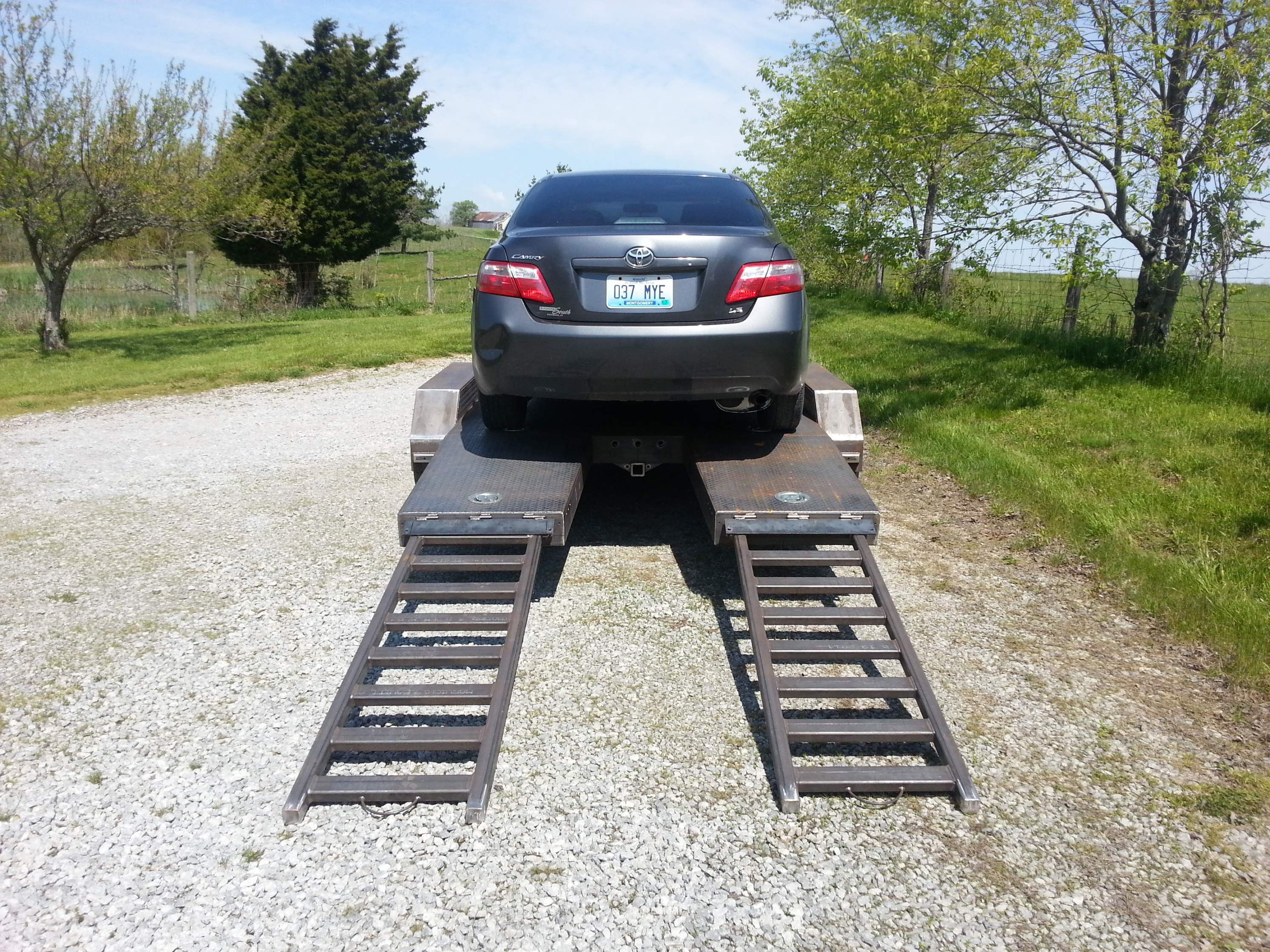

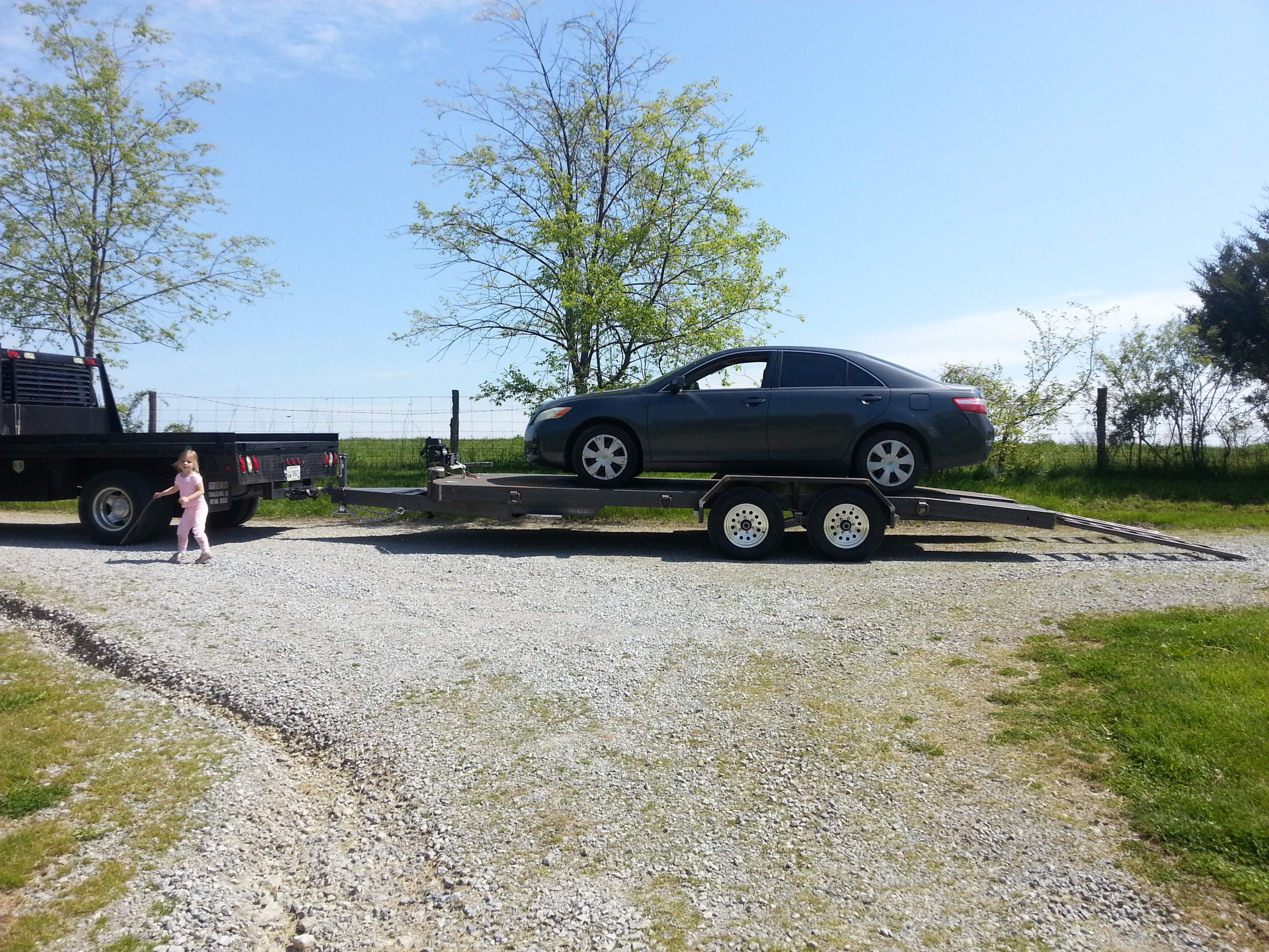

Loaded up, I didn't use the rear jack and the truck did fine. That's a Toyota Camry (if you can't tell), I had about 4 inches clearance between the door and fender. I decided to paint it myself with the help of another poster on another site ( thanks farmersamm). He did a full how-to paint thread for me on weldingweb, thanks again samm. I hope to get started painting sometime this week.

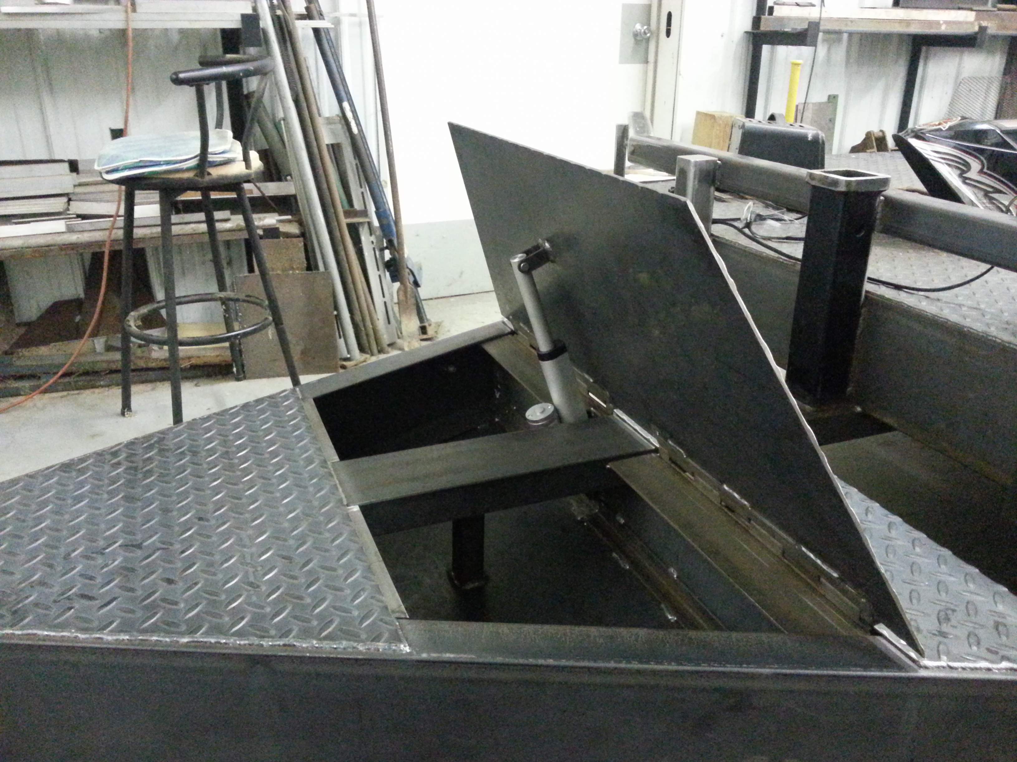

I finally got my linear actuator in and installed. I made two brackets for it and welded them on. It was kind of a pain getting everything to work in an enclosed space but I finally made it work.

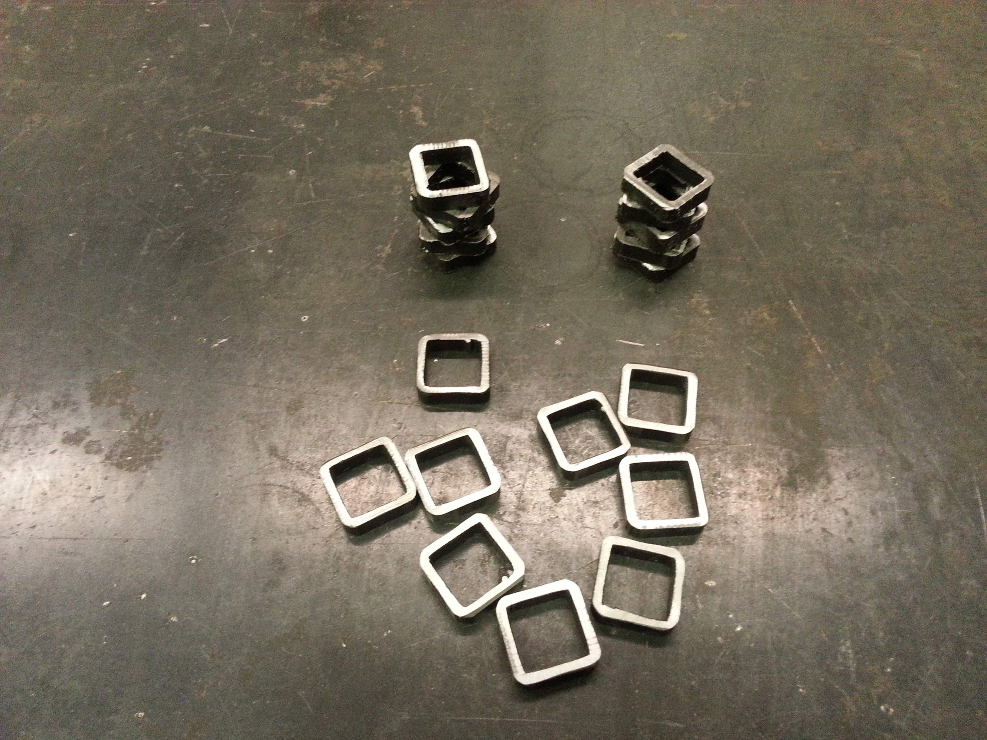

I've been making and welding on wire looms out of square tubing.

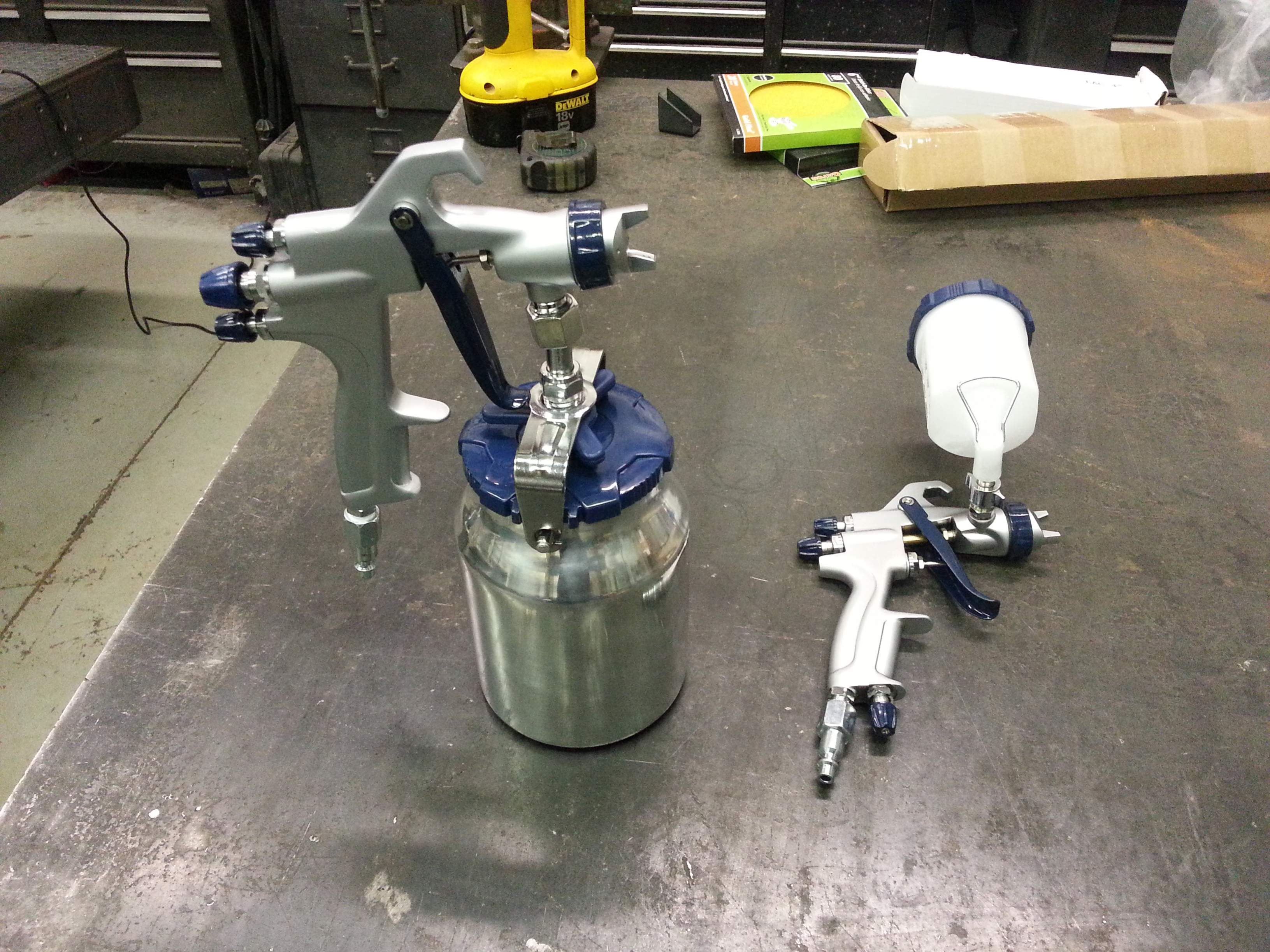

I also bought a paint gun to paint this beast with, hope to get started sometime this week.
attachment.php
That is awesome! :thumbsup:
I have never seen a powered storage box lid.
Thanks, I really didn't need it, but its cool to watch it in action.

When you welded on the spring mounts and the tongue, how did you square everything up? You said it tows nicely so that's a good sign that it tracks straight down the road. I'm thinking of building a trailer one day, and have been curious how precise the axle location needs to be?
Very nice build, btw.
   / Split-dovetail car hauler trailer
#240
I measured the same distance from both sides and also used a square. I used a string to center-up the tongue, I think there is a pic of that in an earlier post.
