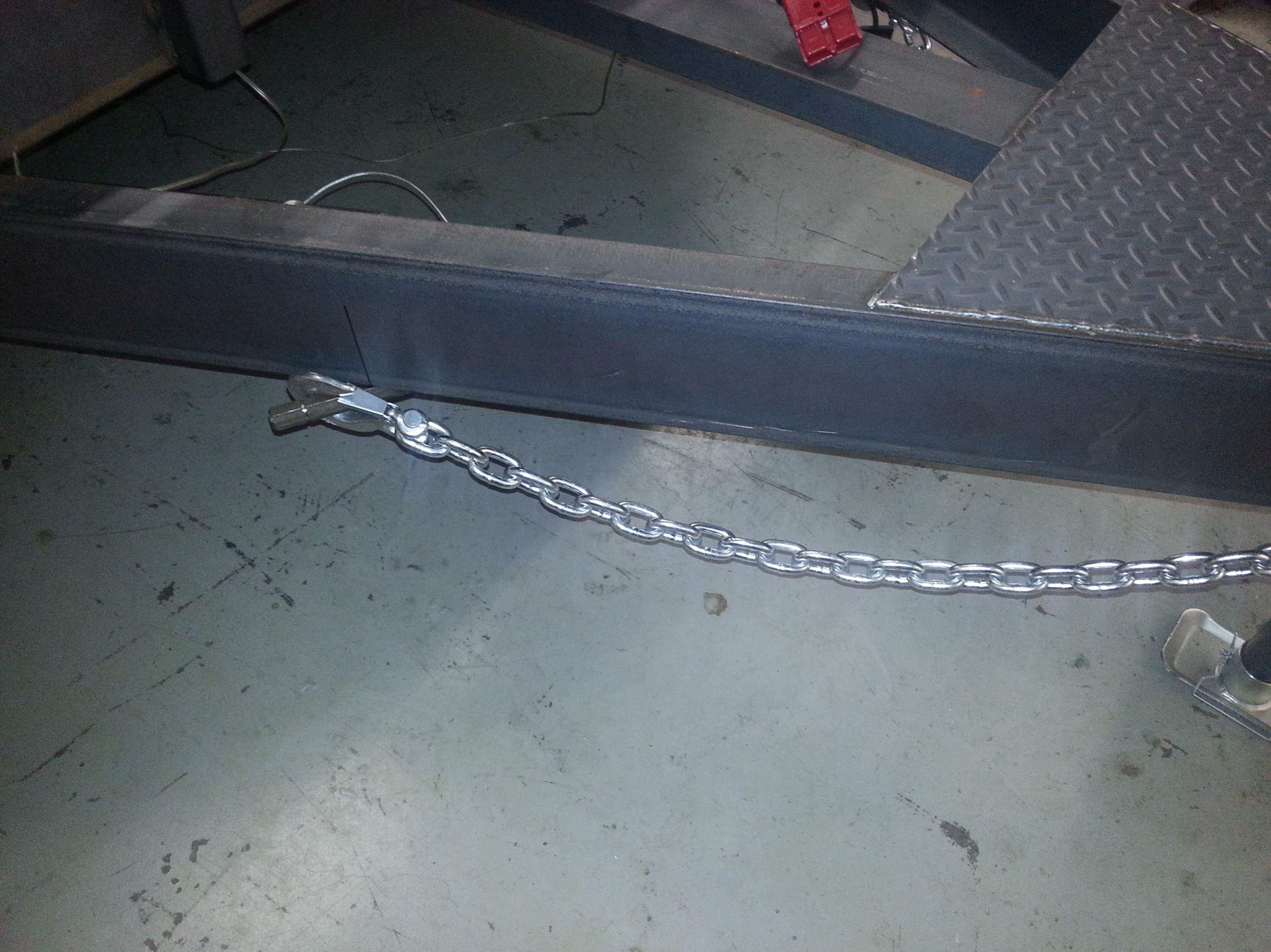

have you thought of adding a hanger in the side of the tongue to hang the safety Chains from when them trailer isn't hooked up? Something so they aren't just sitting on the ground?
I already did.

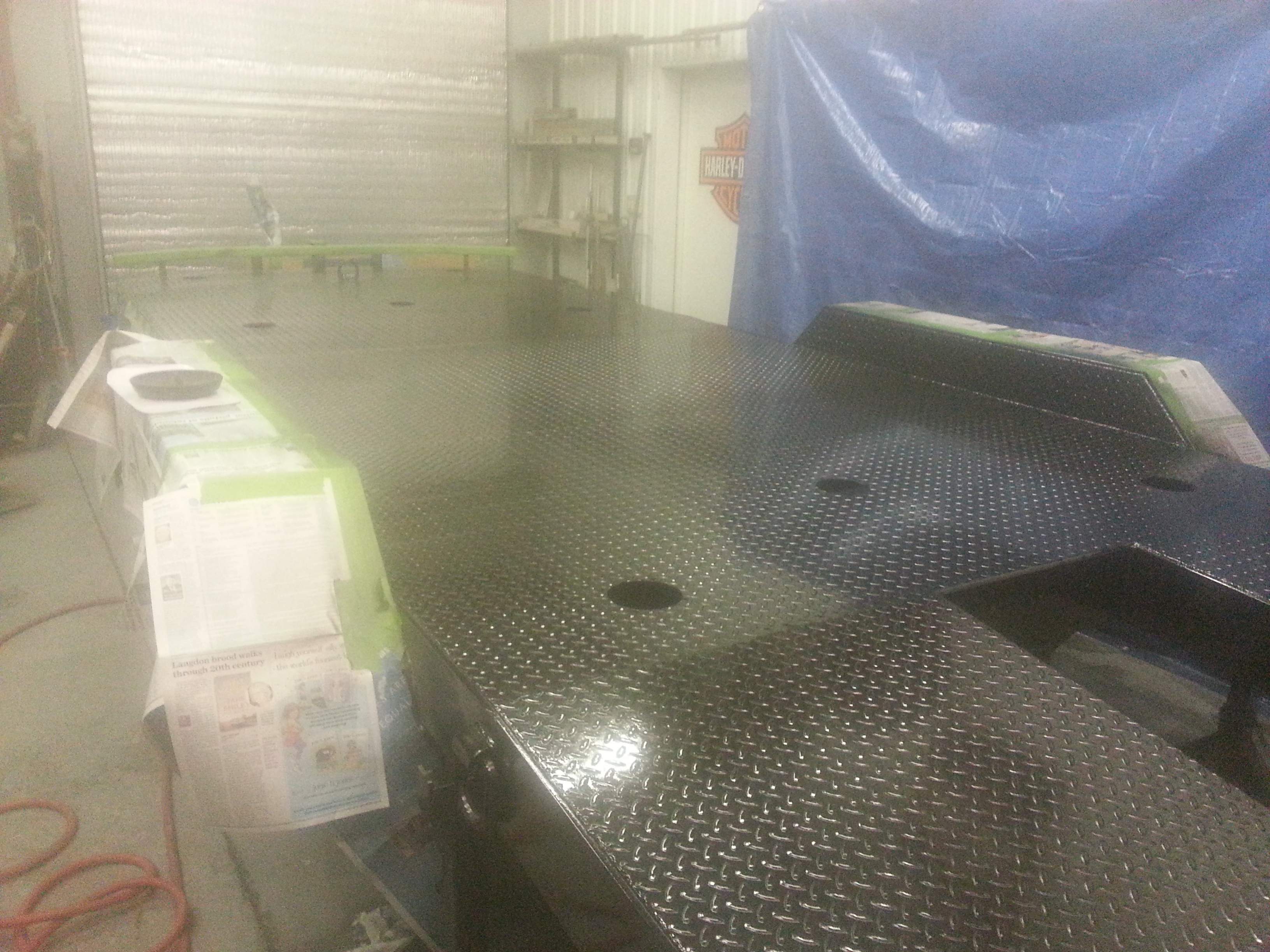

I decided to use this paint for the underside, I figured i'd waste a lot of it trying to get it in all the nooks and crannies on the bottom. I didn't want to chance getting it half painted and it getting rained on, so i'm painting it in the shop.

This is the paint I used on the top side. A buddy who has a body shop recommended it.

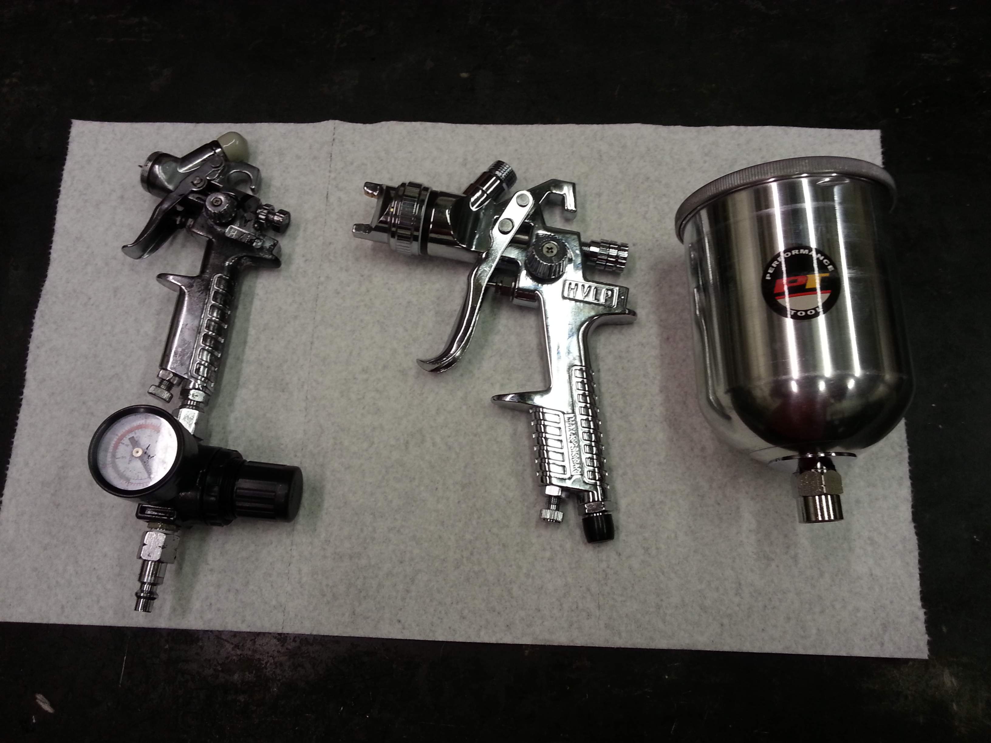

I had to buy a new paint gun, the one's I bought from Lowes were basically junk.

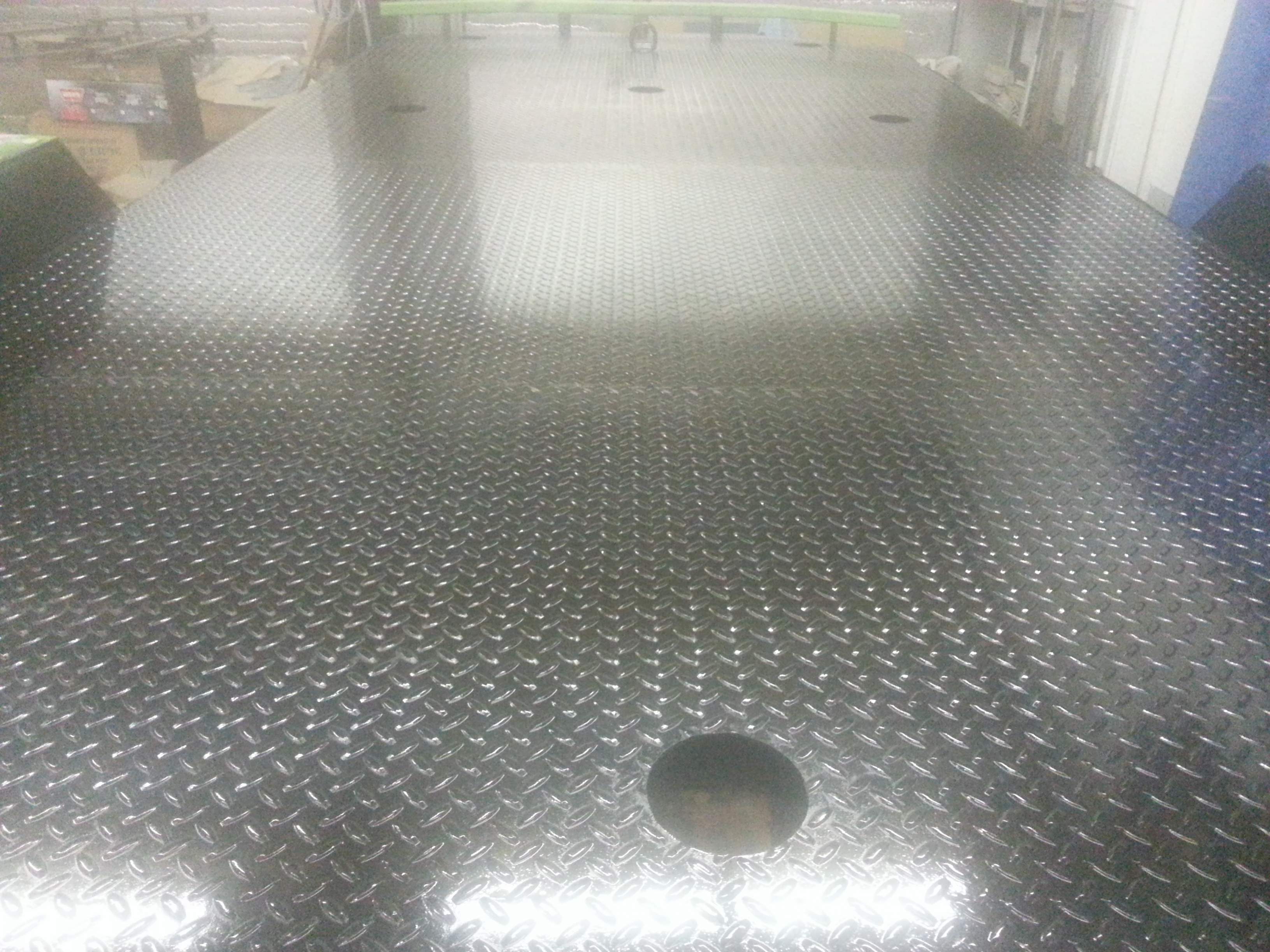

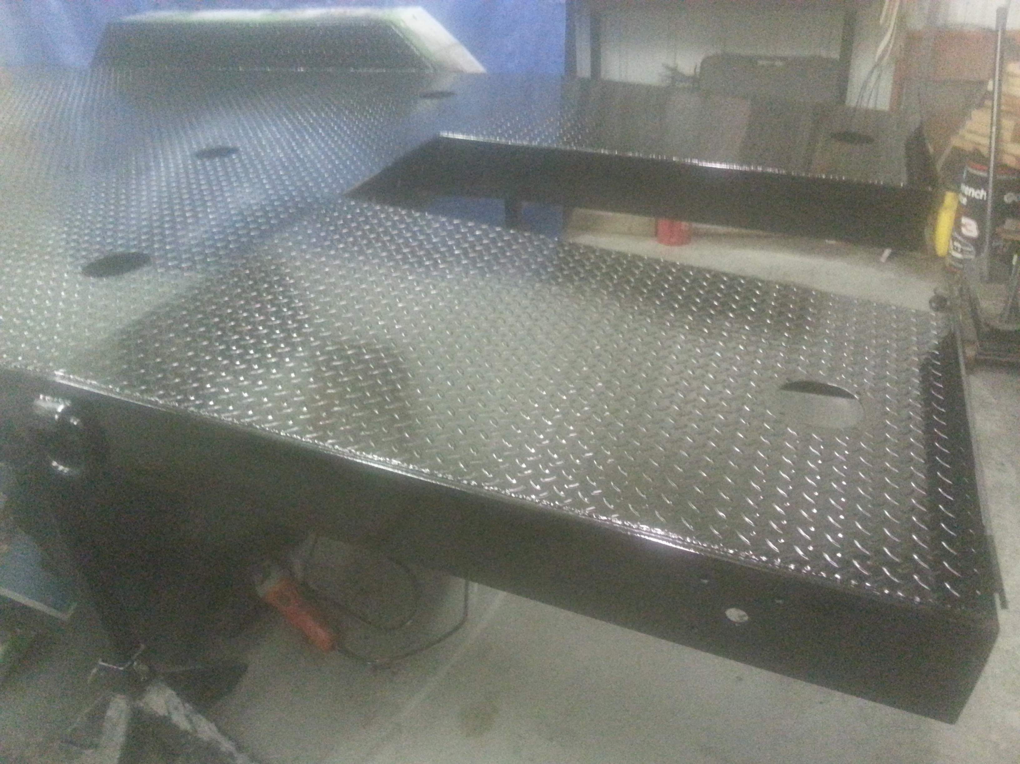

After wire brushing the entire trailer with a grinder, blowing it of, washing it with simple green, spraying on the priming etch and rinsing it off with water, letting it dry good, I started painting. I masked off the sides and fenders and with booties on to cover my boots I got right on the deck and painted the whole thing from the front to the back. After the rust coat dried, I did the same with the top coat. When the deck was dry, I masked it off and did the sides and fenders pretty much the same way I did the deck. I used a box fan to help vent the fumes outside. It worked pretty well.
