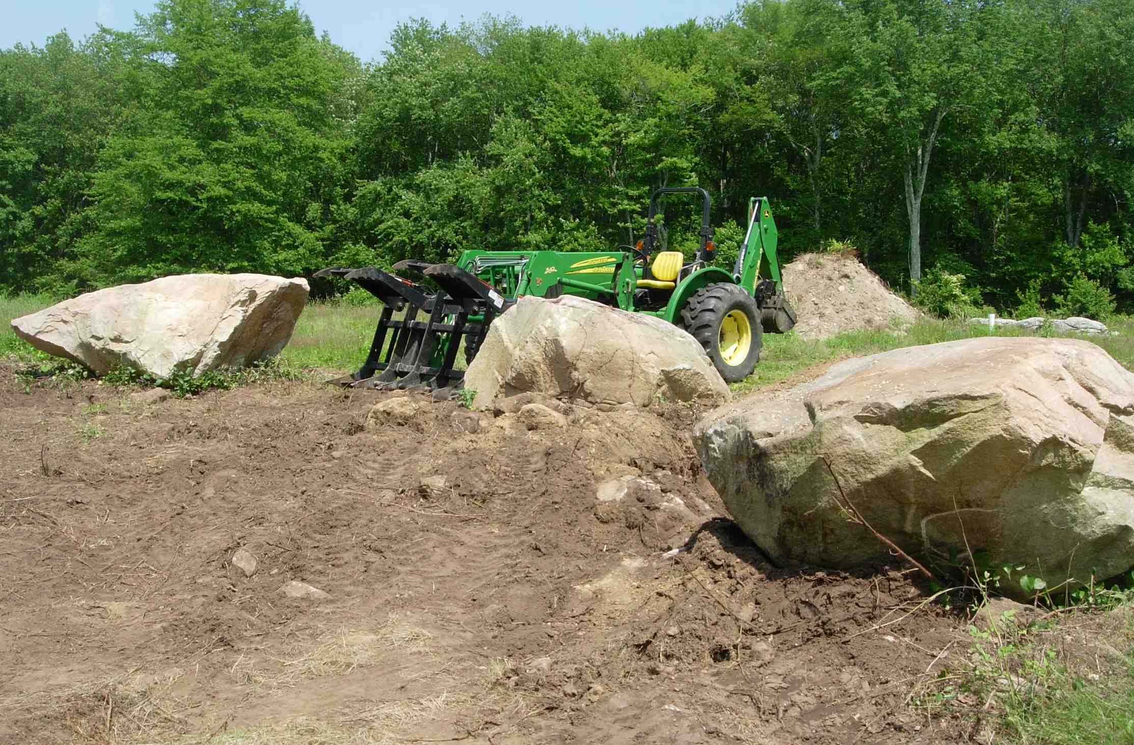

Try and use the Dexpan or similar type product.....We have had VERY good luck with it and its easy to use. Check with your local equipment rental yard for a rock drill package (towable air compressor / rock drill / 4' or 6' shaft / drill bits) they usually rent for around $150.00 per day...the dexpan type product sell for around $100-$120 per box.....Drill holes all over rock pour in material and it cracks rock.....FYI place a tarp or other cover over rock if near cars building sometimes not all holes work and the product will fire back and the dexpan material will shoot out kinda like a volcano (not dangerous just a pain to clean off a car hood)

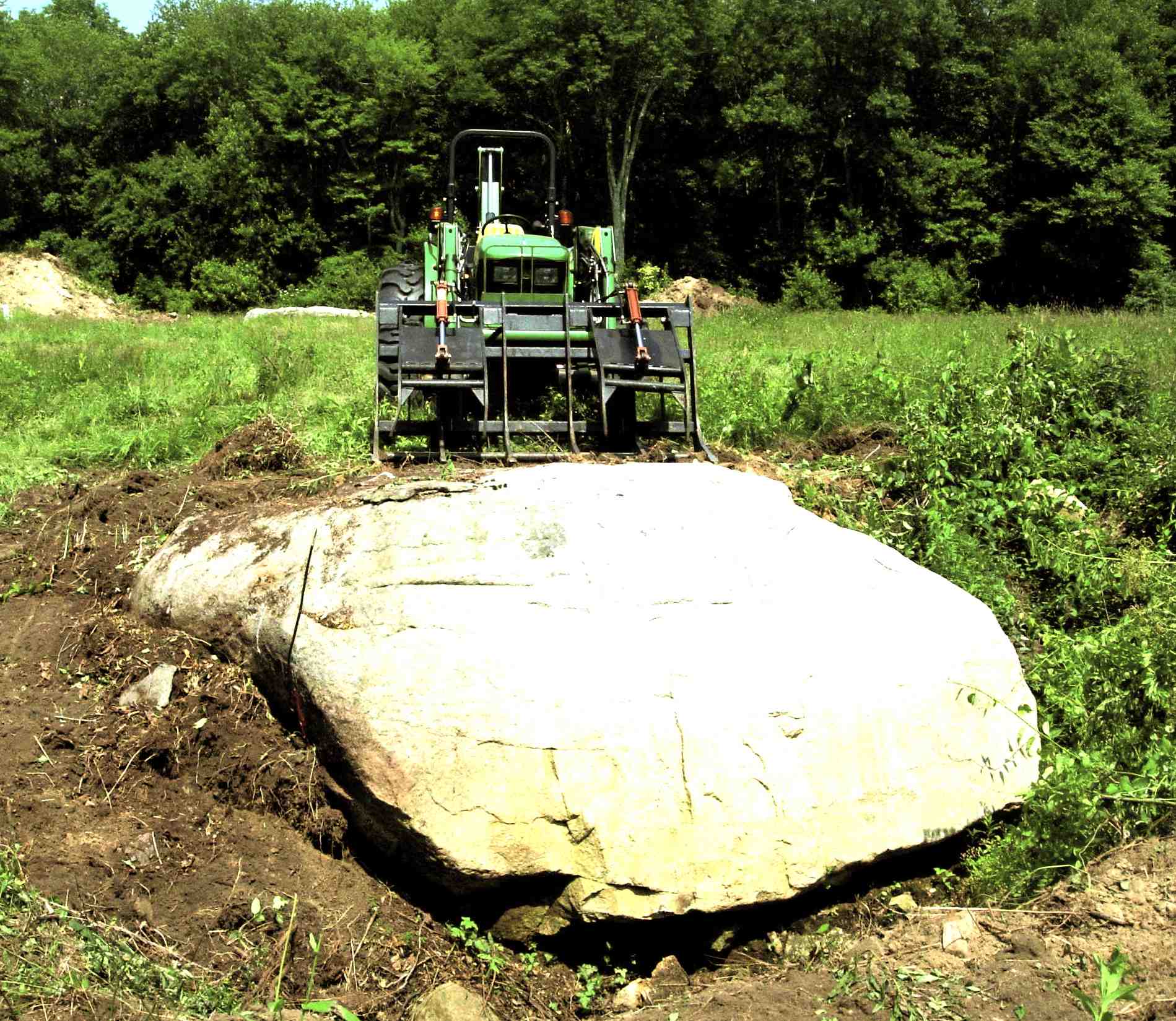

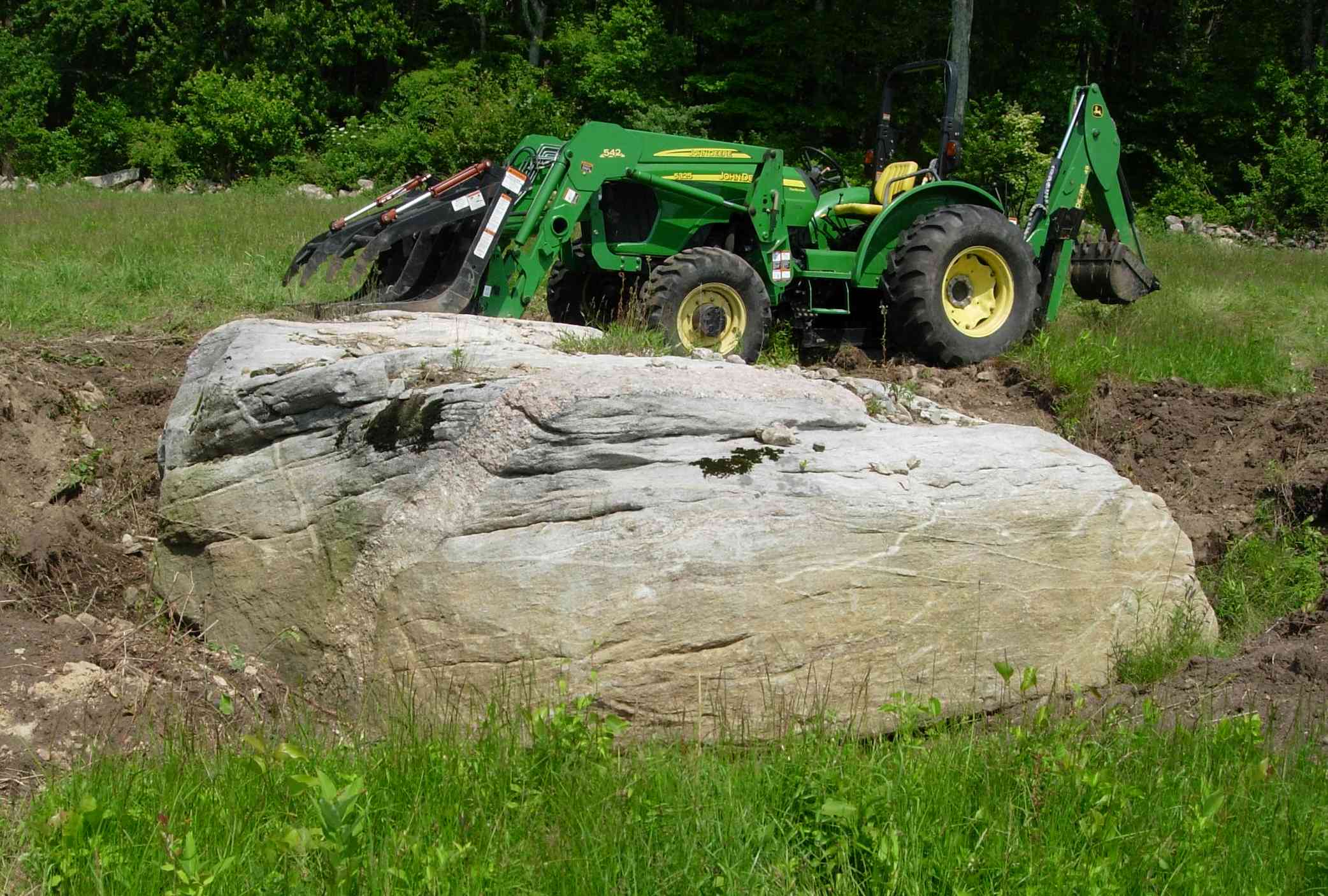

We split some rocks, rocks heck, bolders, using feathers and wedges. You can google it. We split tons of bolders to build a greenhouse.
