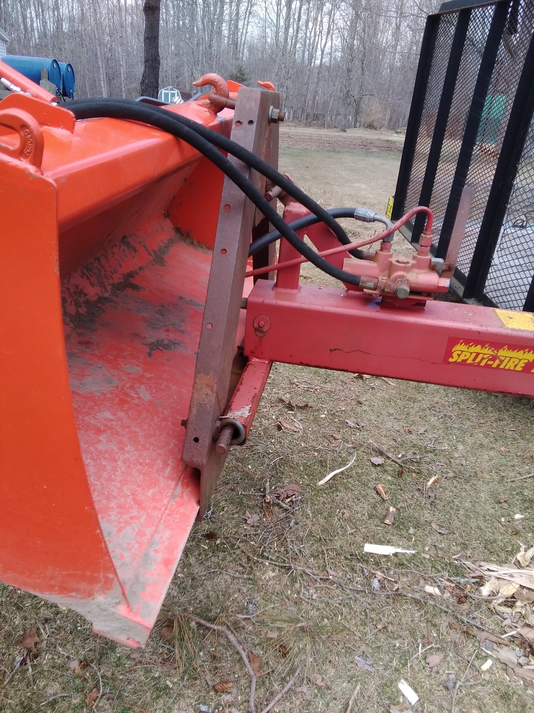

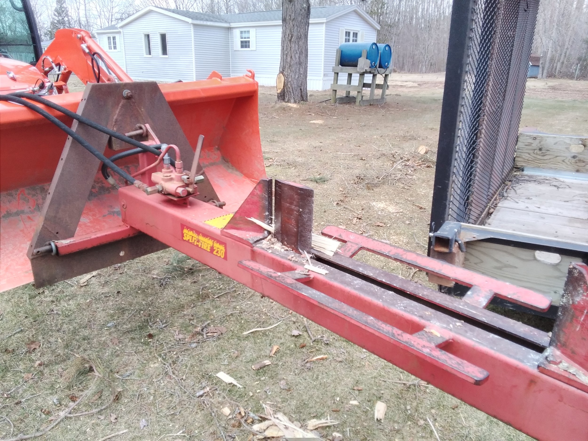

I have a Split-Fire wood splitter that I use with my LX2610. I had previously used it on a B3030 and L3540 I once had. I would often be splitting word when I had a snowblower on back, and too early to remove it. I made an "A frame" so I could hang it off either my bucket with a center hook or my snow blade with a fabricated hook made from rebar. The hydraulic lines run to the rear remotes, and I only have to unplug two blower hydraulic lines and plug in the splitter to be in business. I can have it hooked up in less than 5 minutes. The blower is off the tractor now and I have a landscape rake on the back, but will try to attach pictures showing my setup. It works well for me.

Nice, makes it easy when you've got a little splitting to do and already something on the 3pt.
I have the same 203 splitter here, it stays on it's own tractor while I'm in the splitting season.

Pretty clever (y)

My first "A Frame" was made out of 2 x 6 with plywood gussets on both sides of the joints. I used it for several years and was happy with the setup so had the metal one welded up. No regrets and it works good.
