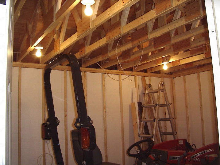

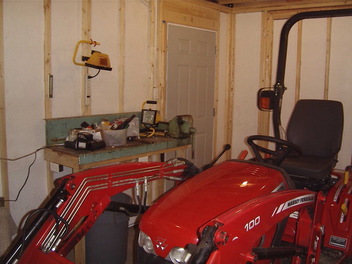

any thoughts on the best pattern to mount them? the 4 100w bulbs i already have mounted are on a roughly 1/3 1/3 1/3 pattern on each axis. the incandescents and booth lighting will be on different switched circuits. there will be 2-500w halogens above the work/mixing bench on their own circuit. compressor will be to the left of the bench as seen in the pic. gonna have to come up with some sort container to keep the compressor from kicking up a storm too i guess.

I think the spacing you have now for the light could be fine, just screw them in. 4 of them in a room that size should be all you need.
I would not have the compressor in the same room your spraying in.

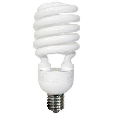

There is no such thing as too much light in a spray booth. But, a lot of strong light can create glare, which will produce unintended difficulties. If a bright light is behind the object your trying to see, then it can become more difficult to see it well.
I don't think he will need side lights in this case, with 4 giant CFL's he will have 1200 watts of light. That's a lot of light bouncing around in a small space. I have 10 of them in a 30x30 shop, and it's very well lit.

will these bulbs screw into a regular light bulb socket?
Yes, they will thread into the standard medium base porcelain sockets you have.
