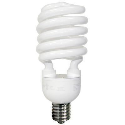

You don't have to worry about color temperature, unless you going to match colors in there.
These bulbs are available at Home Depot, make sure you buy the TCP brand. $20 gets you a bulb and a socket. $16 gets you just the bulb. They use 68 watts, but put out 300 watts of light. And they can be turned on at -20F. I hate CFL's, but these are great. No noise, no hum. The only draw back is, (1) it takes a few minute for them to reach full brightness. But, they are as bright as a 100watt bulb when you turn them on. (2) They are about 10 inches long, which can be an issue if you have a low ceiling.
