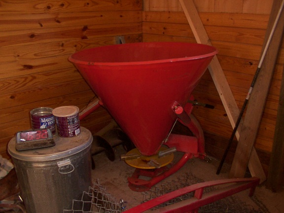

Will,
I have the afore-mentioned TSC C500 spreader. It was $350 and has worked very well for me. The spreader has a load capacity of 900 lbs and came with the agitator at no additional cost.
Here is a pic:
