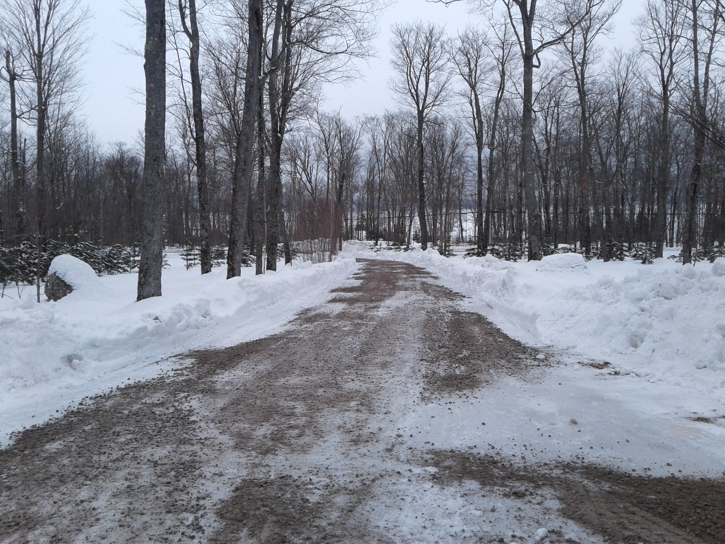

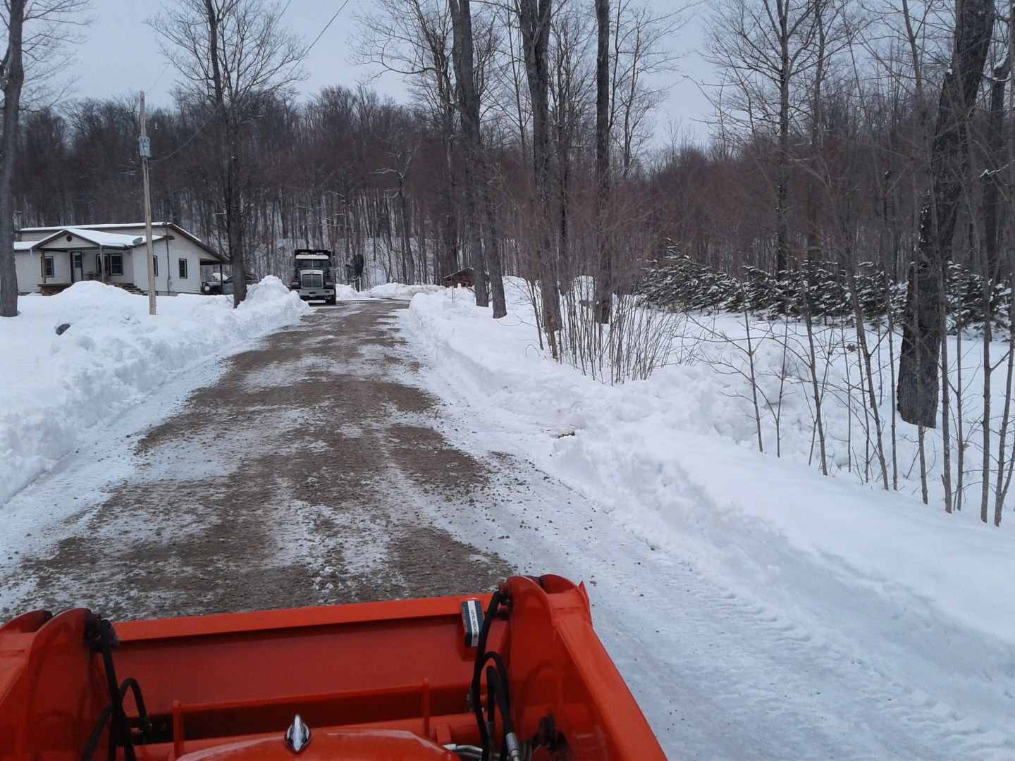

I do sometimes, like when I just had to sand my driveway. had to use 7/8's crushed gravel though, as that was my only pile that wasn't froze solid.
But normally when I am topping my bushroads I just dump piles with my bucket and use my box blade so that I can shape the road as I go.
