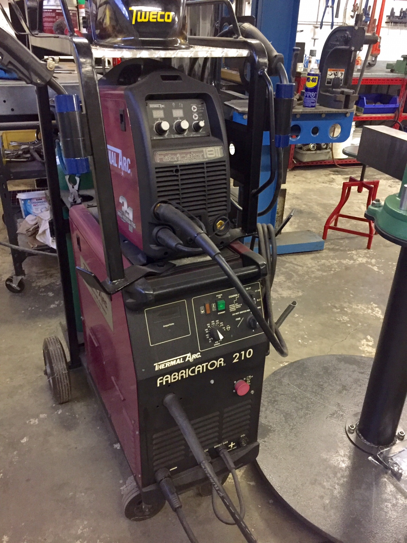

I’ve only replaced a liner once in twenty years on my Thermal Arc. ( the bottom one )
