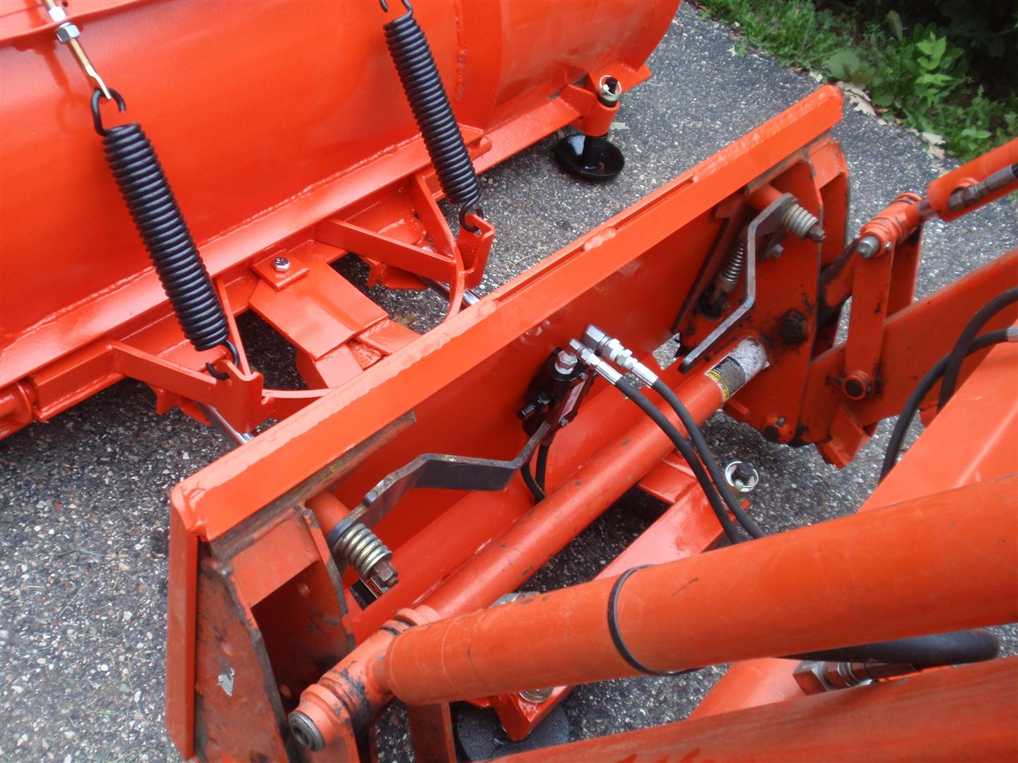

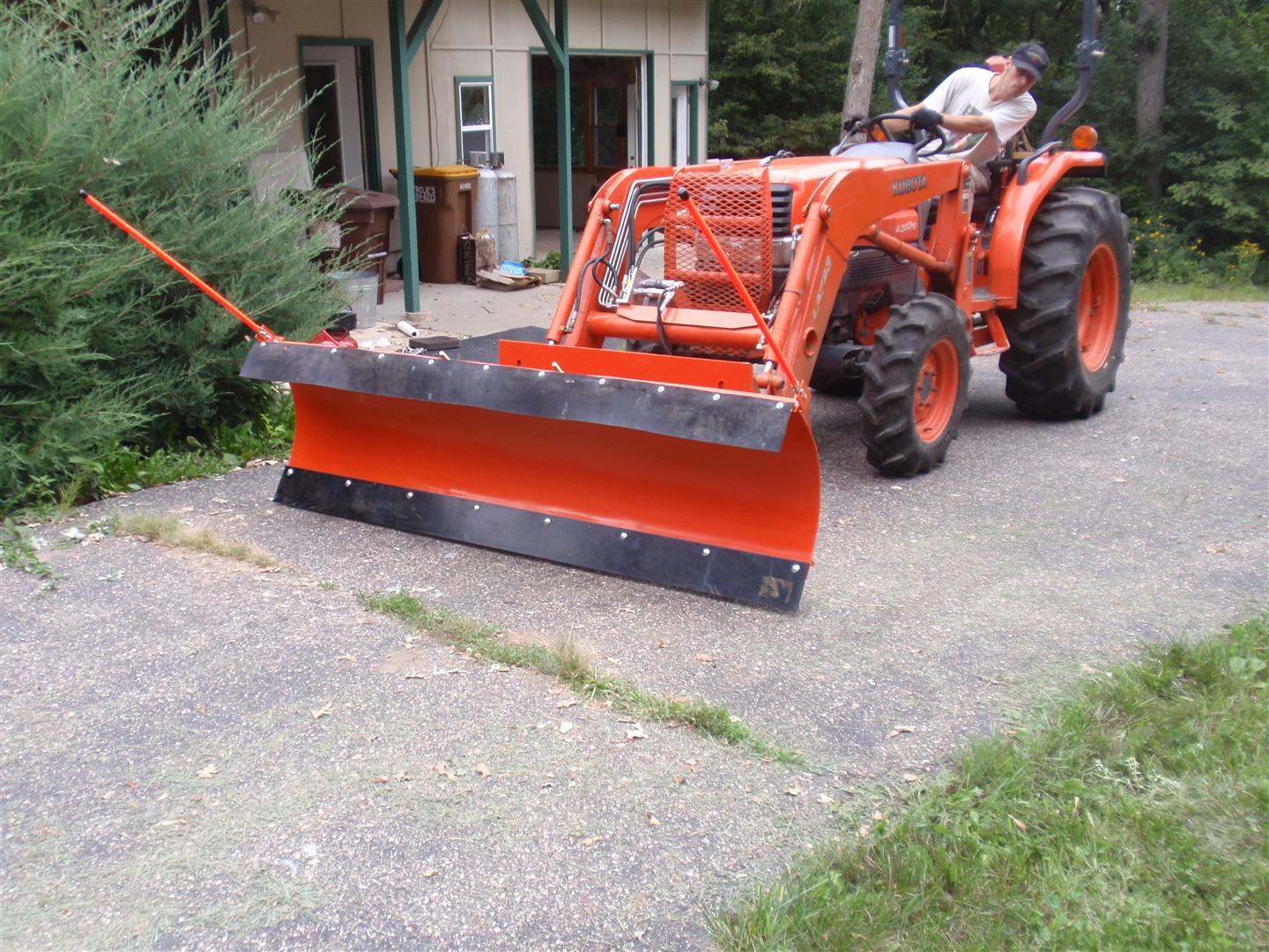

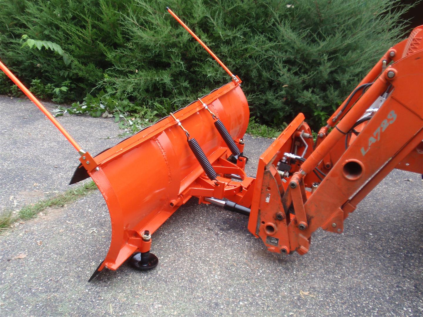

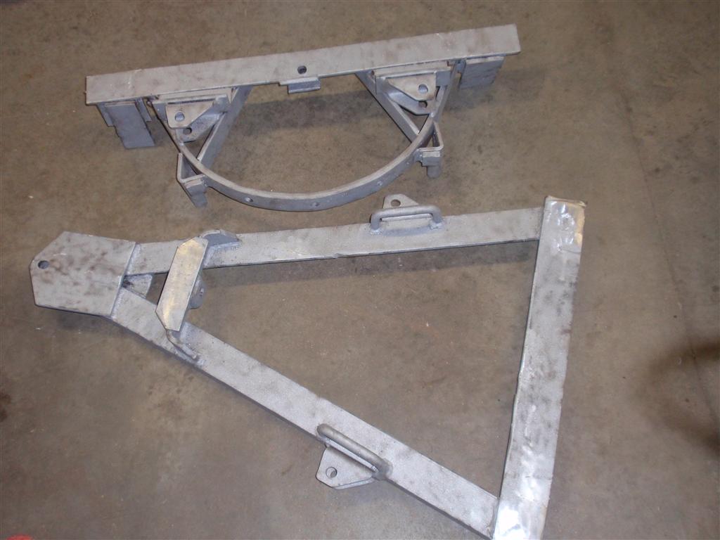

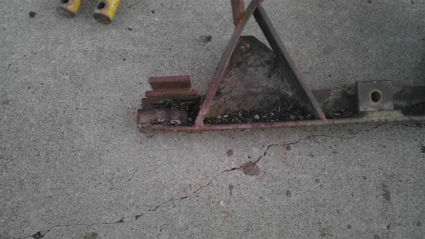

I decided to put the build all in one place, so it is easier for others to find if they want to reference it later on.
Here's what it cost me. I did well more than was absolutely necessary, but I will keep it for a lifetime, so I prefer to do it right now.

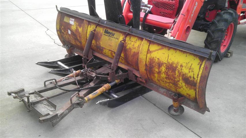

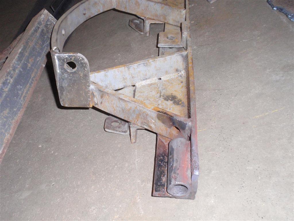

And here was the donor plow. An old rusted Meyers ST90 7.5' plow that came without the hydraulics/pump/etc, which was why it was so cheap.
