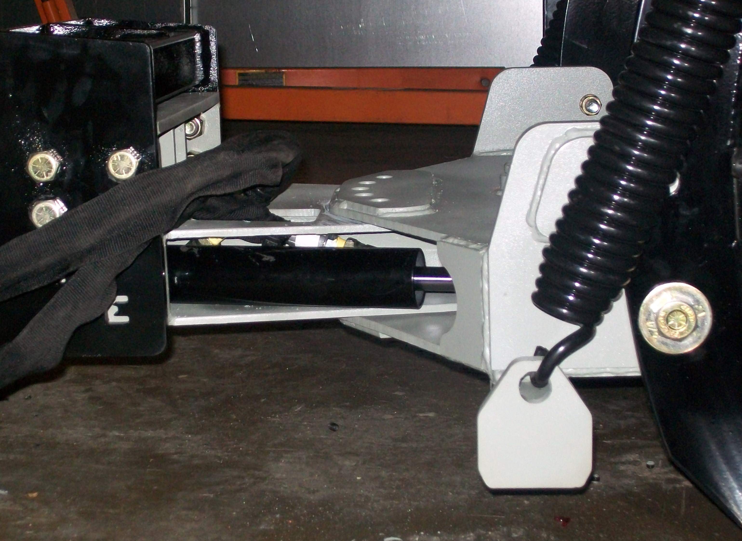

Great job, I am constantly amazed at what some people can build on here. How many hours did it take? The only thing you might want to think about is making some sort of guard for the cylinders because if you do any backblading or non paved surfaces, that could be a problem. I attached a photo from a Hound dog attachment plow to show what I mean.
For those of us who can only build bluebird houses and must purchase our attachments, getting a plow with a single top mounted hydraulic cylinder is a good idea. It keeps it out of the way and keeps the overall length of the plow as short as possible. Plus it has lateral float which I feel is important if you are plowing a crowned road/uneven surface. (I haven't seen that feature designed into any homebuilt plow yet, but I'm sure it will happen!) Again, very nice build.
