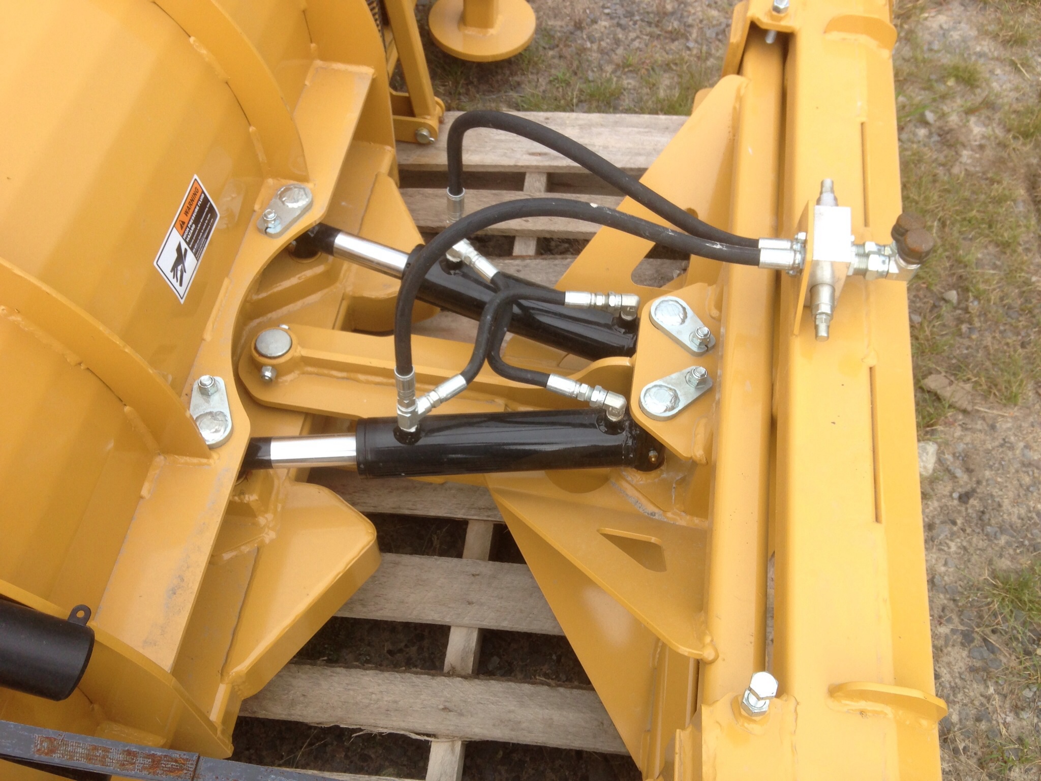

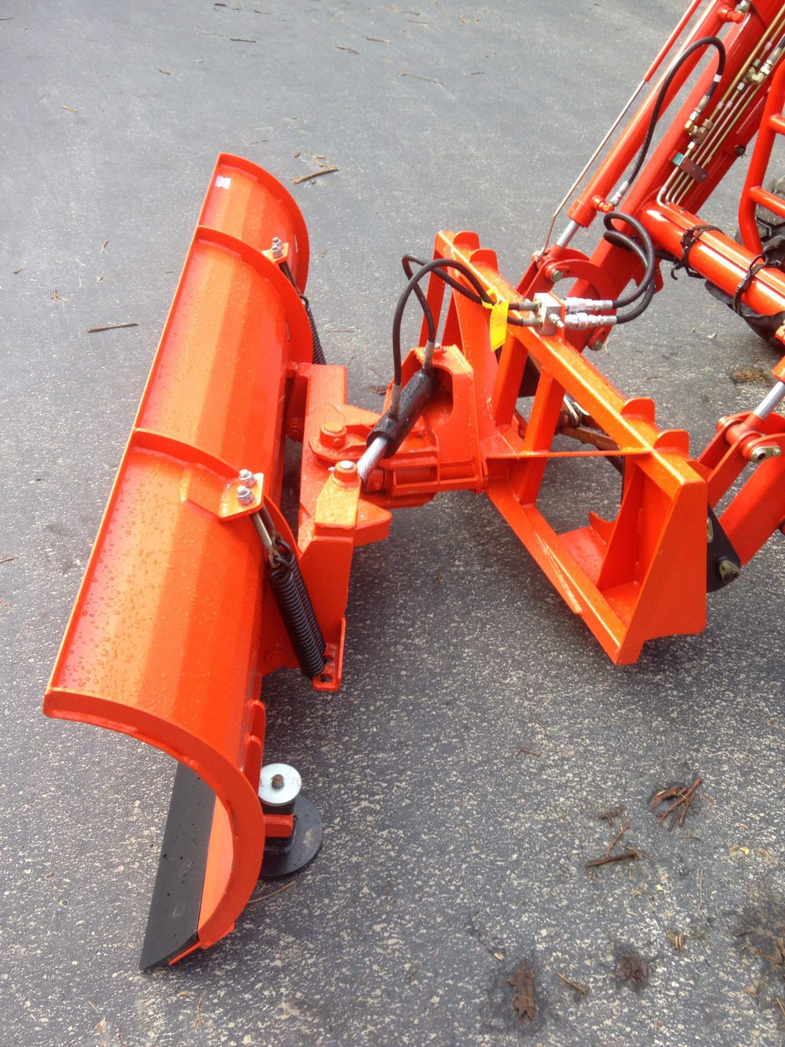

On my last two set-ups, both were diverter valves on the curl function. There is no flopping around and you still have the use of the curl function. Both had trip protection and cross-over relief valves so chance of damage has been nil. This was my last set-up on my Kioti:

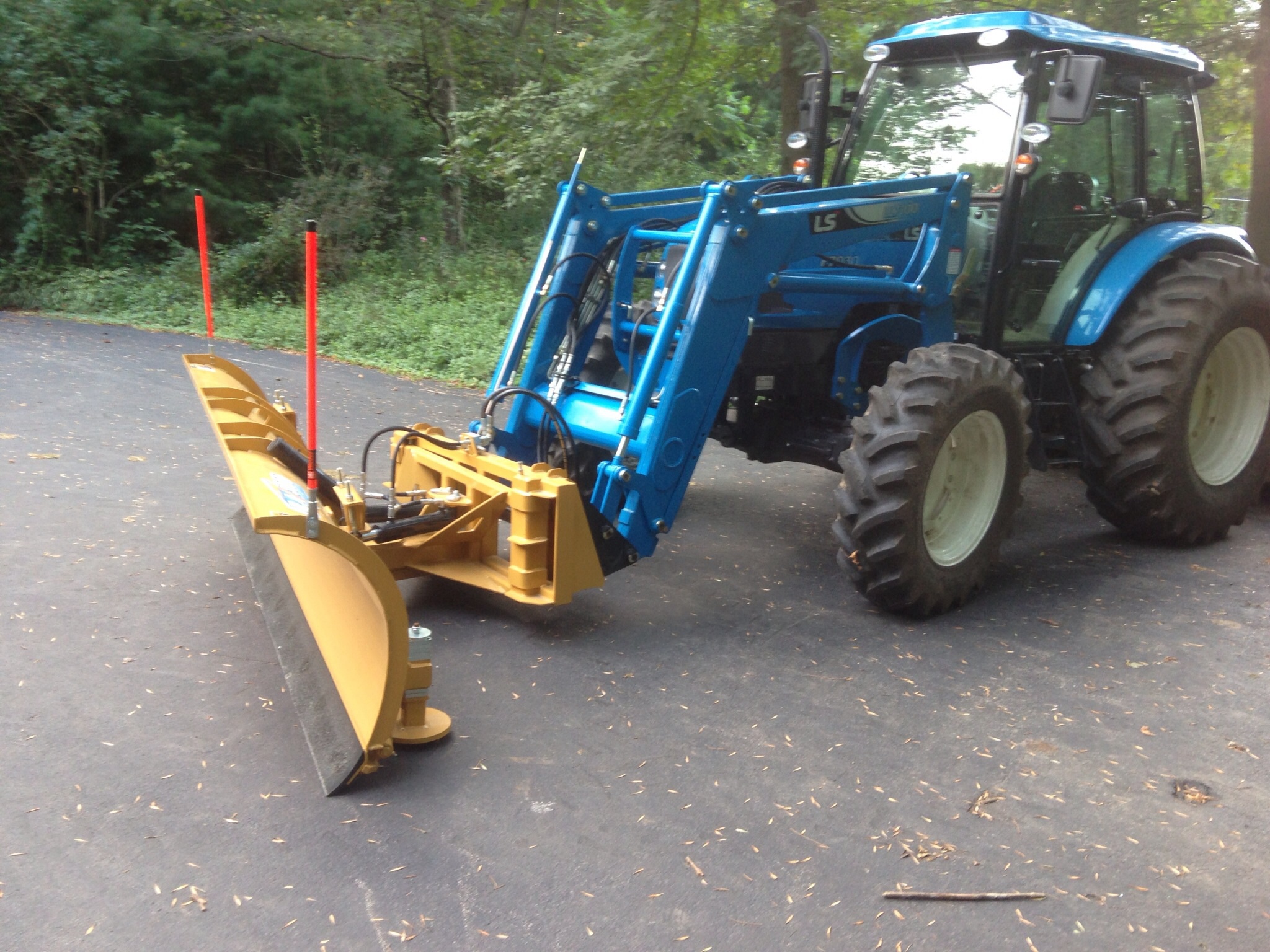

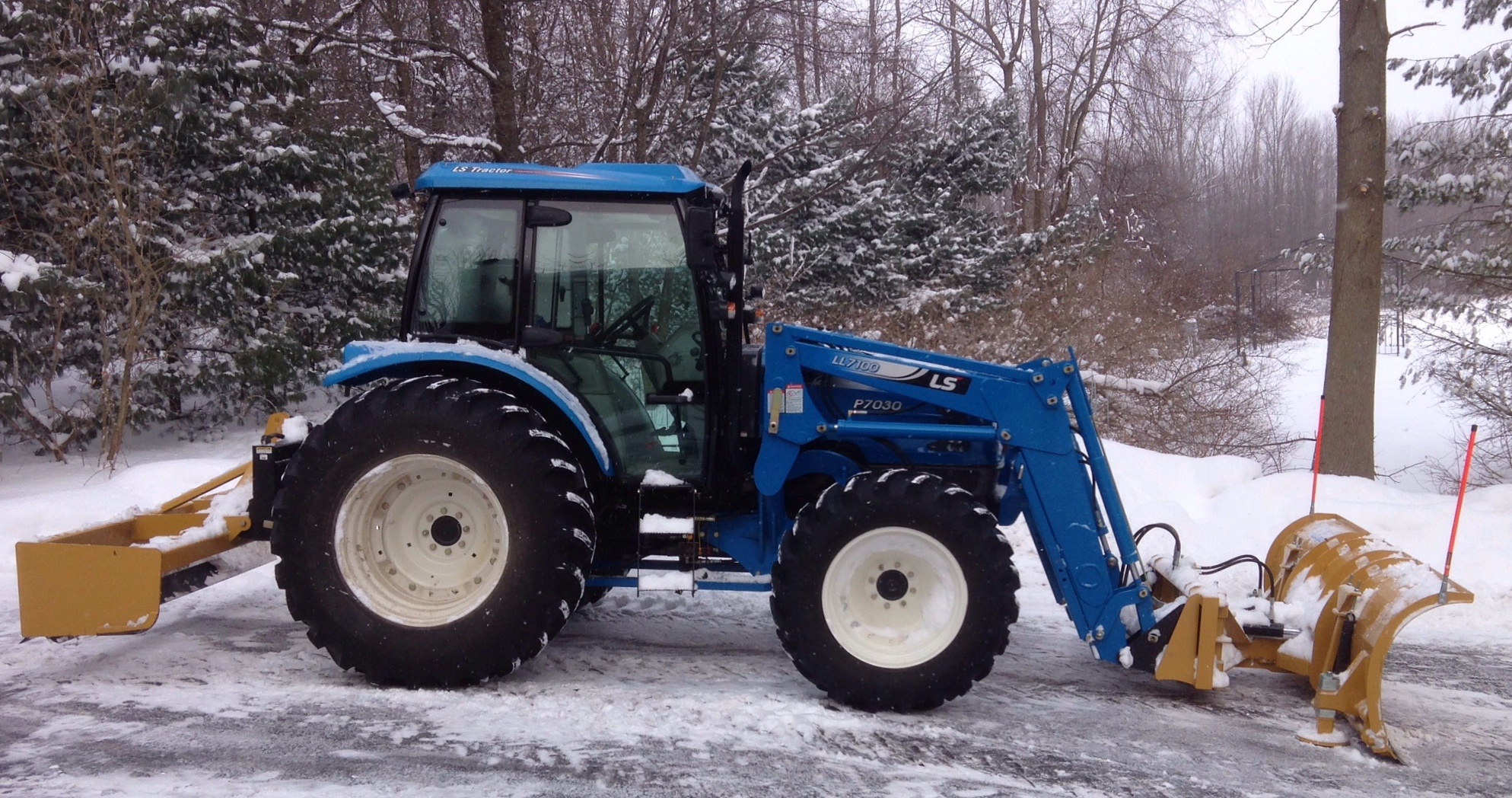

This is my current set-up on my LS.
