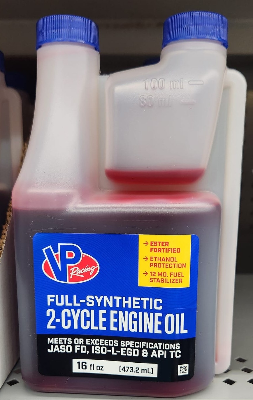

If you can find this VPracing. Buy it. Has built in measurer.
It's 100% synthetic and does what RA used to do when original formula. RA is still semi syn but changed to cheaper formula.
Seems to be everywhere here. Cheaper to buy then RA too.

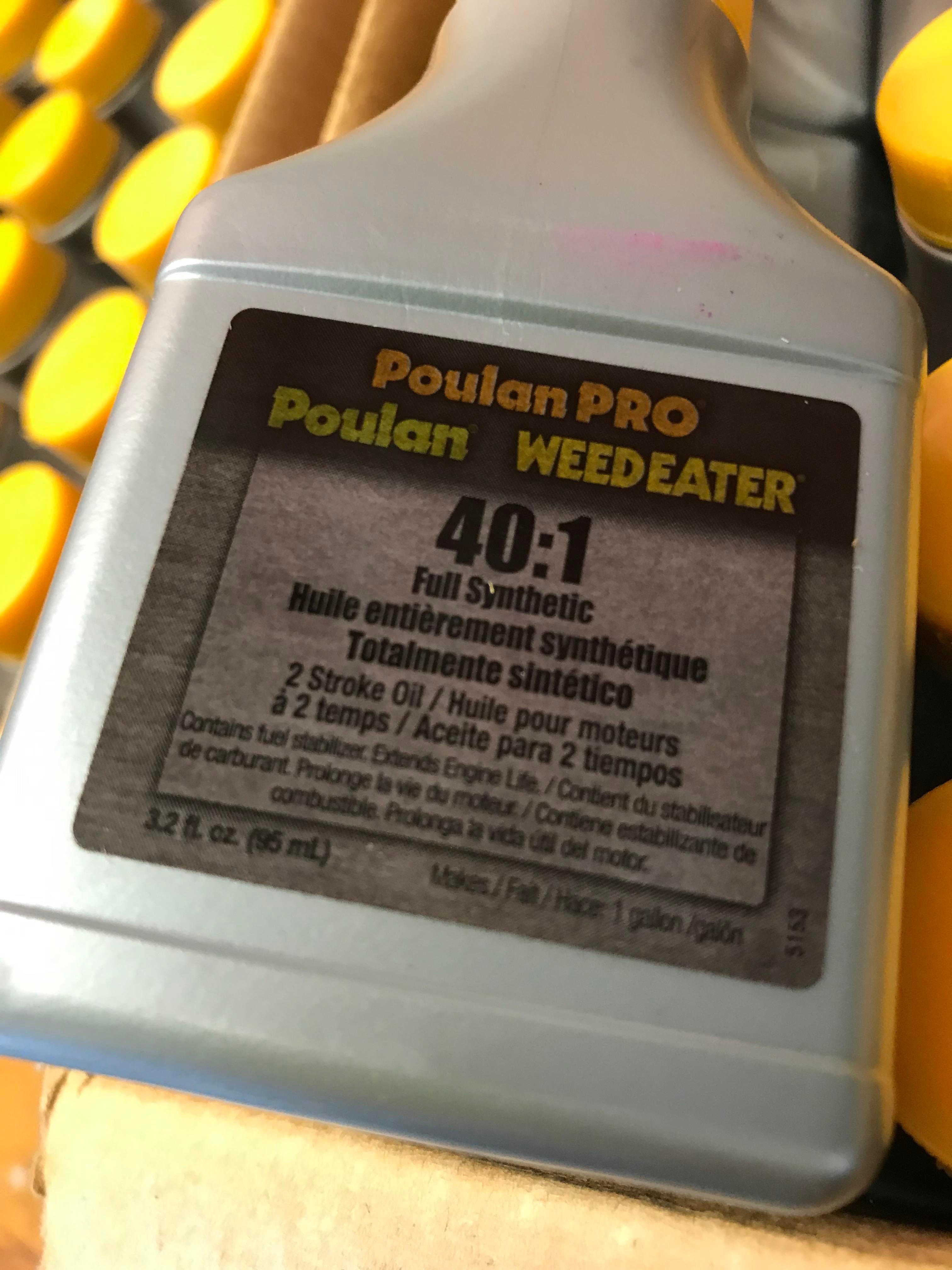

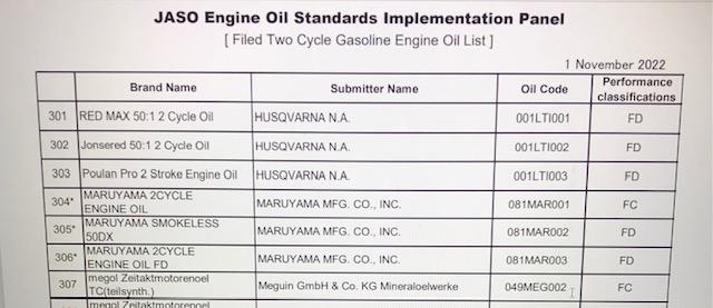

IMHO just run a good FD JASO rated oil they all have the cleaning properties in them.
JASO
FB corresponds to high lubricity performance but without any low-smoke technology.
FC meets the FB lubricity standards but also is a low-smoke lubricant.
FD corresponds to higher detergency properties than the other two grades, meets the lubricity requirements and has low smoke requirements.
Heck I sell a ton of poulan synthetic FD rated oil to local firewood cutters.
Can buy it in little bottles 40: or 50:1 still
Years back from old thread = For you Aussies the Jakmax Syn looks good. Same as Makita and Poulan Pro Synthetic. 10-30% ester.
