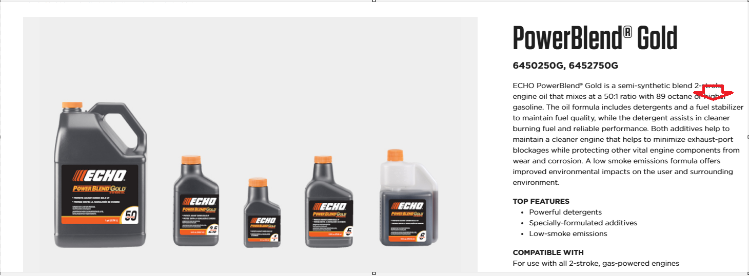

What he said, I know Echo oil has stabilizer in it or at least it did last time I checked which I'll have to do now :) . I use stabilizer in all my gas powered equipment.
Just checked, it does:

May want to check the oil mix bottle. Some 2 stroke mix oils already contain a fuel stabilizer
It seems that all the name-brand 2-stroke oils have it, these days.
