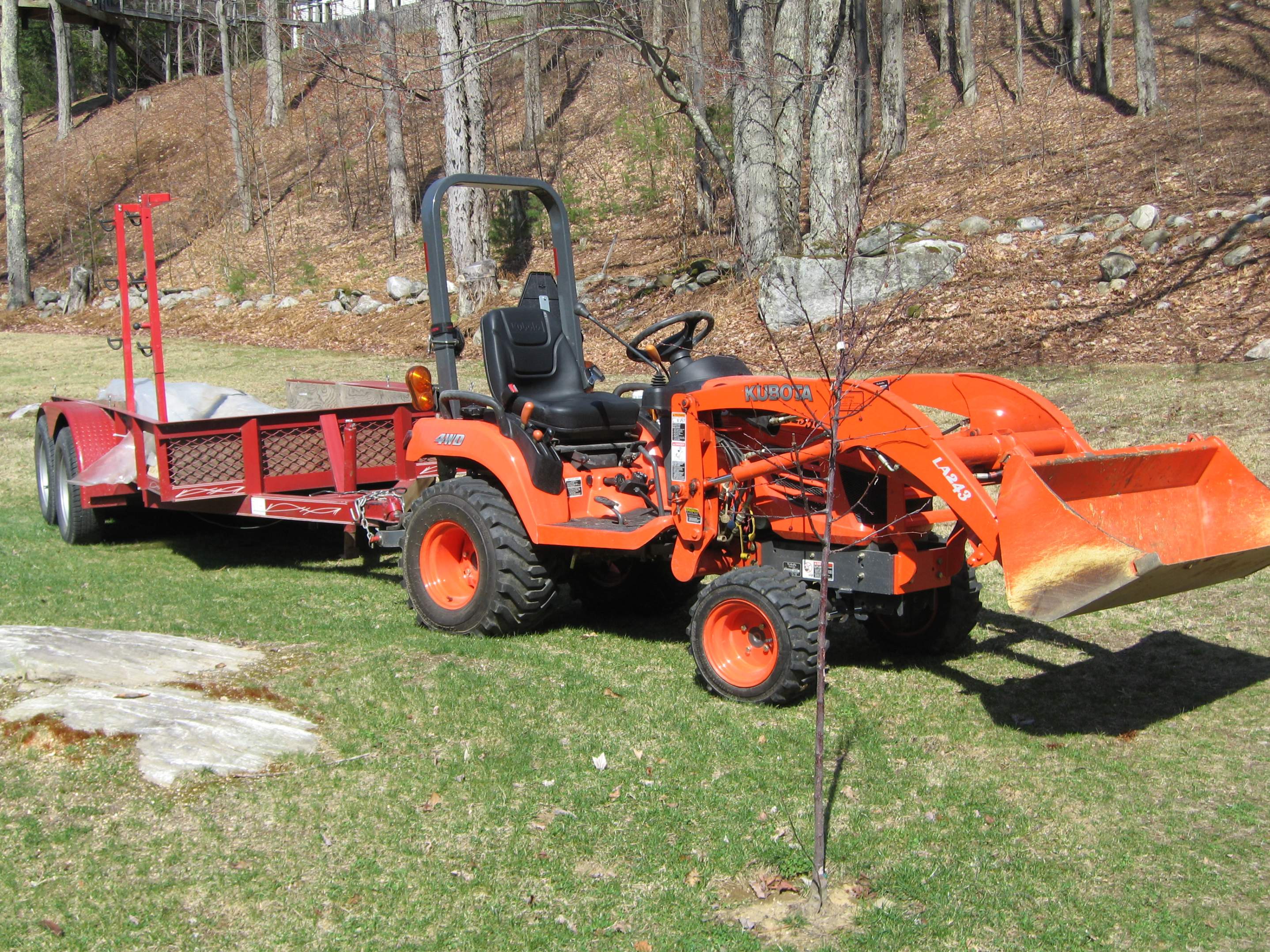

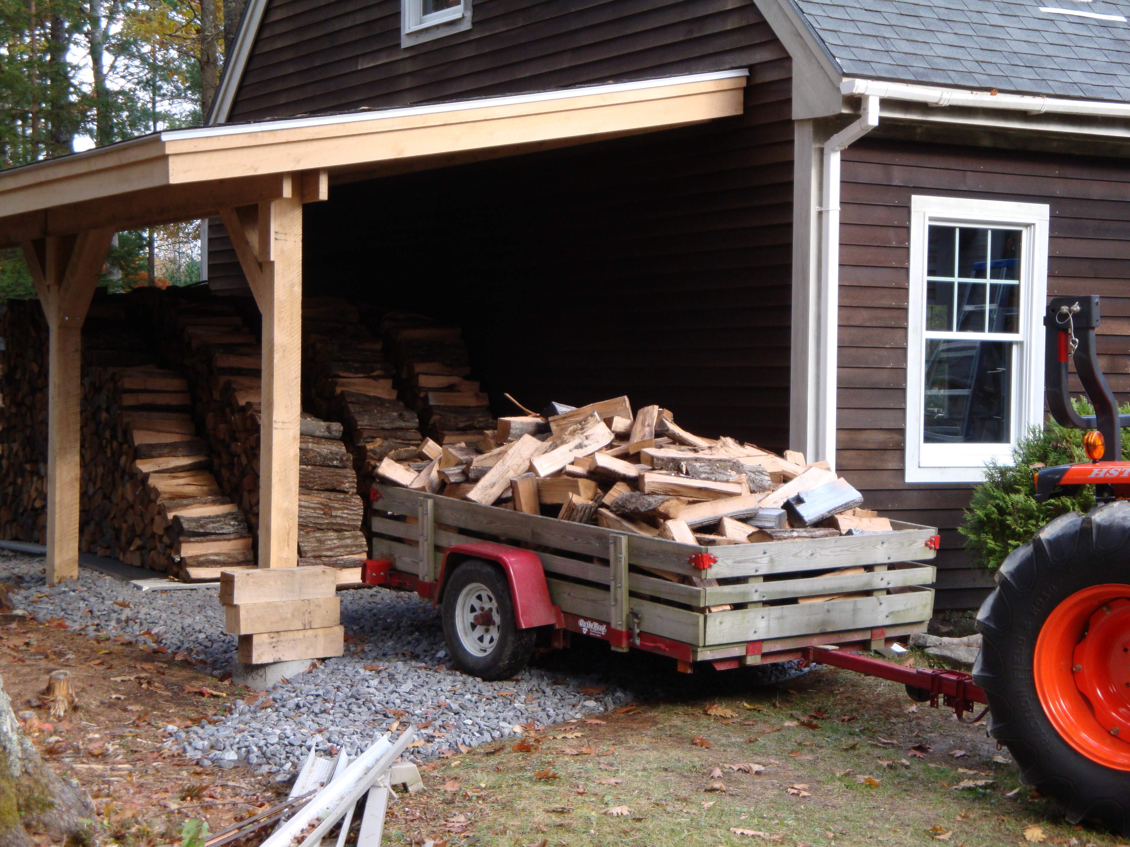

/ Stabilizing Cross drawbar for trailer #5
I have the 2" receiver attachment for my 3 point. I would tow a full load of mulch around with my BX easily on my 12' tandem trailer. I leave it on all summer and just put the ball in when I need the trailer. Just use common sense with your loads and on hills.

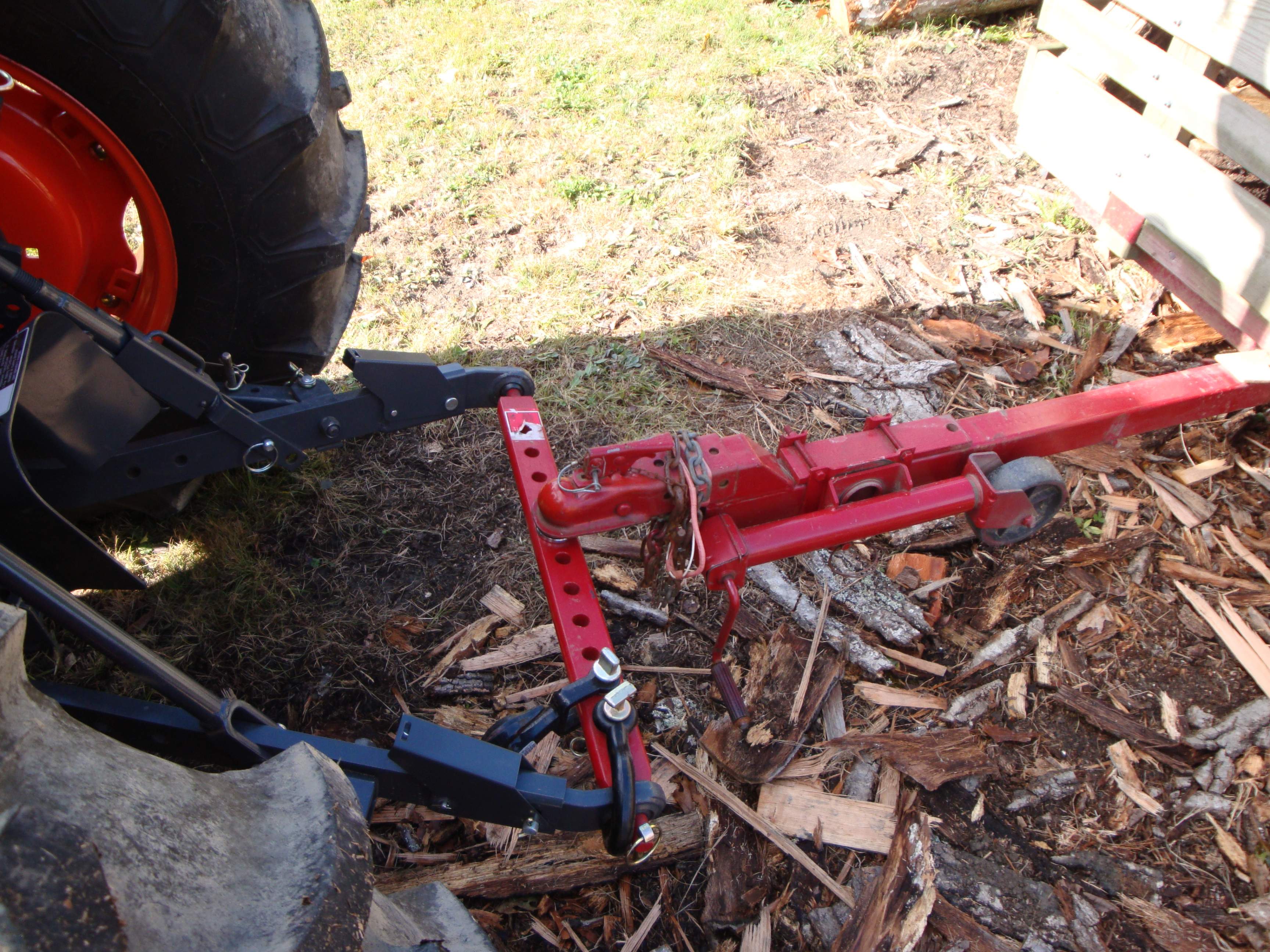

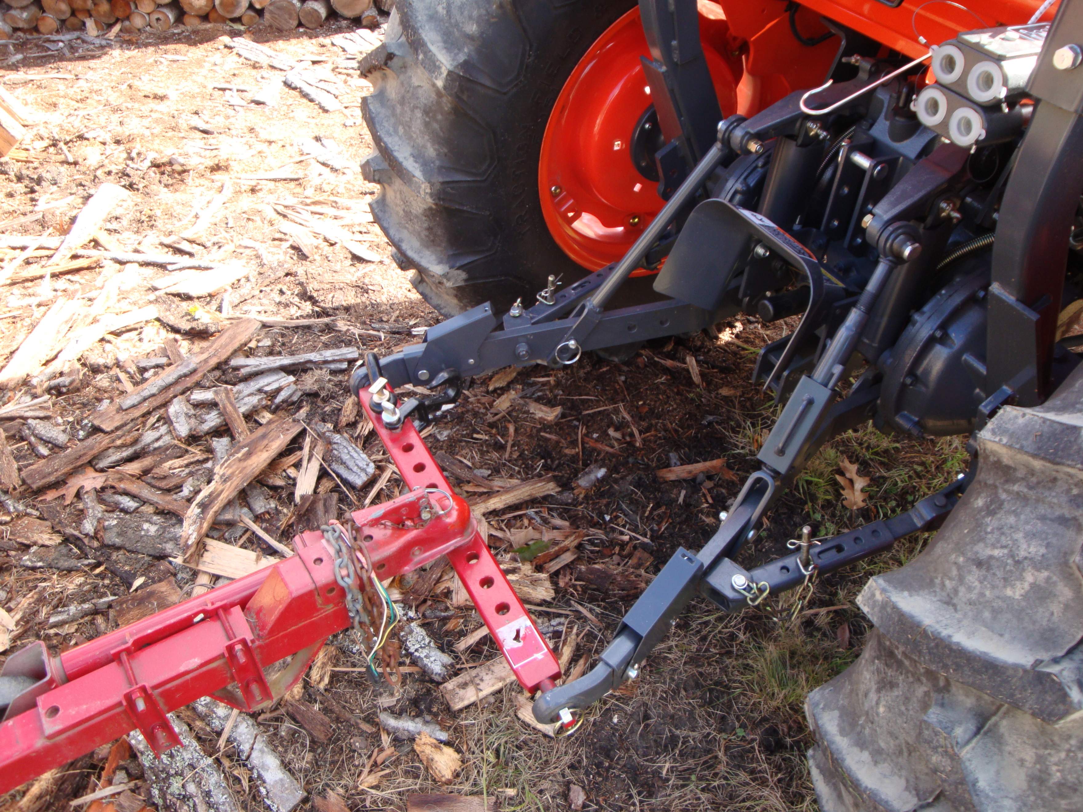

Here's what I did. Just have to make sure you have adequate tongue weight for the concerns already given.
