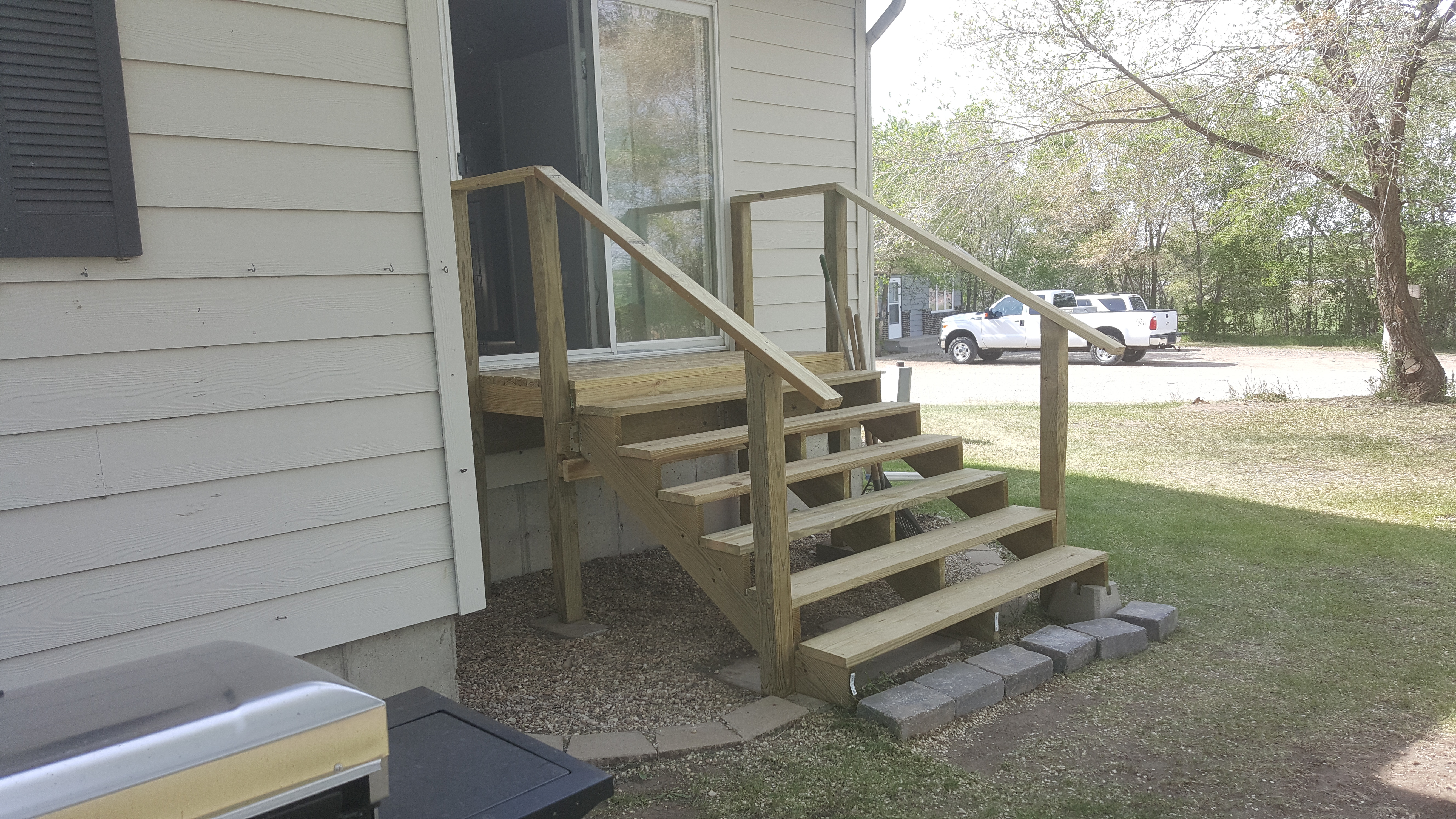

Just tore off old steps and built new mini landing and steps out of pressure treated wood this past weekend. We picked up our lumber at Lowe's, and it was so wet, it left moisture behind on the concrete shop floor after laying it there and moving it around. Wood was almost dripping wet. Don't know how "dry" your lumber was, but on ours, I won't be able to treat it with any finish until it dries out.
I think I'm just going to let it naturally age anyway.
Still have some dirt work to do at the bottom...
