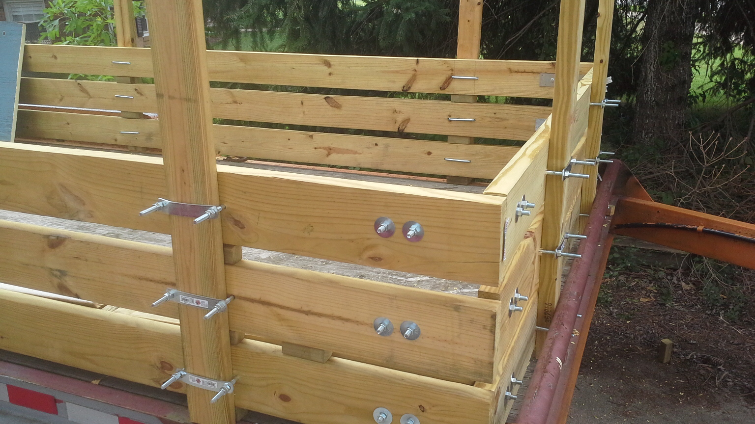

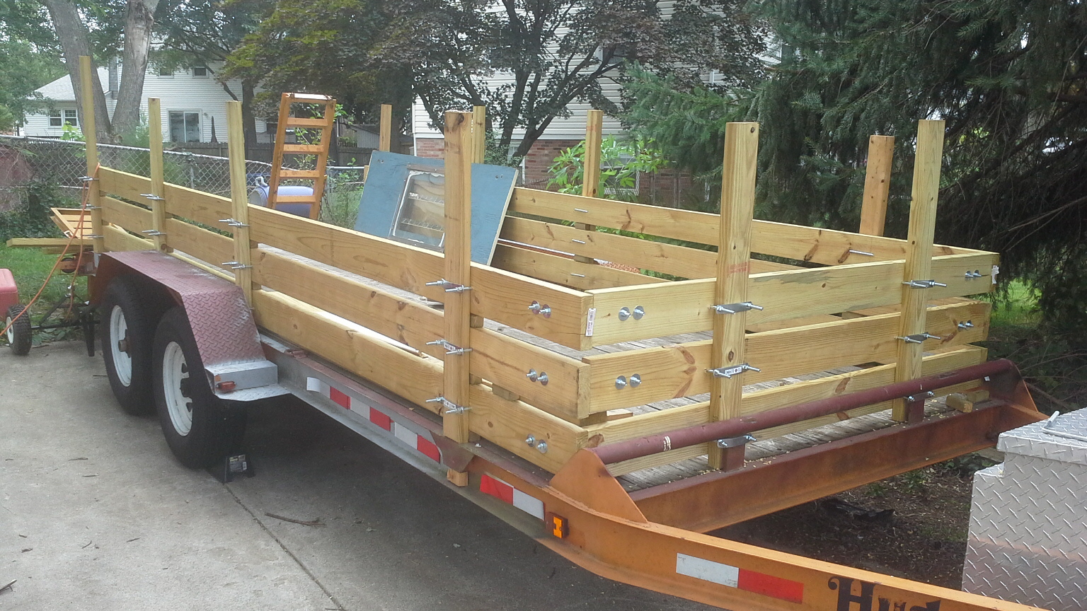

I found two very sound, solid 2"x4"x8' s made of Douglas fir that I made my stakes from. View attachment 413970 They have lasted 4 years in my stake pockets.
This is the 10 ton farm wagon I built four years ago.
