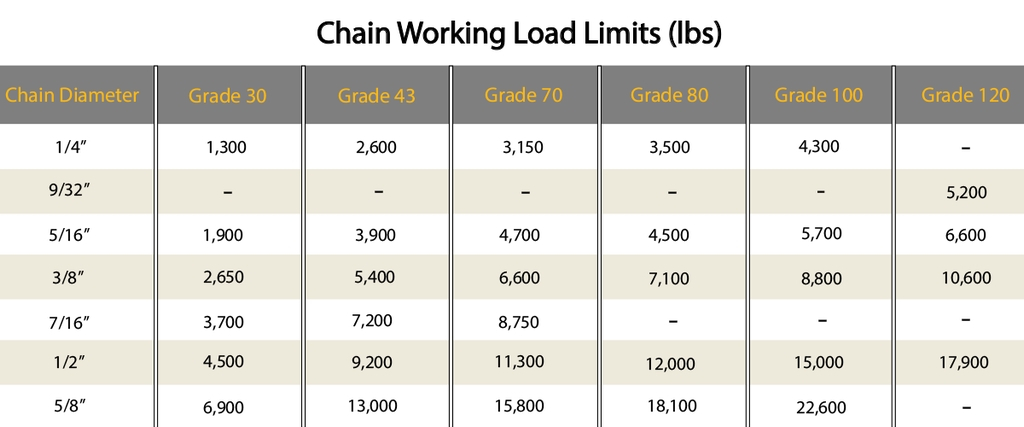

Chain grades have been around as long as I remember. If it's zinc plated, it's probably Grade 30. In which case I wouldn't use it to pull more than a riding lawn mower. ;) Here's a chart.

I know the weights for the grades and sizes. Just wondering when chain markings began.
