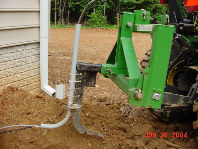

/ Standard Size for a Toolbar? #3

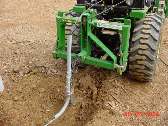

My only "toolbar" is a receiver hitch...built with 2x2x3/16" tubing and 2x3/8" flat stock.
