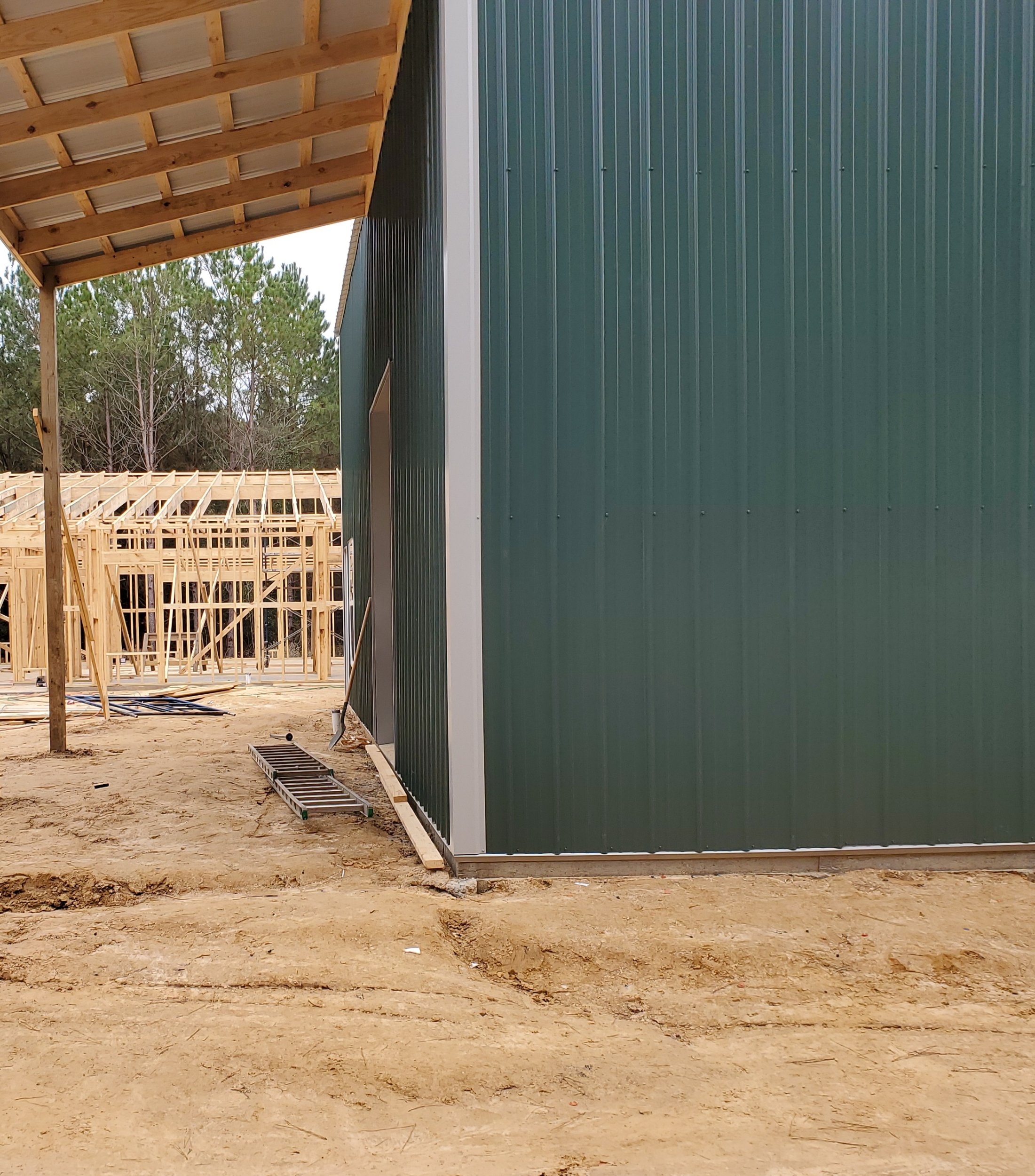

Now I need to drop about $100 for ethernet adapter and either a pole or wall mount. Roofs are metal and none of the typical adapters will work. I'm considering trying on one of the posts of my lean-to. The pole mount is probably too short to help much. This is an old picture, but that far post is north. About 14' high. Thoughts?
I would start by getting up the ladder at the eave with your phone and checking first. (I know, I know, broken record. But really, it is your friend.)
I used an eave mount Amazon.com
and it has worked well for me. I go to a fair amount of effort not to puncture a metal wall. Sealing metal is such an issue.
The Starlink Ethernet adapter is straightforward to set up, just be very nice to all of the cables. No sharp bends and no pulling on them. Gentle is the keyword here.
Remember you probably want Starlink on the southern end of your space/roof to give it the best view of the Northern sky.
All the best,
Peter
