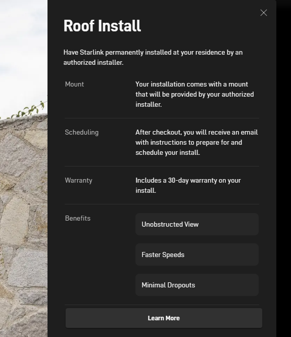

According to the website they send someone out to install the system now. So I'm not sure if they will do the arm off the soffit, but that would be my preference. There should not be any problem with obstacles, especially if they will mount it on the upper soffit. It's $80 per month for the "Residential Lite" plan. It shows to be 80-200 MBPS

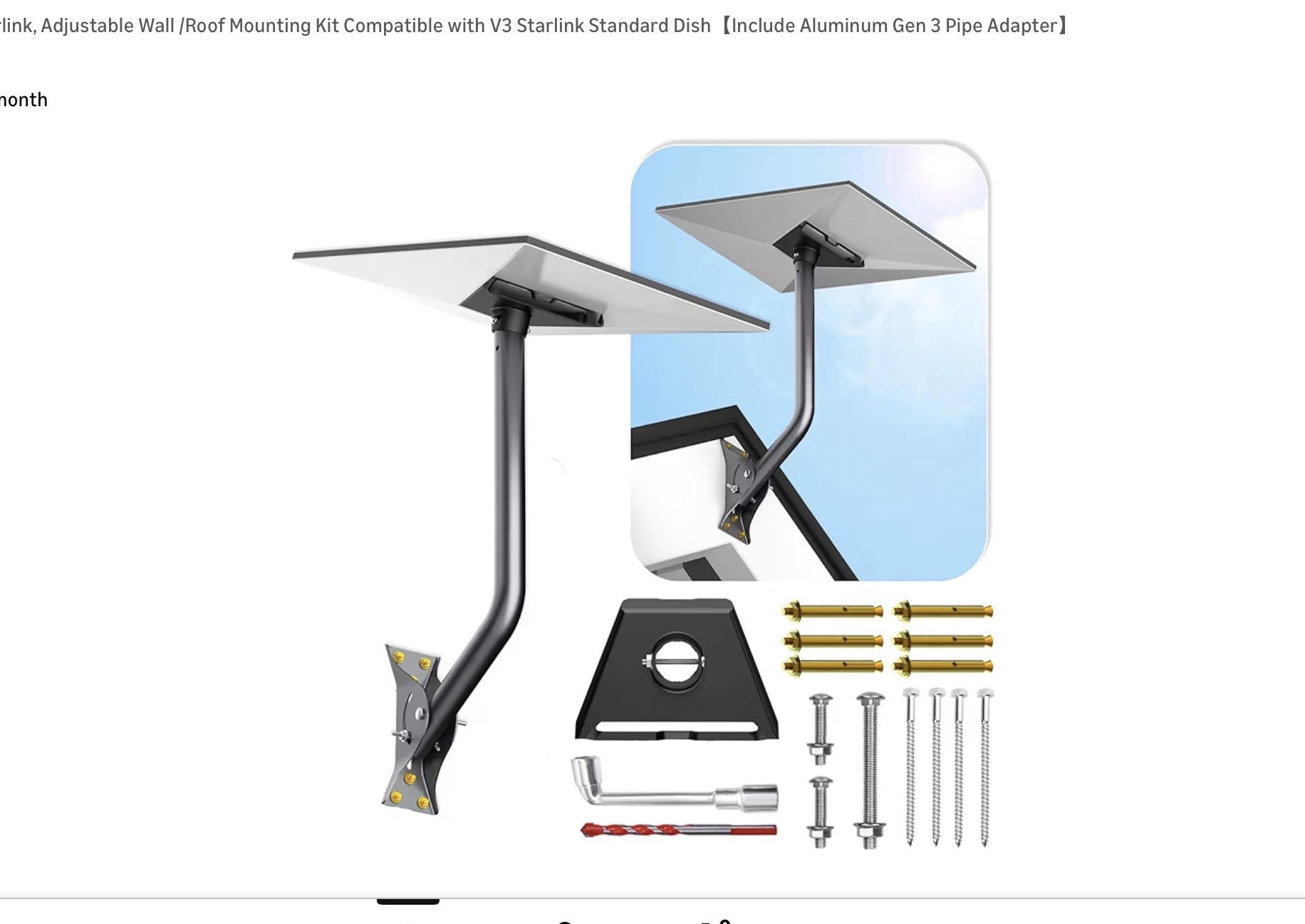

There are a ton of soffit and rafter mounting options out there. Have a look on Amazon, or any of the antenna retailers. I used this one on a rafter;
Amazon.com
Works great. 0% obstruction.

Are you sure that is actually Starlink and not some 3rd party reseller/installer you're looking at? Starlink itself doesn't do installations.
As others have said, there are TONS of install options. As long as you have a clear view of the sky you can install it however you want/need. On a pole, on the roof, with a J-bracket under-eave mount, sitting on the ground, on a tripod, whatever. Obviously you'll need to deal with power and wire runs however you choose.

Yep this is included.

Starlink offered free installation a while back in this market. They may offer this in other areas at times. My FREE install never came to be, multiple scheduled install (they were to provide mount and cabling), all were no show. Got credit from Starlink (free month) and that made be buy my own supplies. Yeah I'm cheap and wanted some help locating the best spot, oh well.

I did my own install using a 10' length of rigid electrical conduit (RMC) with the bottom in a 2' deep post hole with a few bags of concrete mix. At the top I used a salvaged bracket from one of the several past experiences of a satellite internet providers that's identical to the one in @grsthegreat post above. That bracket with it's 3' long stem works great because I can loosen the slotted clamp and pivot that bracket down for mounting or future service to Dishy then rotate it back up to vertical and clamp it. It doesn't wobble or gyrate in the wind and is high enough to keep stuff out of harm's way. The longest part of the install was waiting for the concrete to set.
