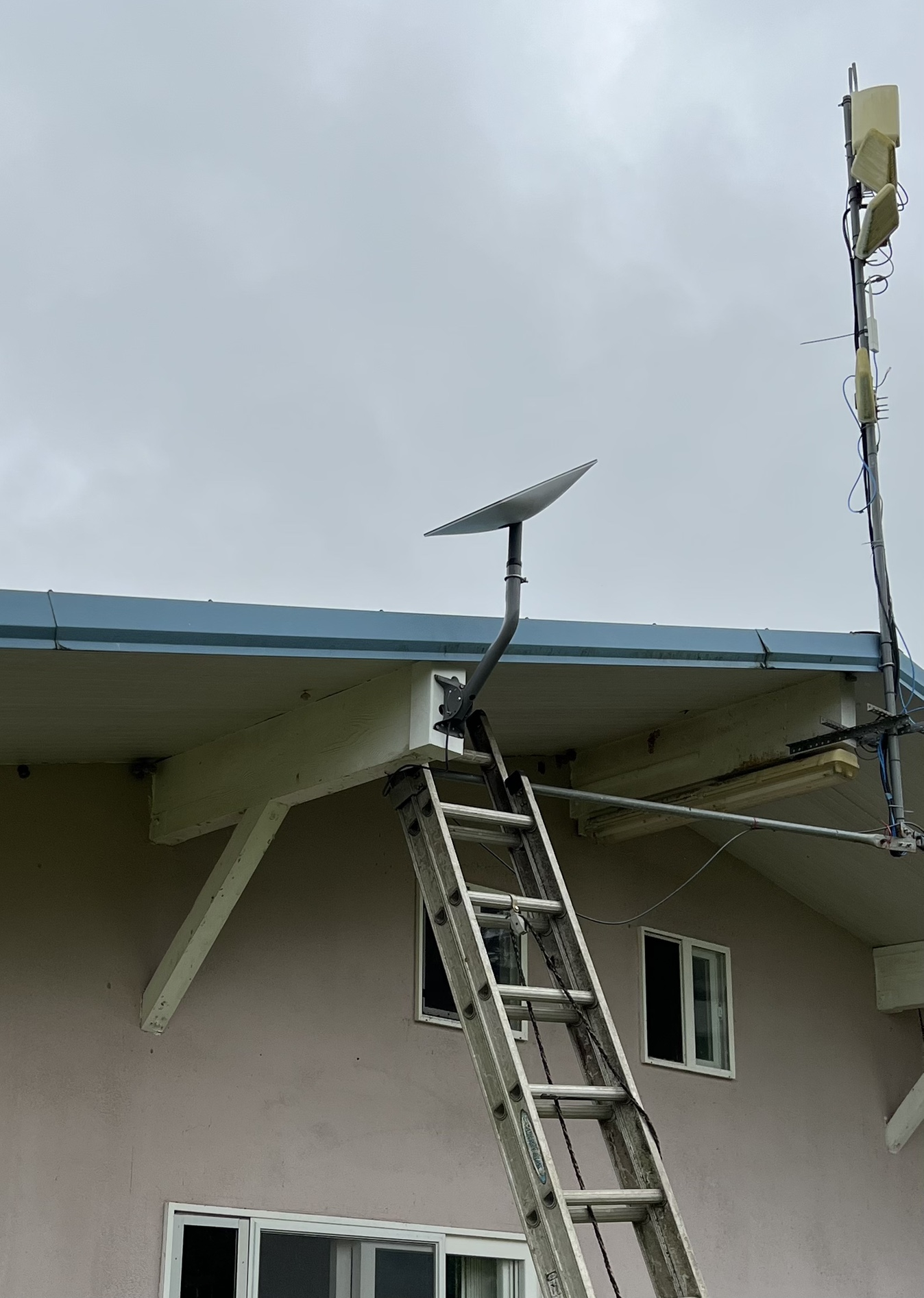

Got my install cleaned up and cable secured. Still need to get some cable molding and seal hole in wall.

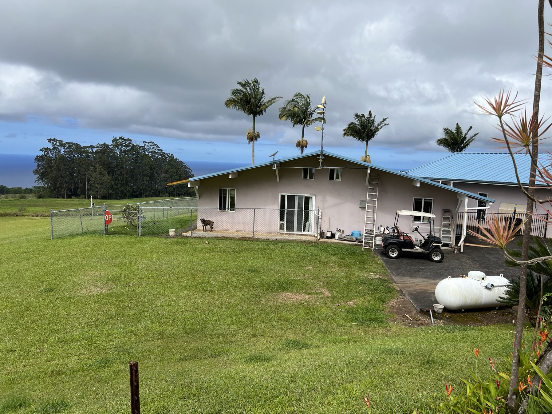

We are completely off grid, solar powered. Located in rural Hawaii about 20 miles north of Hilo on the Big Island, about 1100ft elevation. Been using Mobley AT&T about 5 years.

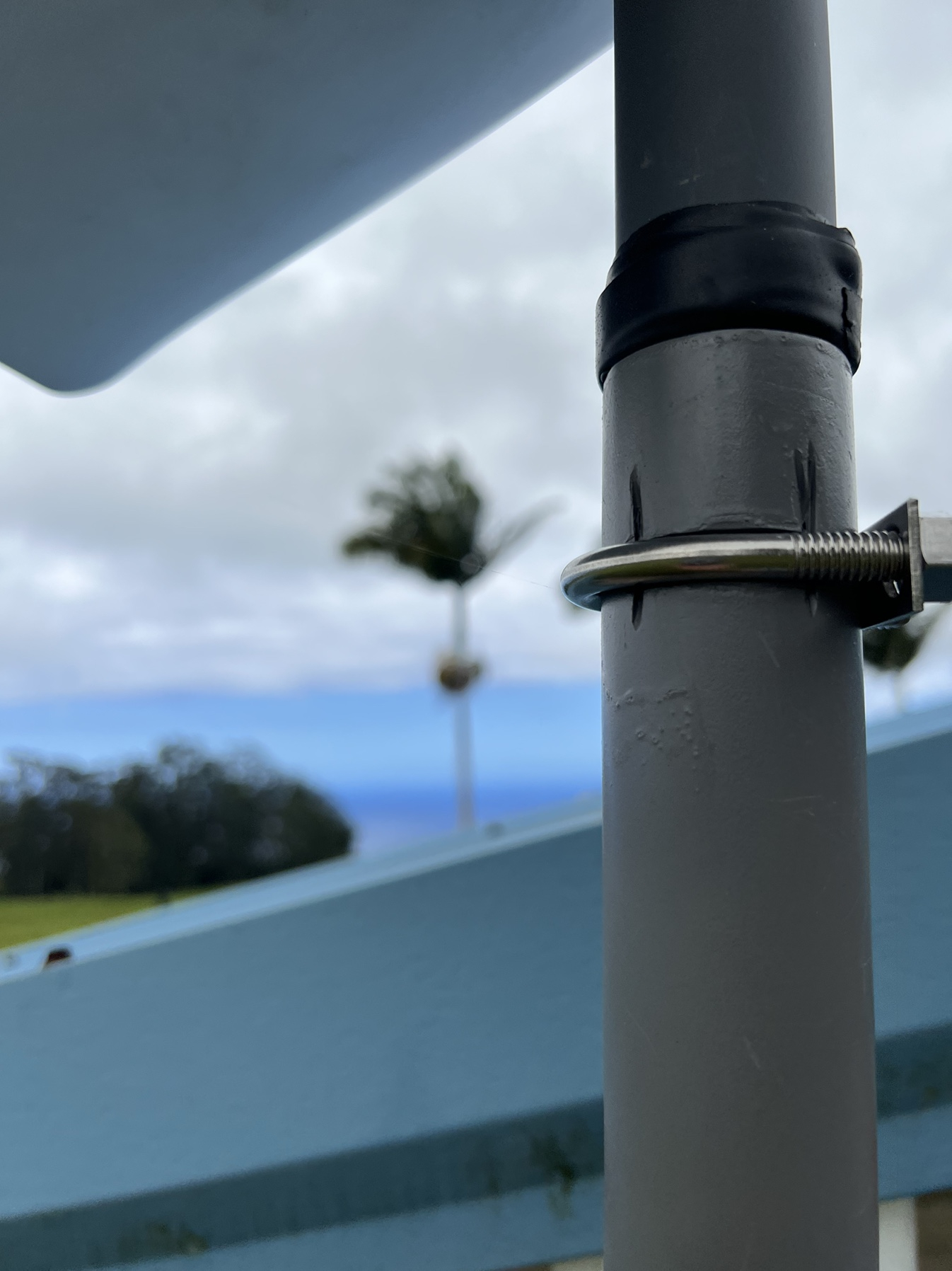

Starlink sat mounted on the master suite box using an old Dish mount. A bit disappointed in that the arm of the SL was much looser fit than expected.Considered a sleeve, but didn’t have right parts handy. A couple layers of electrical tape helped.
I cut 2 channels into the J mount and the U bolt snugs against the SL arm. Nice and steady. A solid mount.
Cable runs thru wall to my cabinet of other networking gear. I added the ethernet adapter and plugged a cable into my Ubitquiti switch, replacing AT&T feed connecting my eero mesh, all my iots, even an old apple extreme. Didn’t mess with anything else. Seeing speeds of 120 across my several networks.
Won’t be doing anything else immediately, but in near future will reconfigure entire system into possibly 4 vlans primarily powered by SL and use the Mobly as fail over. If I I can figure out the Ubitquiti USG.

On your mast next to the SL dish, it looks like you have 2 cell phone antennas. They are rotated 45*, why is that? Mine has no provision for rotating it.
Yagi for my Mofi 4500. That was a recommended orientation for two antenna 90° angle supposedly better reception.
They are rotated offset 45* to account for the polarity of the signal. You can buy them already mounted like that.
