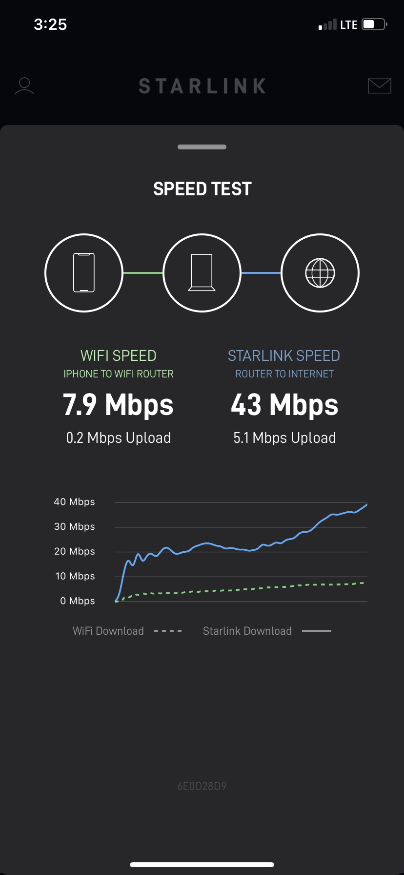

For fun I just ran speed tests from three test providers. I’m on StarLink using a wifi only iPad (2020) 12ft from StarLink router WiFi . Lots of variables to consider I’m sure.
OOKLA 72/9
Speedcheck.org. 27/6
AT&T 63/9
FYI, StarLink advanced app says router to internet is 68/7

This is weird. This is first time my app has shown anything in the Network box. It was always grayed out before and you could not access it
And there is an update to the speed test in advanced mode. It now shows speed across WiFi.
