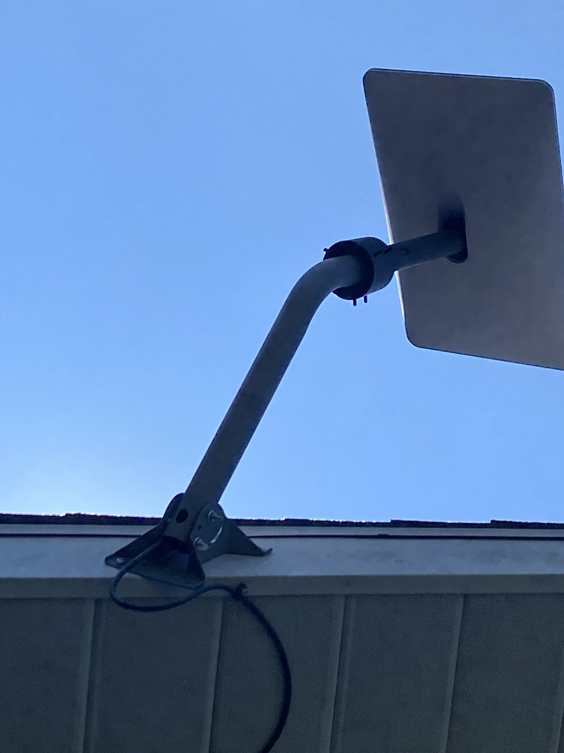

I have been reading thru everything I could find online about the kit to try to source the things I will need to mount it on the roof. Such as, what is the length of the cable that comes in the kit? 75 feet? and what about the power cable. I was originally planning on putting a pole out in front of the house, but that would require a trench across the drive, I don't think I could do it with only 150 feet distance.
I am going to use the S-5 standing seam mount kit. I am sure there will be some other pieces I have to buy. not sure if the pivot mount is what I need to attach it to the roof mount kit.
I used a regular cheap bracket from Amazon, and the starlink pipe adapter, the antenna pipe locks right into their adapter.
Here is the 150 ft cable. It’s the only cable from router to antenna.
The end I’m holding goes into antenna inside it’s pipe.
