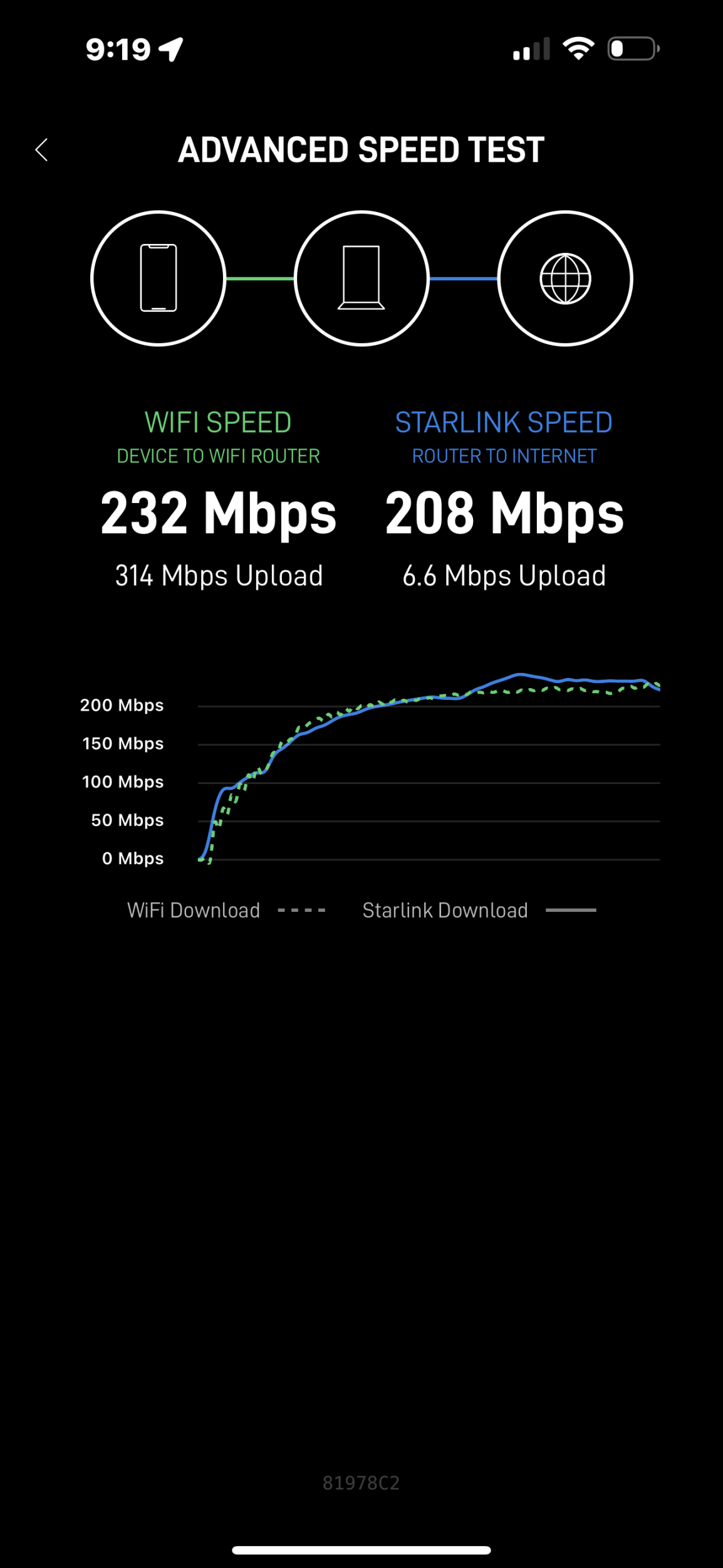

We had a recent Starlink software upgrade. I didn’t bother to check stats after the upgrade because I didn’t see any performance issues. About two weeks ago we experienced several periods of outage that lasted several minutes each, in the middle of the day. I didnt check speeds, when it came back just statistics for outage. I checked speed this morning when I first logged on to work and was shocked that it came back at 179 mbps. Usually a good result for us has been 70 or above. Some times dipping down to mid to low 20’s.
I checked again in an hour and it was over 200. Advanced test was over 200. But by 930 it dropped to just over 100. Still quite an improvement.
And this last one just now, at 1:30 on a friday came in at 195
