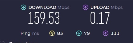

YIPPY….My fiber just came alive today…… going to put starlink on standby.
Heres a grab of starlink…still not bad but $120/mo

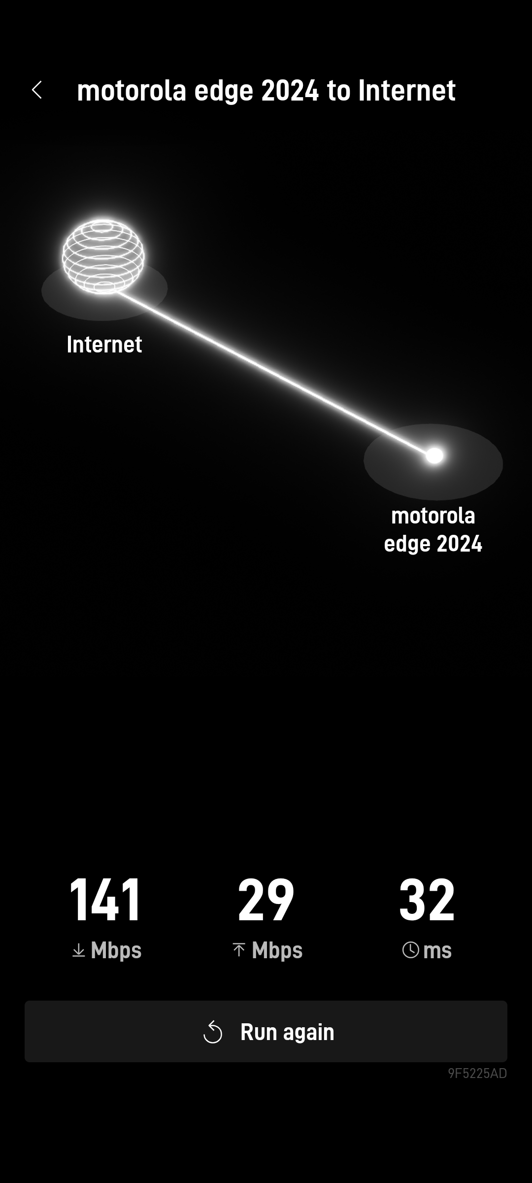

Heres a screengrab of fiber @ $60/month
