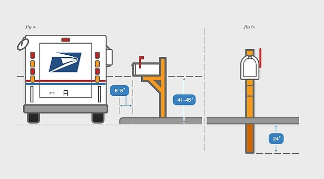

It wasn't a restriction. It is State Law because I live off a State Highway. A 70mph highway at the time. It was lowered to 60mph after it was widened. :rolleyes: I'm pretty sure all state and federal roads have break away sign post requirements. I've seen many downed road signs on I-35. Either from sleepy truck drivers or the wind. My state road intersects I-35 about 3.5 miles from me. Someone took out a stop sign down there a few days ago.
USPS has regulations on mailboxes. Not sure about the post but for sure a minimum and maximum height of the box itself. I'm in a rural area. They deliver mail by reaching out of the vehicle and putting it in the mailbox. And yes, on that 60mph highway. :oops:
We have the same type of mailboxes with a wood post but we're far from a highway. The snowplows have done a number on my box this winter so I'm going to replace it with some type of swinging mailbox.
