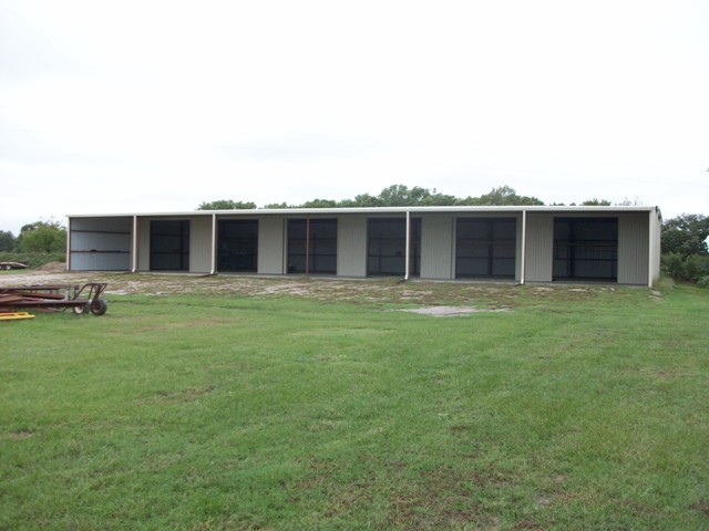

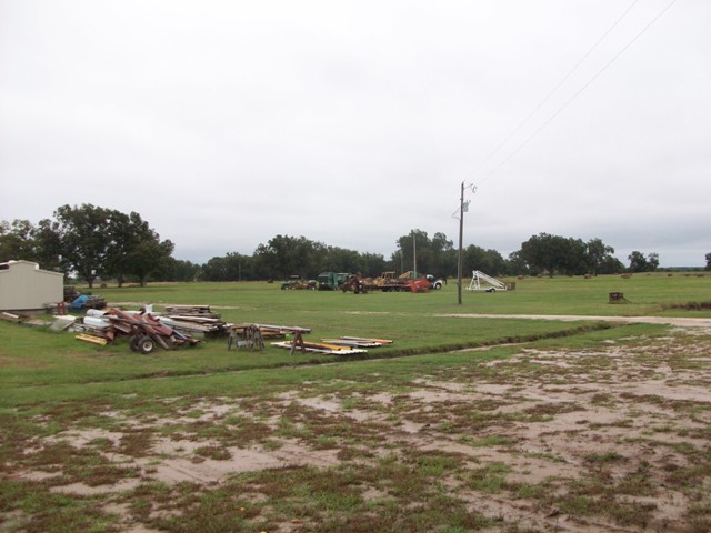

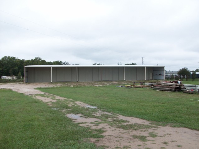

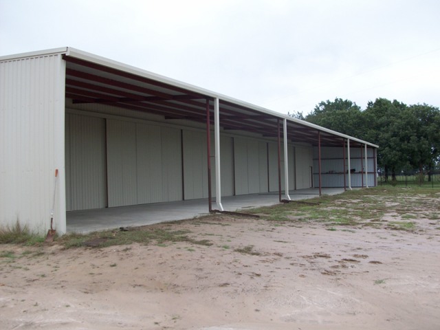

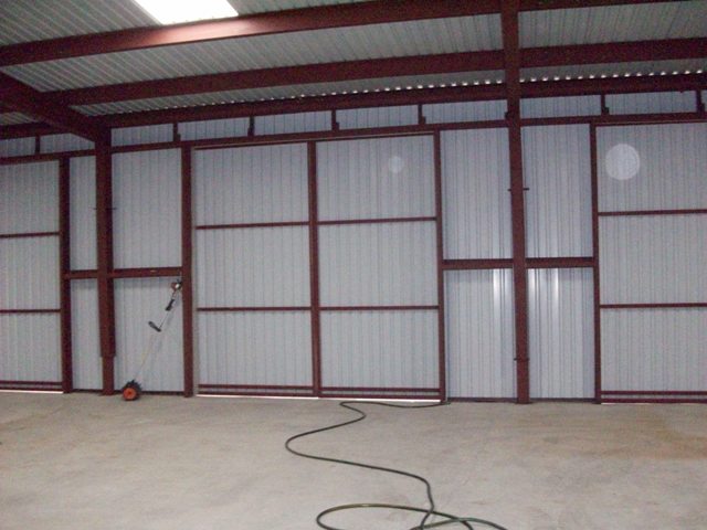

The project is complete. I snapped some photos the other day before we left so I could post some finished pictures.
The project is for the storage of tractors and equipment. It was also decided that a pallet rack at the rear cantilevered out from the wall so it wouldn't limit floor space would be nice for holding cut lumber for air drying.
After the floor is sealed most of the equipment in the photo will spend most of their time inside out of the weather.

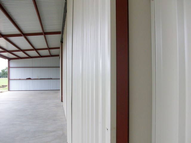

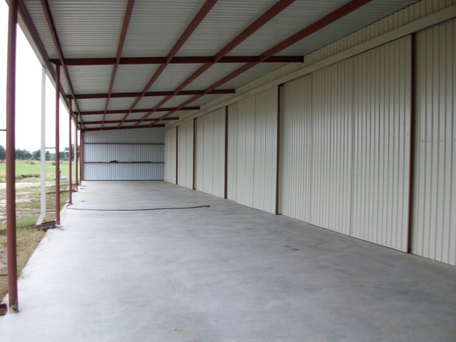

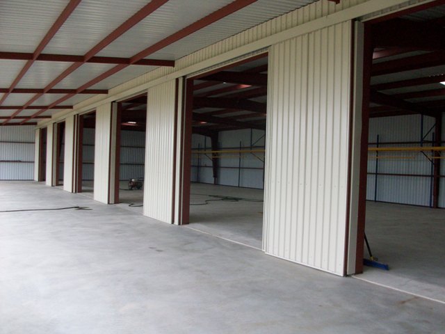

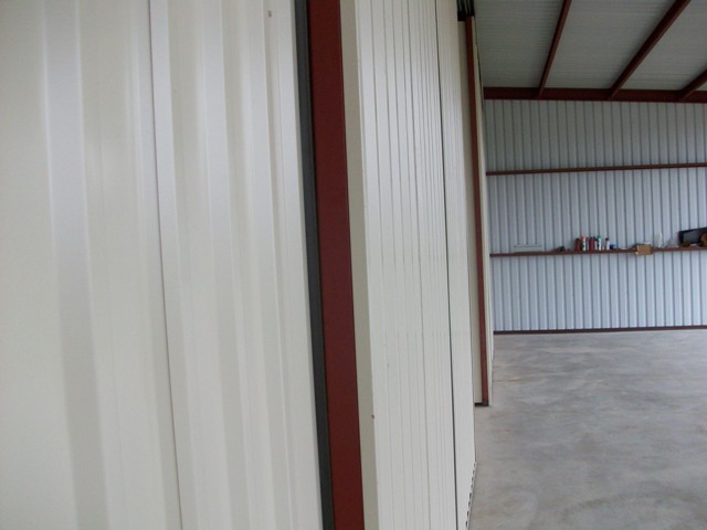

The big thing for me was designing, fabricating, installing, and finishing out the front with as much open access as possible. Roll up doors would have worked fine. But since the doors will only be opened on occasion (I can see some doors going six months or more without being opened) I figured sliding doors would be less expensive to do and definately more likely to be trouble free over time.

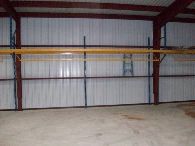

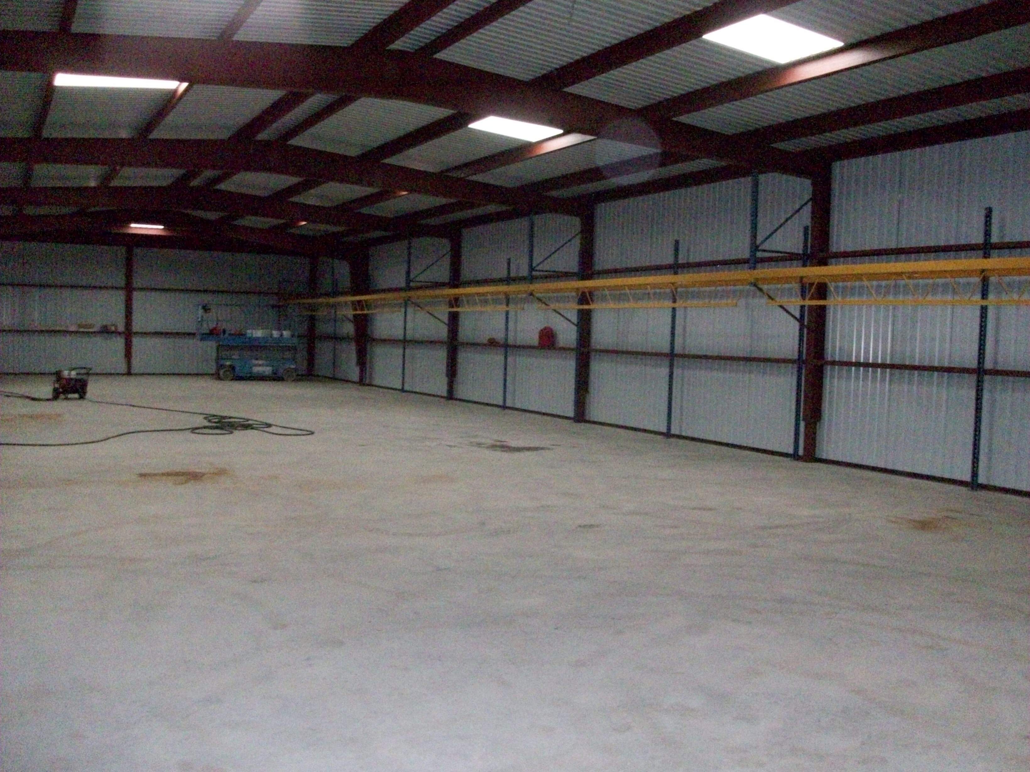

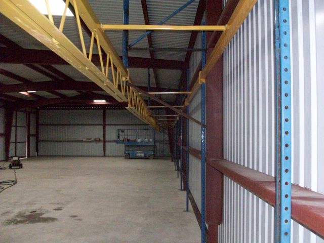

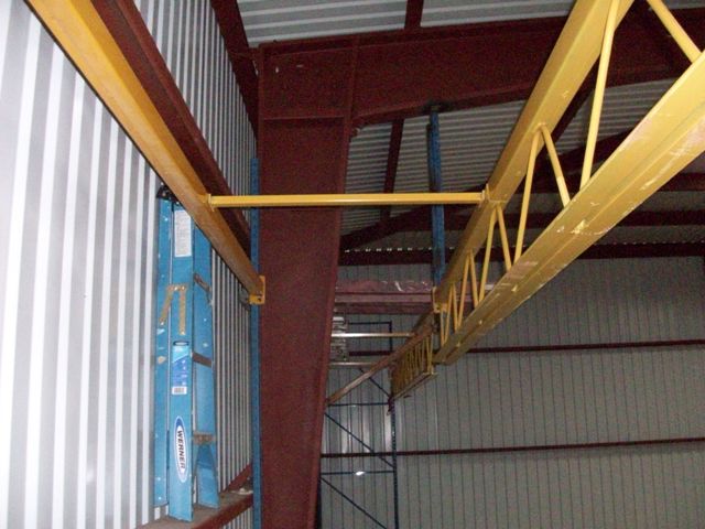

The pallet rack was a challenge. I mentioned how kewel it would be to have a cantilevered rack across the back where the lumber he's cutting could be allowed to air dry and not take up more space. He told me to do it.
