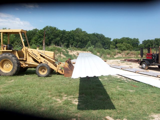

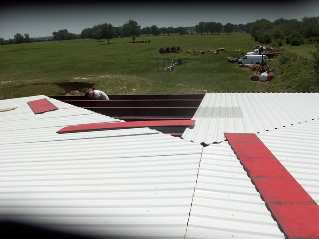

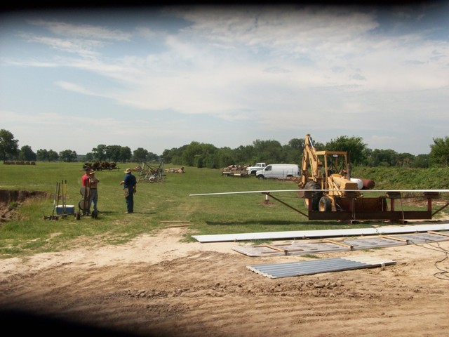

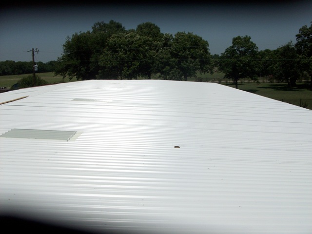

We worked up a pretty good system on the twenty foot sheets. Two of us on the roof and two men on the manlifts catching the marks.
We laid out the marks, every three feet on two purlins so that the sheets would stay square. One man on a lift was at the wall and would catch the mark and make sure the overhang was right on. The second man on a lift was near the peak and catch his mark.
While the younger man, not I, was grabbing the next sheet off the tractor we would tape the leading edge of the previous sheet. The tape is nasty stuff that's double sided sticky ikky poo poo. We would leave the paper on the up side of the tape. Once the new sheet was located the two men on lifts would lock it down with screws.
Then the two of us on the roof would fold back the new sheet and pull the paper off the tape. I would screw the sheet down while the younger man, not I , would go get the next sheet.
It worked out good I think.

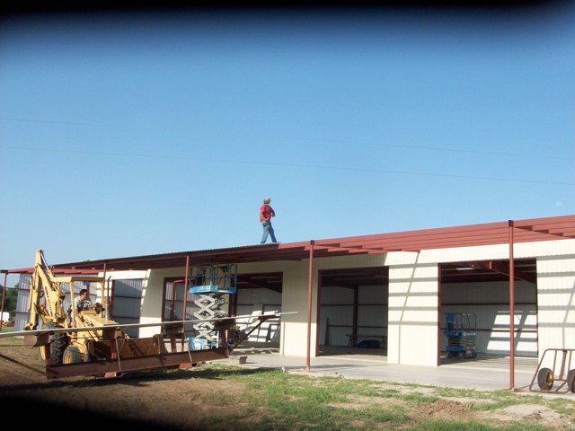

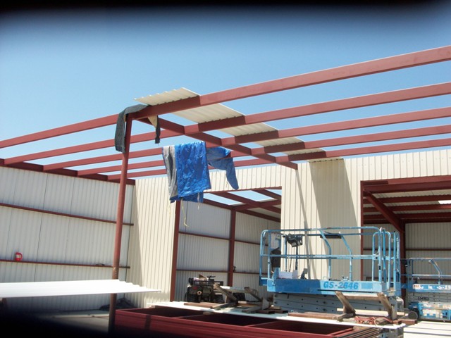

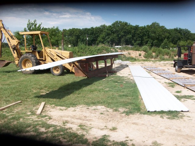

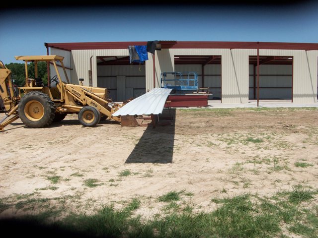

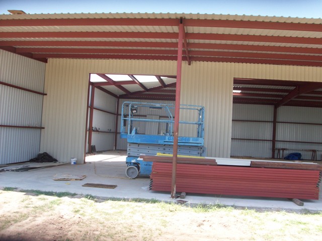

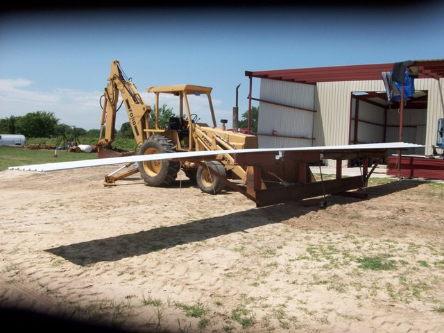

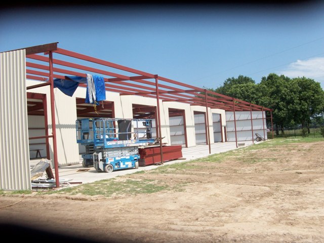

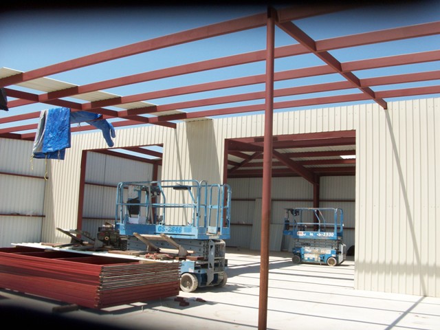

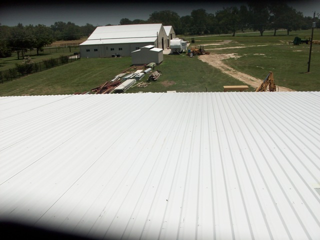

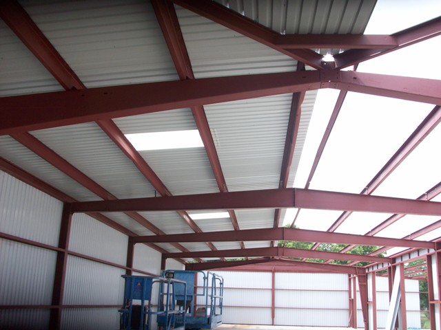

The first thing we did was add some wings to our flying sheet dilly doo. The I beam is sixteen feet and the overhang made the other fellas nervous so we added wings.
Keep in mind these sheets are forty feet, eight inches long.
We changed our system on this side. Here we had one man on a lift at the peak catching his mark and gauging off the other sheet metal. One man operated the tractor, bringing it up for us to pull off a sheet and then backing it out of the way when we had a sheet pulled. He also taped the next sheet on the ground so we didn't have to do it on the roof.
I would start pulling a sheet and as soon as I had it up where the younger guy, not I, could grab it the two of us would pull it onto the roof. The man on the lift would catch his mark and gauge it agains the other side. He would install a screw. I would step out onto the new sheet and catch my mark and then do a screw. Then we'd pull back the sheet and remove the tape. Then we'd all start installing screws. We installed less than half the screws needed just to keep things moving.

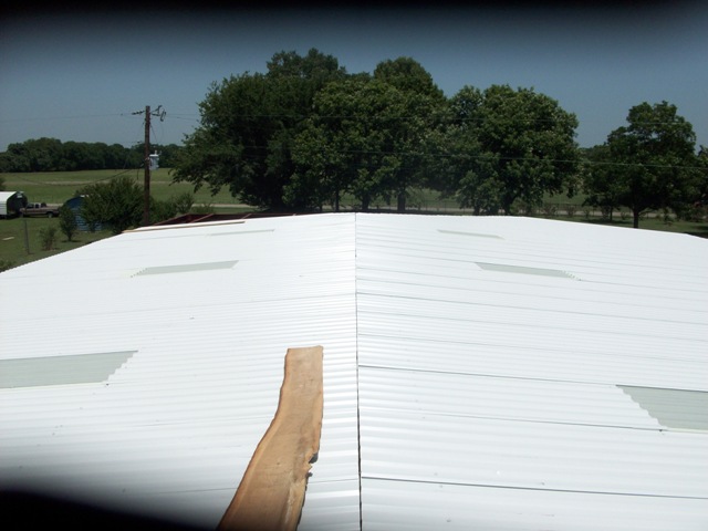

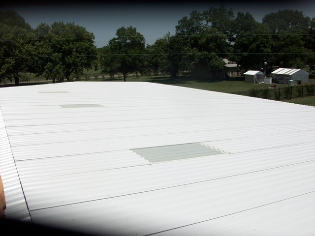

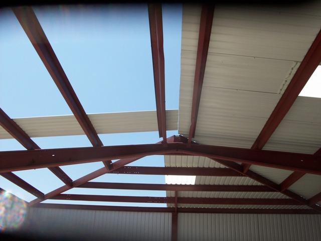

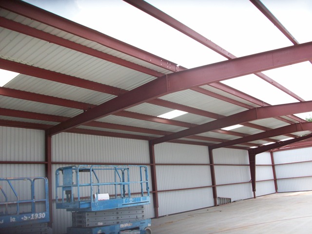

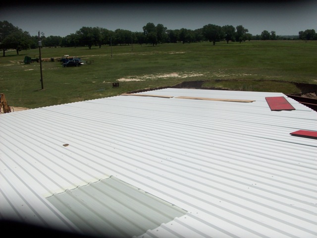

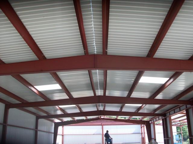

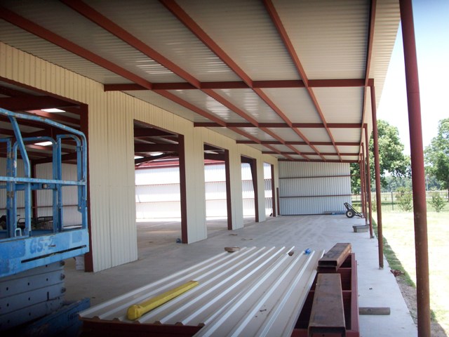

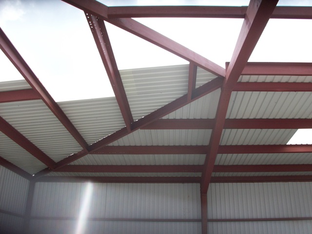

I always say it's much better to be lucky than good. Anyone can be good, that only takes effort. Not everyone can be lucky.
Most of the forty foot sheets went up yesterday before lunch.
Yeah, I know it was hot this week. I also know the white roof in July sun is a bugger bear when you can't wear sun glasses.

Great pics and tip on leaving the paper on the tape. I just finished off a metal roof on a porch last week, and fought the tape on every sheet. I never thought of leaving the paper on it and pealing it off after fastening the metal down at the other edge. I'll remember this for the next time!!!!
How are you doing handling the panels? The heat was coming off of the ones that I installed that I had to use tarps and T-shirts to avoid touching the metal. There is just no way that I could walk on it, and even after installing it, I had issues putting in the ceiling fans under the metal. If I touched the metal panel, I'd burn my hand or finger.

Thank you Eddie. We used walk boards to keep from dinging the panels with our walking the sheets up. Some of the boards are freshly milled oak planks. They were a little slick. Getting a forty foot sheet moving while on one of those was like trying to pull a car while standing on ice. More than once the pucker string almost popped.
The kid on the tractor was on a lift when we did the twenty footers. I slipped and caught myself and then asked him to hand me something like I hadn't almost went for a heckuva ride. His respone was classic, "Mr Lacey, give me a minute. I'm trying to get my heart out of my throat after seeing you do that."
I wear gloves for welding and when it's really really cold. This time of year if I'm handling pipe in the sun I'll use those cheap brown cotton gloves that last a half a day or so.
The sheets weren't that bad. Everyone else was wearing gloves. Especially when an oops dumped a bunch of DNA on some sheets because one person refuses to wear gloves, gulp.
