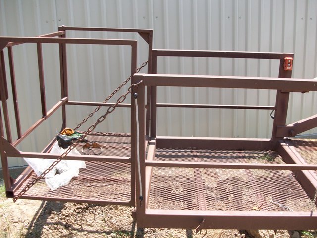

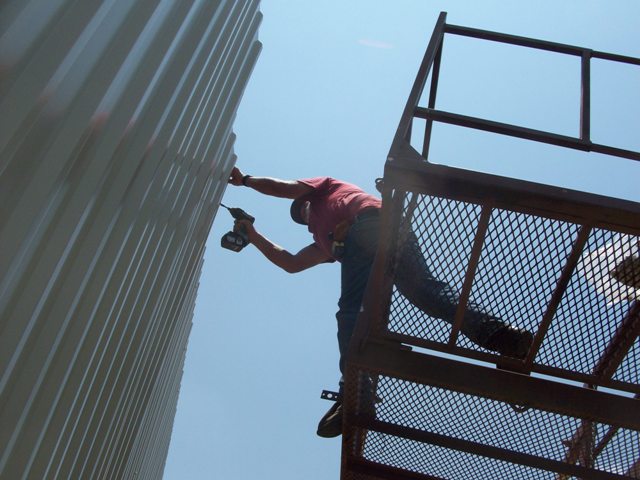

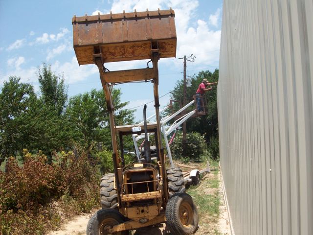

This manlift is more fun than any two rides at Six Flags. There's the sway side to side inherent in the box blade three point set up. Then there's the play side to side and up and down that comes with the sloppy fit coupler insert on the trailer. Add tire flex and two hundred pounds of pure love with leverage and we have in excess of a foot of motion in any and all directions at work while working at it.
I had to jack knife the trailer to get close to the wall to work. The first time I did it I forgot the bleed down on the front loader is only a little slower than the joystick control. I dinged a sheet. If we end up with a sheet extra then we'll change it out I guess.
It really did work well. In the back of my mind was the knowledge that a burst hydraulic hose would take the ride from a thrill to a severe injury in a heart beat. It's definately a one man at a time toy.

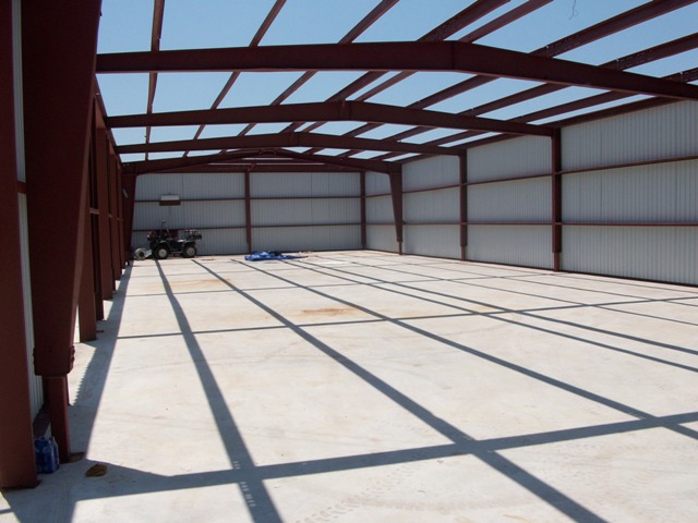

#92

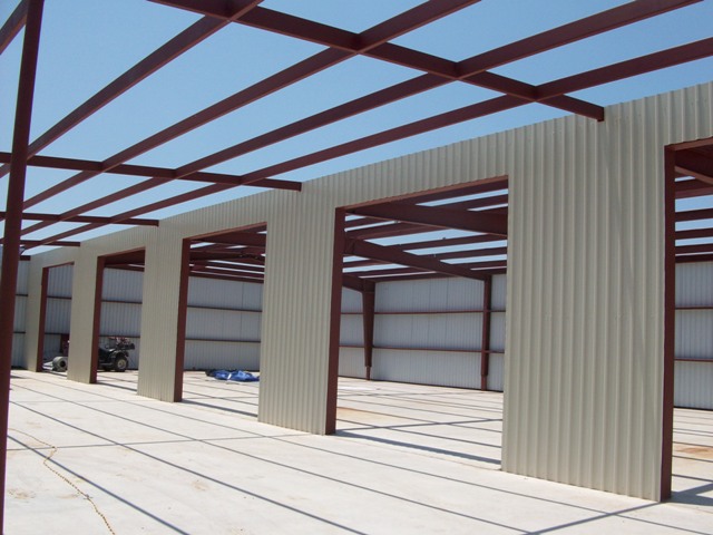

They pulled me off of working on the building for a couple of days while they power washed and painted the framework. I guess that became a good idea when they saw the used framework against the new skin. It definately helped the overall look.
You can see the modifications I had to make to get the sidewalls from twelve to fourteen feet. The hip roofs at each end will be fun and I'll start them Monday.

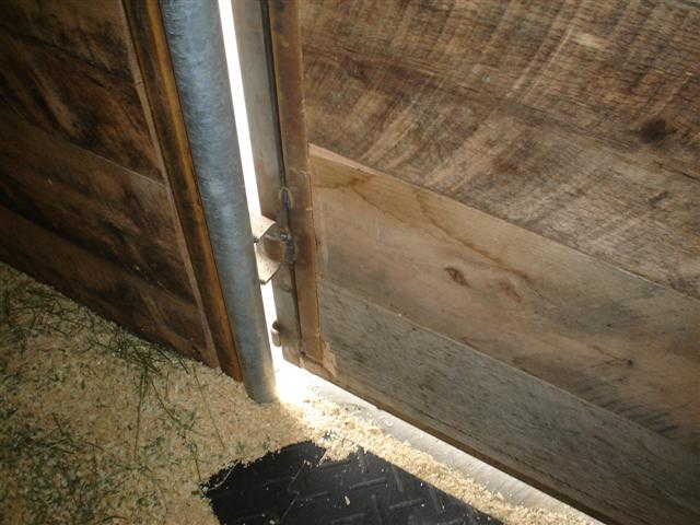

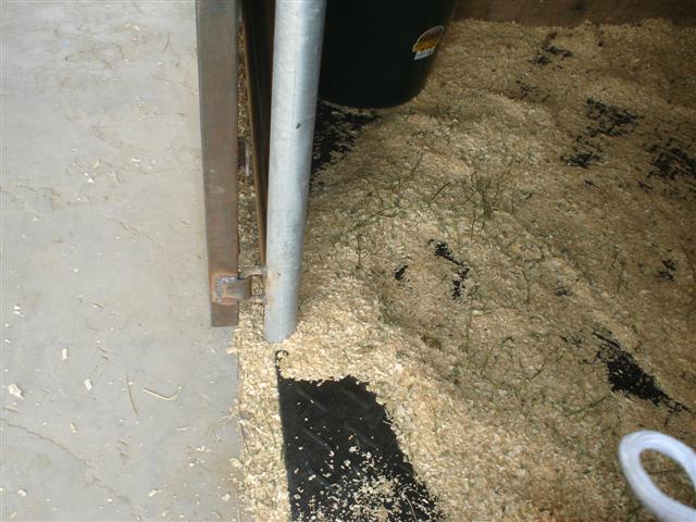

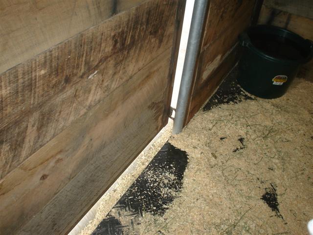

The horse stalls were done with oak rough cut lumber and square tubing framing. I used the horse stall formed U channel you can buy at most steel retailers. Eagle Steel (Greenville Steel, Wylie Steel) and I believe King Metals.com carries it. I had to trim the oak planks because they were two to two and a quarter inches thick and the U channel is for finish cut lumber, 1 5/8".
Sliding doors are the only way to go in stalls. They're not opening out into the aisle where they can spook animals nor do they open in where an upset animal can hurt themselves on the door in their stall.
With the slots and bars I use to capture the door then anything can be used to hold the door closed. In the picture at that time all we used was a brass snap as a locator because the door was firmly secured top and bottom and side to side with the slots and bars. The opening into the stall is completely open so neither the animal nor the handler have something to trip them up. It also makes for an easier clean up.
   / Start of something big.....
#95
The door slides left to open. There is a minimum of overlap on the door across the opening. But that overlap is enough for us to place some tabs that engage brackets welded to the door frame.
If you look closely at the left bottom of the door fully open you will see a tab on the door itself engages the bracket on the door frame. This secures the door so it isn't loose to swing out into the door way if an animal or handler bumps the door.
When the door is closed the same bracket is engaged by a tab on the other side of the door to secure the door so it can't be kicked out into the aisle by a horse pawing at the door. Horses do that. They paw at a door or wall for attention, to make noise, just because they can most of the time.
The second picture shows the tab for securing the door when it's open below the tab that's engaged when the door is closed.
I also used the round barn door track in this installation. I prefer it over the standard square track because it doesn't damage so easily under abuse.

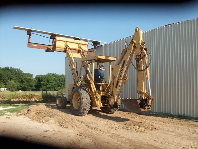

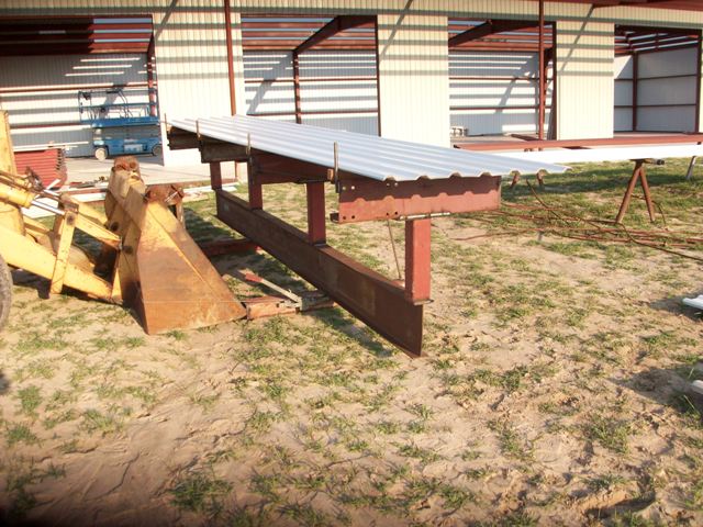

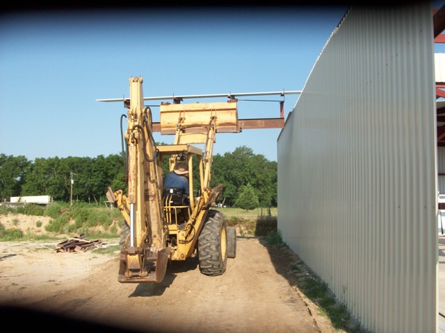

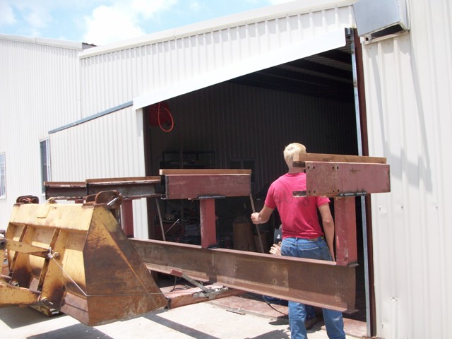

The majority of our sheets for the roof are twenty feet and three inches or forty feet and eight inches.
The twenty footers are difficult for one or two men to handle. The forty footers are almost impossible.
So we did some things to help us out.
The backhoe reaches a hundred and twenty nine inches to the top of the forks. Our shortest wall is fourteen and a half feet from grade on the sides but only twelve feet on the front.
So we made a thingy dingy doo.
I drew it out and pointed out the materials. They jumped on it like hens on bugs.
It worked great for the twenty foot sheets after we made a ramp for the tractor along the fourteen foot wall.
