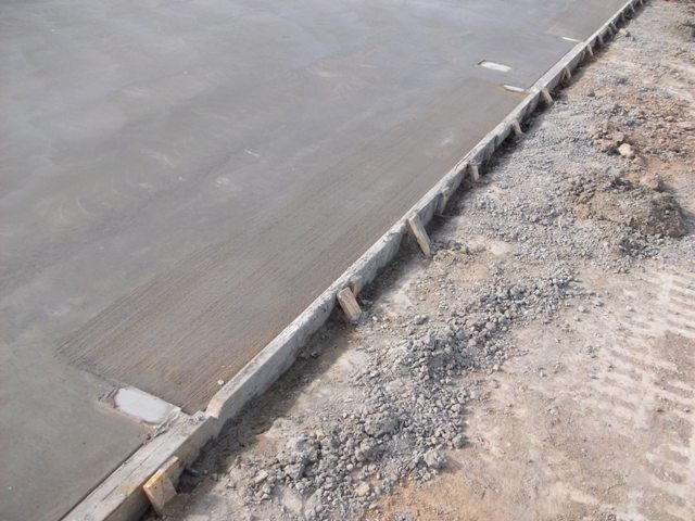

I have a question regarding the concrete forms - what is the purpose behind the flat 2x4 nailed on top of the form boards - is this to help keep them straight or for some other purpose? I don't spend much time around construction sites so maybe this is normal but the few jobs I have seen only had the vertical 2x form boards.
Thanks for sharing - am looking forward to following this project.
Like Eddie said it's for the sheet metal to go down past the level of the floor. We usually fill the cavities with foam to seal out the bugs etc.
Concrete guys call it a tin ledge. Some of the metal building guys in Oklahoma don't use two bys to make their tin ledge. Instead they lay two 1 1/2" square tubing side by side inside the form. The inside one is welded to the concrete steel. The outside one is removed with the forms. The inside one is used to secure the bottom of the siding.

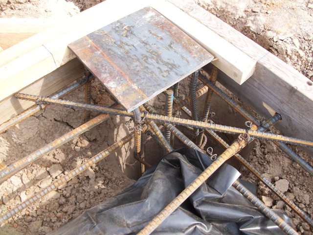

#23

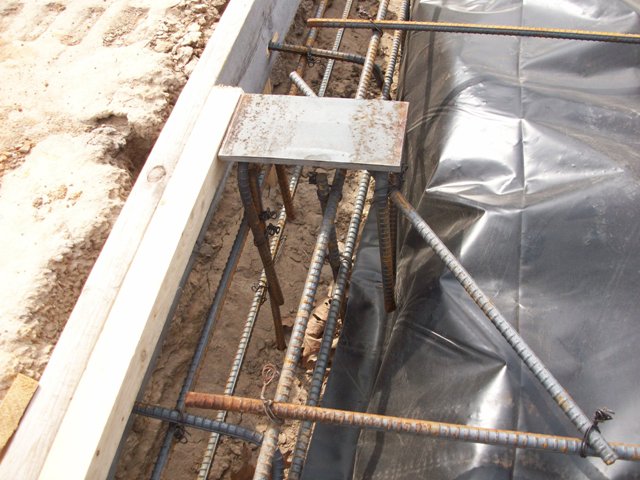

I had thirty two weld plates to tie into the steel prior to the pouring of the concrete. There are six door twelve foot wide doors on the shed side along with a walk door. I also put in weld plates for the columns and the end walls.

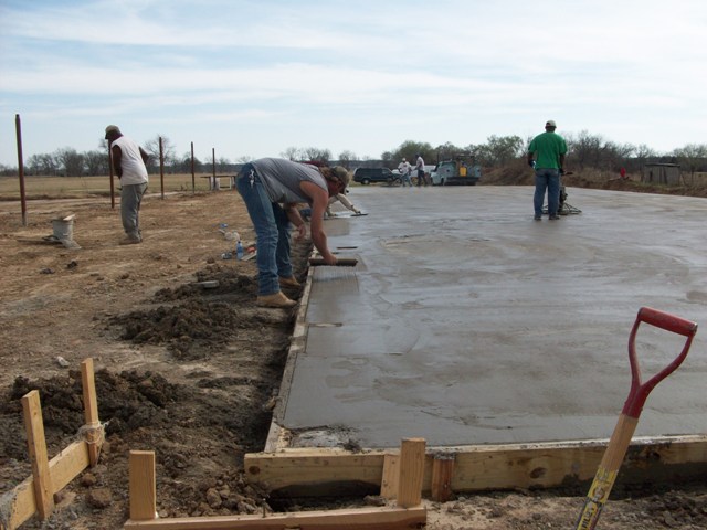

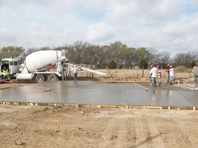

#24

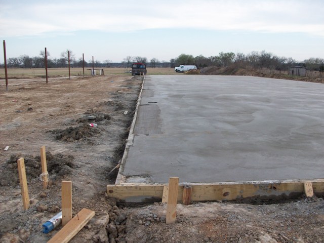

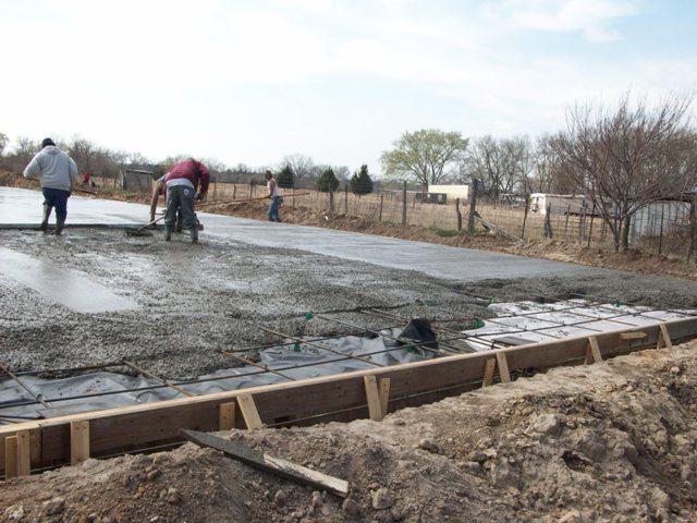

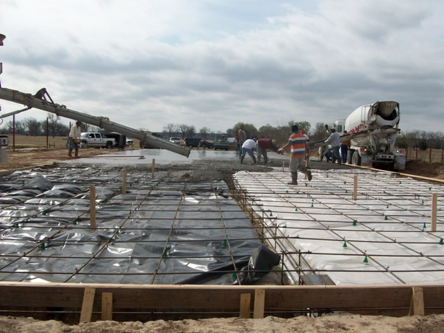

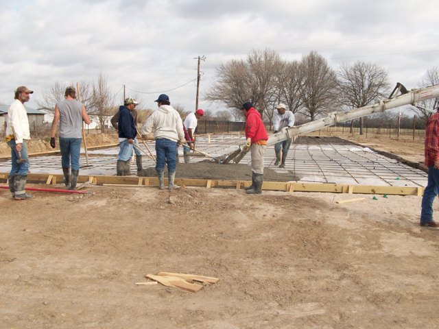

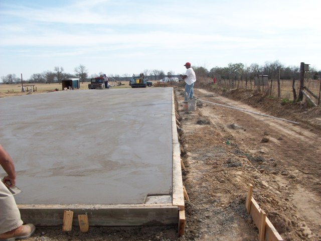

The pour went well. It was tough on me because I'm not good at watching people work. They got in and got after it The pour was a hundred and seven yards for forty eight hundred square feet.

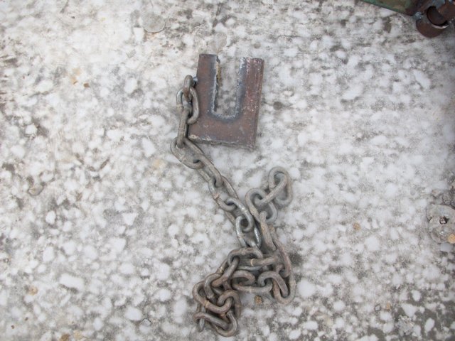

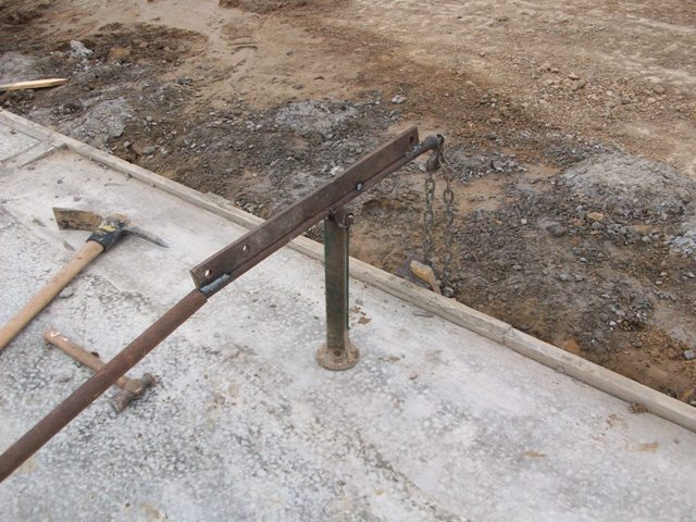

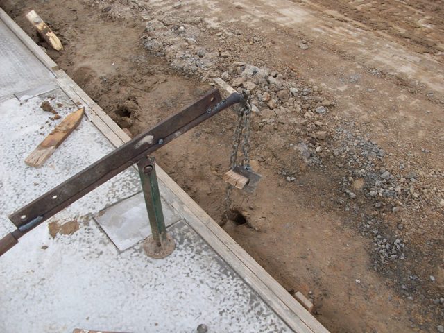

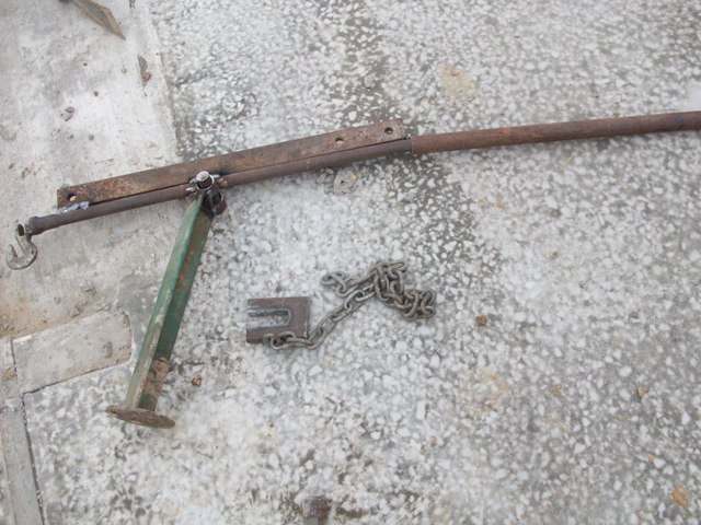

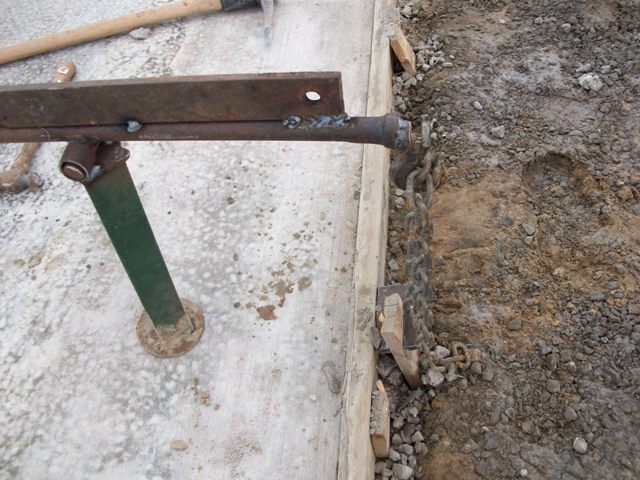

Everyone always says you can learn anything from anyone. I've found that to be true. A classic example was on this job. The concrete crew just shook their heads when I told them I had done all the preparation by myself. They shook their heads again when I told them I was going to pull the forms and prepare the next pour also by myself.
A young hispanic on the crew told me that I needed a stake puller. When I asked him where I could buy one he told me had never seen one in a store. But he had once seen an old man with one on a job. When he described it I had to smile. I had built jacks like that for pulling pipe and t posts.
He was right. I needed a stake puller. So I made one yesterday morning. Then I pulled all the kickers. Most of the other stakes will be broken off at grade because they're encased in the concrete.
I left last week on Sunday afternoon. I got home about seven last night. I'll probably be going back, weather, Monday morning.
