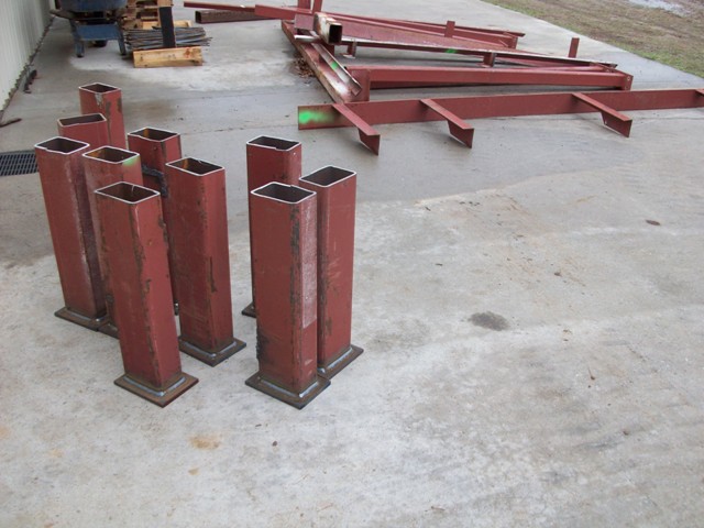

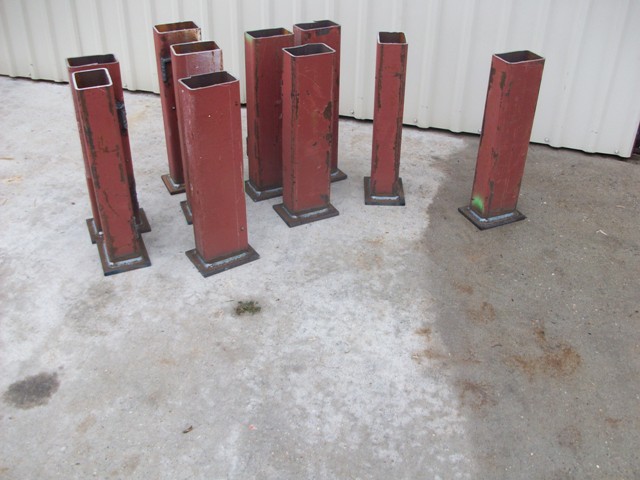

Friday while it was raining I welded up the extensions that will be welded to the weld plates to make the side walls fourteen feet instead of twelve feet. What I did was weld the plates that will hold the posts to the extensions. The unwelded ends will be welded to the weld plates in the concrete. Most of those will have to be custom cut because even though I tied the weld plate rebar tight to the concrete steel (rebar) there was some movement. I'm probably looking at a half inch or so total variance in the heights in the ten plates for the trusses. I'll find the plate the fell the most and cut the rest of the extensions to that height.

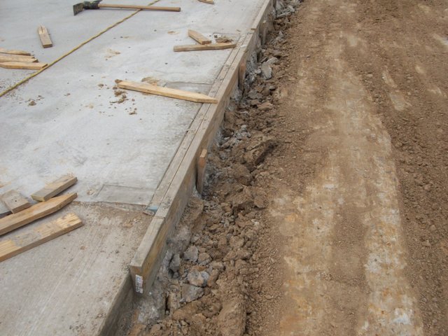

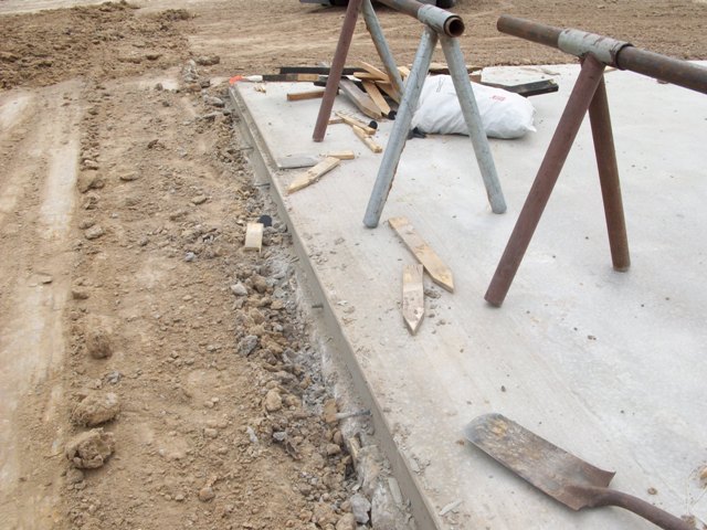

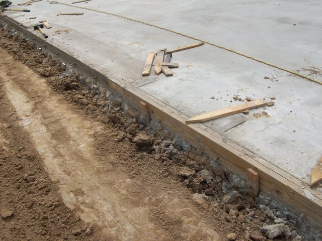

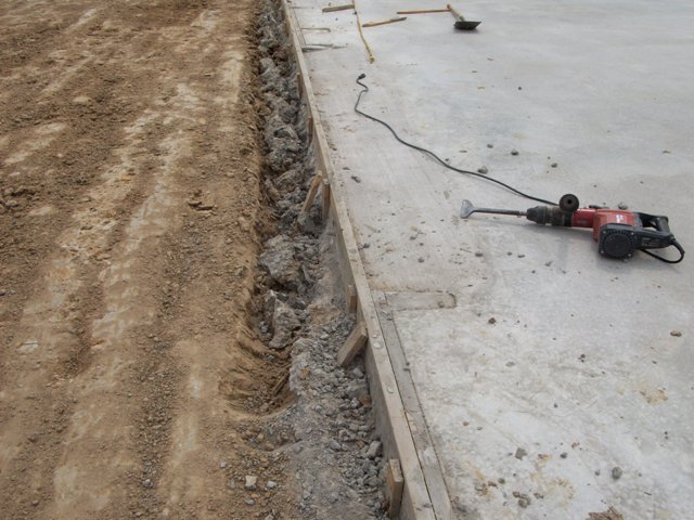

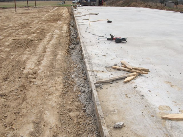

Tuesday presented its own version of fun. They were talking about rain all day. And I had two goals in mind. The really fun was breaking out the forms between the first and second forms. Concrete over flow had the forms locked in solid. I also had half inch rebar coming through the forms. So I couldn't lift the forms vertically because of the rebar extending through. I couldn't force the forms away from the concrete because of the over flow.
I dug out a trench beside the form and over flow, a hundred and twenty feet worth. Then I used the Hilti TE75 hammer drill on hammer to break away the over flow concrete. Once that was done I used my cordless five inch circular saw to cut the stakes imbedded in the concrete. Then it was easy to work the form away from the slab. I finished that up after five, keep in mind, a hundred and twenty feet worth of work.

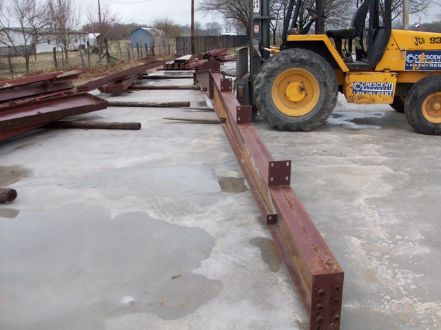

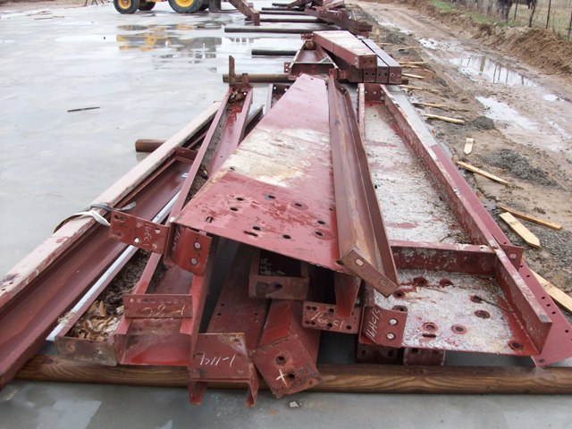

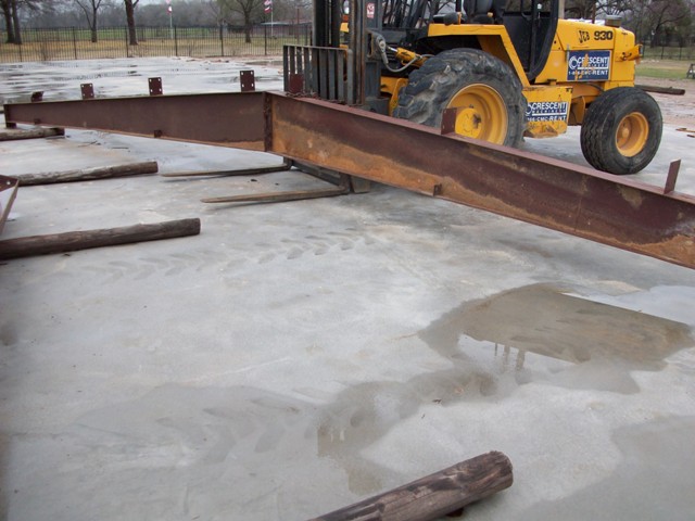

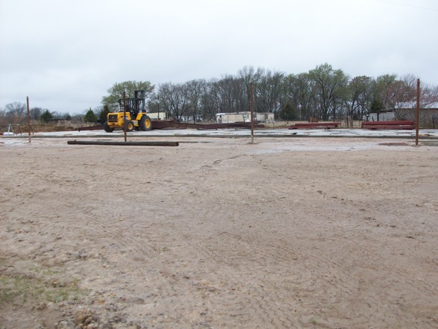

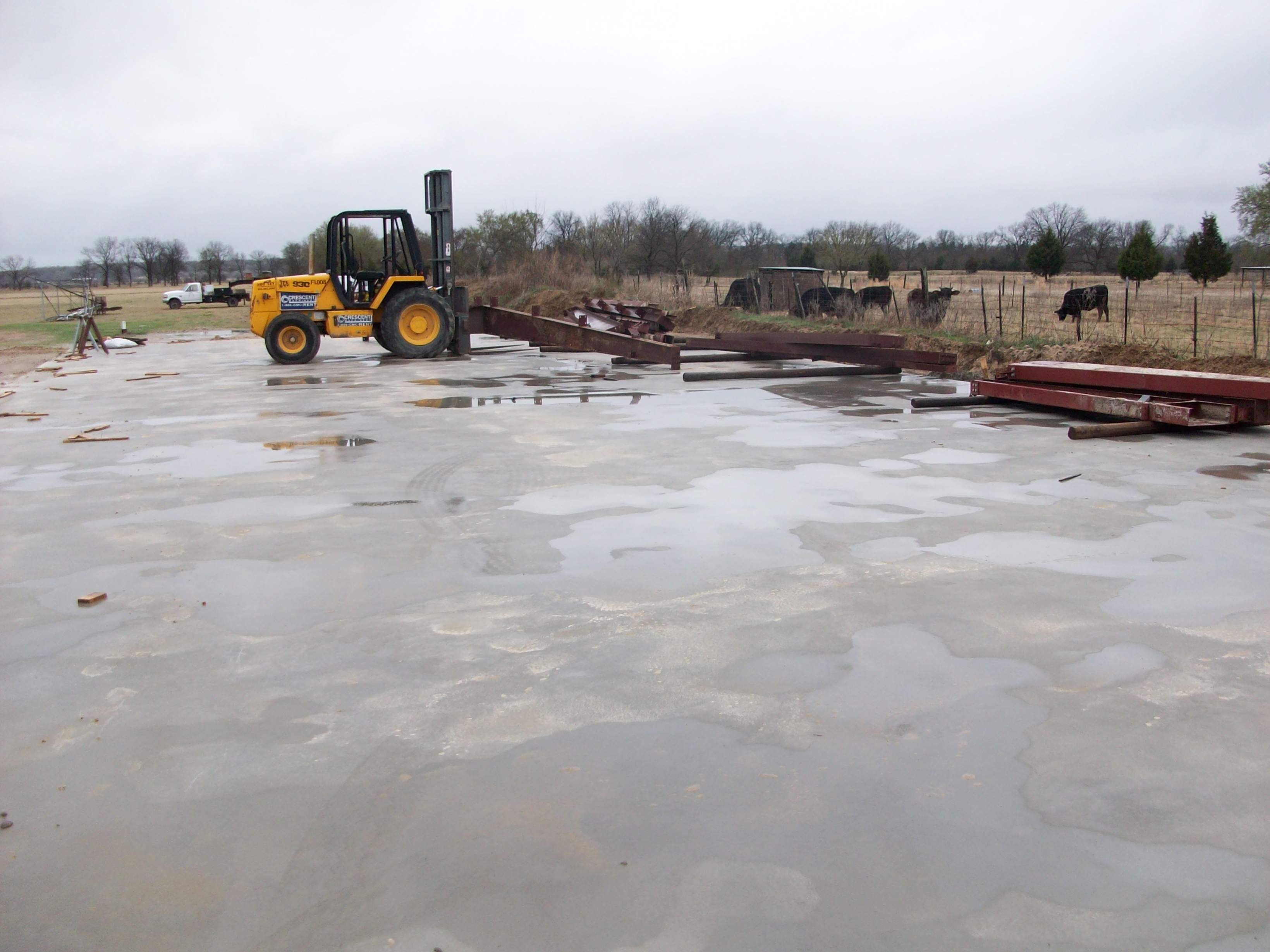

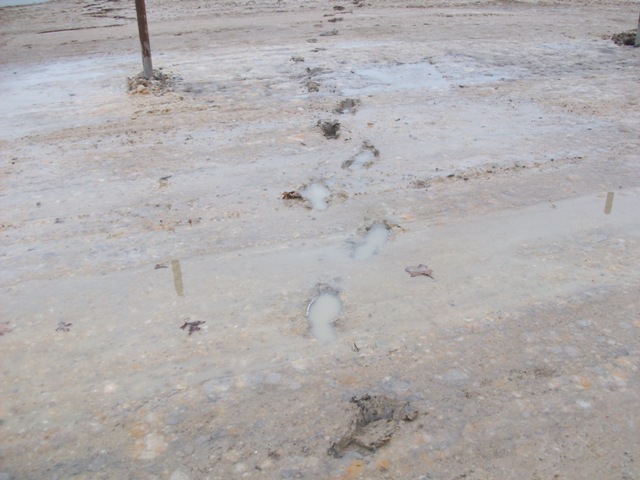

The second goal I had for Tuesday was to get the high lift forklift and all the truss steel up on to the slab. I knew that once the rain started it would be impossible to get the stuff up there with what I had on hand. I have a backhoe, a skip loader, a large high lift forklift, and all of them are two wheel drive. When this sand clay gets soaked it's not only slick as snot, it has no bottom.
I got good and wet Tuesday evening by the time I had it all up where I wanted it to be.

I'll be going back up today. The rain has stopped and it looks like I've got a dry week ahead. I hope to have the trusses up and braced in a couple of days so I can get the big forklift back down to the city.
I've also got to get the second pour formed and the steel installed. It's already graded and by week's end the ground will hold concrete trucks just fine. The slab doesn't have to be done before the building framing. But it would be better.

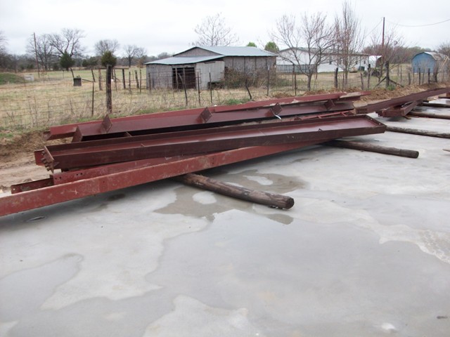

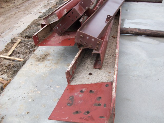

Some who find what I'm doing interesting might appreciate that I've got trusses from two different buildings. There are three structural steel trusses (I beams) and there are two formed steel truss assemblies. One of the hiccups is the structural are designed where the wall purlins fall between the uprights. The formed steel are designed where the wall purlins fit on the outside of the uprights. I installed the weld plates so the formed trusses are on the ends with the structural ones fitting in the middle.
I discovered another fly in the ointment Friday. I found two five gallon buckets full of bolts for the building framework. The buildings were taken down late 2007. Evidently the buckets of bolts were left out in the weather for a winter or so. The bolts and nuts were stuck together with a thick coating of leaves and rust.
The bolts and nuts spent a night in a concrete mixer with about sixty pounds of steel shot media. Yesterday before I left the job site I put all the bolts in trays and covered with diesel. They cleaned up great. But I want them to work easy. I'm a little old to be fighting reluctant bolts and nuts getting together.

How well did that flat tip work on breaking up the concrete? I have a pointed tip on my SDS Max Rotary Hammer and it just melts through concrete. I've seen those flat tips like you have, but wasn't sure of how they work, or if it might be better then the pointed tip that I have.

Eddie the TE 75 also uses the SDS Max system. I used the blade tip because I was cutting mostly thin stuff along a line.
