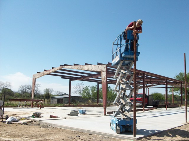

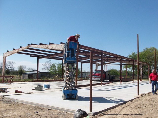

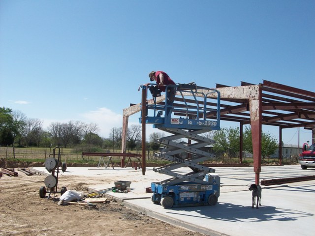

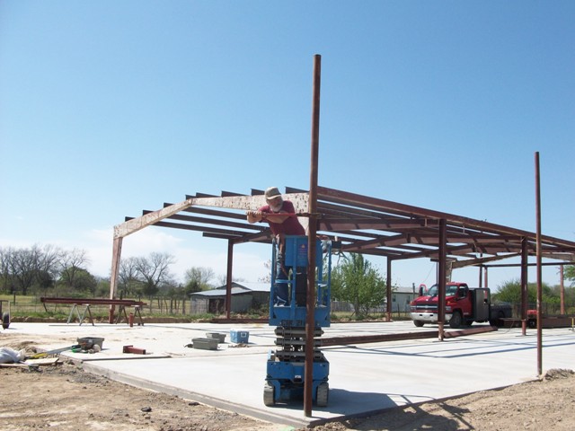

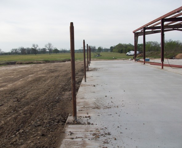

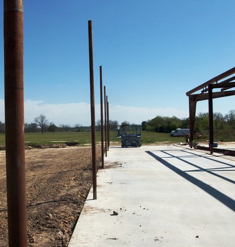

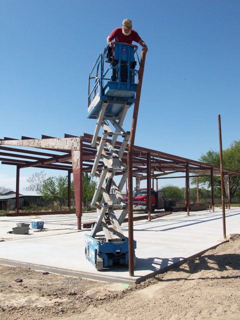

I get most of the comments in real life about my lack of help. Actually I have plenty of help. It's just not the human kind. This is one of them helping install the extensions on the porch columns. Keep in mind this is heavy wall drill stem from a Vermeer 50,000 pound push and 100,000 pound pull directional driller. The stem was damaged at one end or the other. When I installed the posts I put the bad end into the concrete. The extensions were matching good ends and easy to install, with help.
The first thing I had to do was horse a piece over to the helper. Then I used a clove hitch and a strap so the helper could lift it up in place. The last helper was a three foot pipe wrench. Think, BFH.

   / Start of something big..... #60
Harv we always like the pictures. I'll have to wait till you get back to an internet connection to find out why the poles at the edge of the concrete that you installed with the man lift seem like they are taller than the rook of the building. Right now it is a mystery to me. It has been a while since I read the start of the thread so perhaps if I go back and re-read it I'll find my answer.
