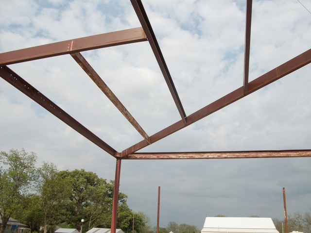

Harv, quick question. In one of your photos it shows you with a large pipe wrench tightening the upper pipe to the bottom pipe. Would it possible for you to pull the entire pipe loose from the grips of the concrete footer using the pipe wrench? I did not know if the pipe that was encased in concrete had anything attached to it to prevent uplift and twist.

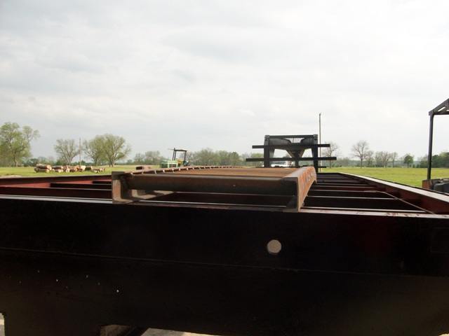

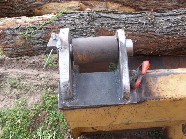

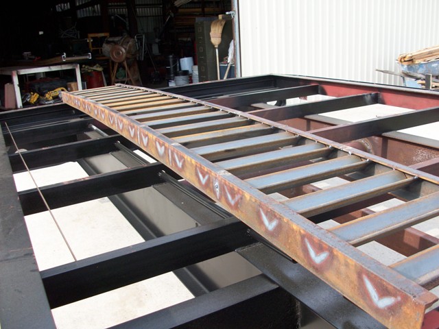

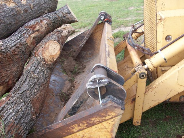

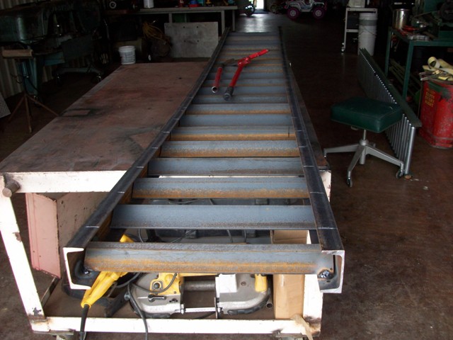

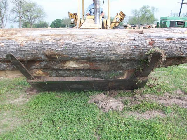

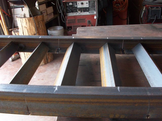

A couple of weeks ago I took some pictures of the work I'm doing up there.
edit, half the pictures didn't come through, double doggone darn computers.....
The pipe is in a hole seven feet deep and a foot and a half in diameter. There's enough surface contact to prevent any kind of twisting loose under anything less than forces like a tornado.
On hinge posts for big gates I will cut in big holes in the pipe below grade. Cutting is easier than welding and I believe a five inch pimple of concrete in a post is a heckuva resistance to twist.
