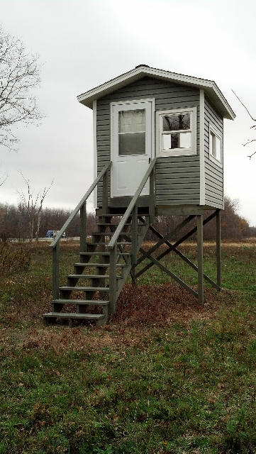

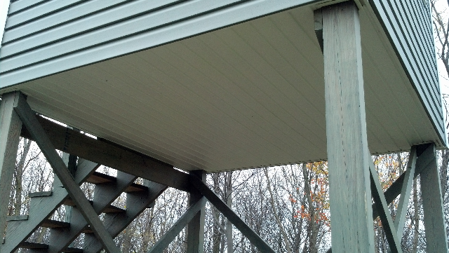

I'm done with the tower till I get a piece of commercial carpet to fit. Installed the storm door and a couple shelves today and finished the soffit under the floor. Also charged my phone from the solar system I installed. Now I'm thinking of following Eddie's advice on the coffee pot so I can make hot chocolate for Ava and myself while we are out there.
