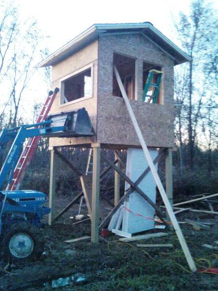

Well I have been busy helping my friends harvest their grapes so I have not had a lot of free time to work on the stand. Today I helped harvest but left around 2pm as it was too nice a day to be stuck inside a cab tractor and I was just a luxury and wasn't really needed other then to help make things run smoother. So I insulated my ceiling after finishing attaching the ceiling joists then I covered the ceiling with OSB. I also insulated and OSB'ed the wall where the door is. I put the soffit on the one side and set the exterior window trim. I also put the last piece of OSB on the exterior wall. So it was a good day. Tomorrow should be the last day of harvesting my friends grapes then I will be free on weekends again.

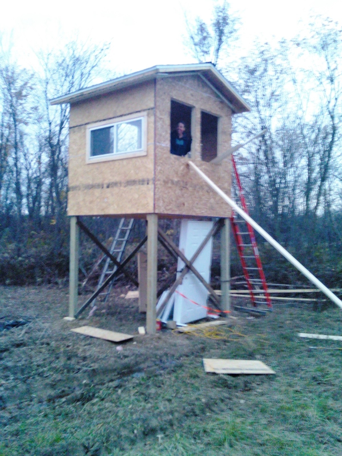

#79
Well Brandee came over tonight and helped put the last sheet of OSB under the floor and hang the last three sheets on the interior walls. We also set one window and the door and installed the handle/deadbolt so it is secured except for the unchained ladders and three open window holes:rolleyes:. My neck still hurts but the hard parts are done. Now I just need to set the last 4 windows, wrap them and finish the soffit and wrap the facia. Hopefully I can get a stair case built but I am not sure if I will have the time before season starts. Hopefully.
Thats Brandee in the window opening.

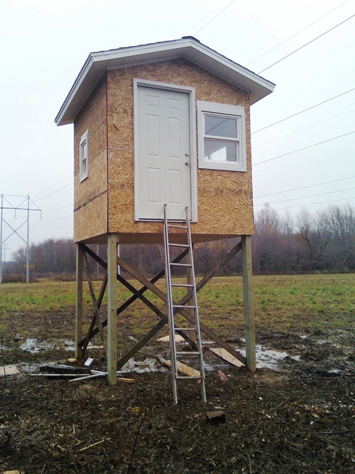

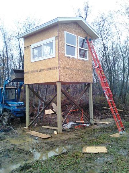

Well today was a crappy day, we had strong winds and a ton of rain again so everything is underwater. I never thought I would have to build a tower stand just so I could hunt above water:rolleyes: of course if this keeps up I can hunt ducks out of this stand pretty soon. Might even make a nice ice fishing hut if the water gets up high enough, just cut a hole in the floor:D I sure do wish it would stop raining for a few weeks so my corn ground can dry up so I can actually get on it to harvest it.
So today I didn't do anything but work on my stand. I finished the soffits and facia, installed the rest of the windows and wrapped three of them (the two new ones I am just going to J around). I caulked the small window on the back as that was the only dry side that I dared caulk. I also put some more nails in the OSB inside as its only tacked. So I guess it was a good day since I did everything on my own and I dislike bending metal by myself.
I am going to design the staircase now and figure out what materials I need. Hopefully I have enough here to save some money. I realized I don't like the ladder to the door and am not going to put up with it any longer now. So all thats left other then the stairs is to bend the metal for the door, finish nailing the interior OSB (I ran out of nails so I had to go back to the barn for more) and finish screwing the OSB to the bottom of the floor joists. Then make some extensions for the windows and trim them and the door off after I insulate around them. I am not sure if I will bother to paint it this year or next spring. Brandee is looking forward to that job but I need to get done with this for this year so I stop driving around out there and let the deer get use to the new setup.
Its looking a lot better now and I am very pleased with how its turning out.
