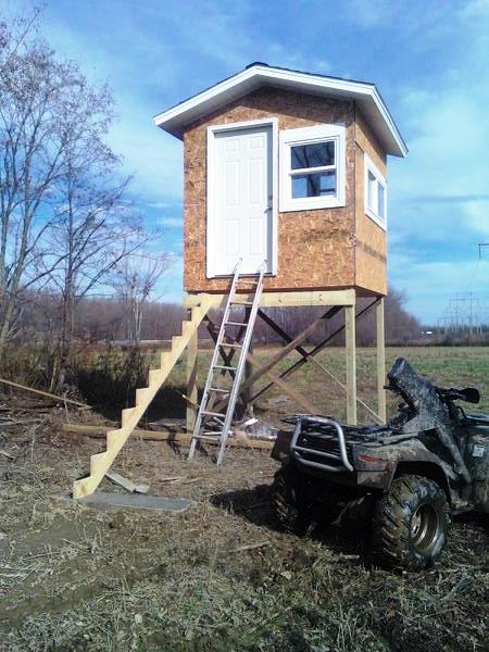

I got a flu shot about a month ago and in the last week my girlfriend and daughter both caught the flu. So I have been doing my best to help them out. Well last night was a rough night for me. I think my body is fighting the flu as well. The flu shot helped me build antibodies in case I got it so it won't be as bad and that is whats happening. I slept for 12 hours (usually I am lucky if I get 6 hours) and have been freezing then sweating. So I am ok I guess as right now I don't feel too bad. Of course I am still trying to work on my tower some. I cut out the first stringer and took it down to the tower. Everything lined up perfectly. The other two stringers are marked already I just wanted to make sure the first one would work like planned before I cut the others and the steps. So here is what the stand looks like with the first stringer nailed up and resting on the concrete pad.

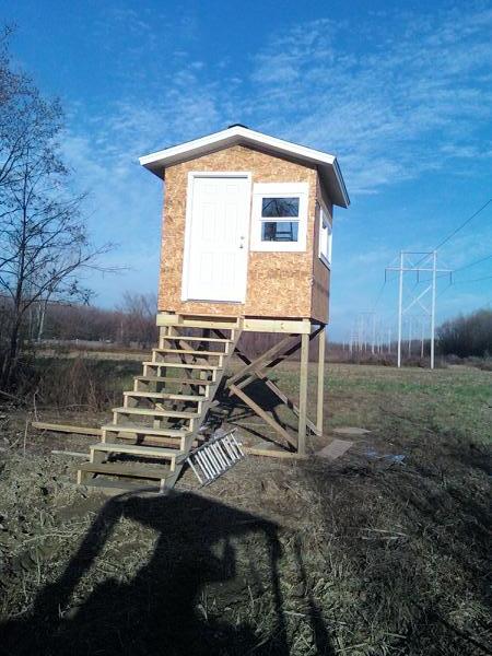

Well the forecast wasn't looking good so I decided to cut the next two stringers out and put the stairs together. One of the 2x12's is cracked and I didn't notice it till I was cutting the notches for the stairs. There is no way I can use it so I will see if HD will exchange it for a 12' 2x12 that is good. So I put it all together with just the two stringers for now. It may be perfectly fine with just two stringers since this isn't going to get a lot of use 11 months out of the year but I would rather build it properly and never worry. So here is the current progress.

Robert, I hope you get over the flu soon. No fun...:p
Your steps look nice. I'm soon to add new decks to my house and all the steps will be with three stringers. I have other steps with only two stringers, but they are made with 4x12s and so are the steps. Your stand is sure looking good.:)

Thanks Jim. I actually don't feel too bad and I am thinking that is because of the flu vaccine I got earlier. I still have some issues but I know it can be a lot worse.
My steps will have three stringers as well. I just need to get a good 2x12. The forecast is for more rain and cold temps so I wanted to get as much outside work done as I could. I was going to caulk the last two windows as well but for some reason my "good" caulk gun broke. I guess thats what I get for buying a good caulk gun instead of the cheap tin version:rolleyes: I have more caulk guns but I didn't want to come back to the barn just to drive back out there so I will do it the next chance I have.

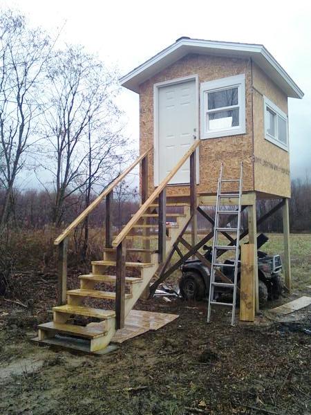

Well today it was suppose to start getting cold again and it was suppose to rain between 9 and 12. So I had planned to go out first thing this morning and knock off the railings and caulk the windows. Well my friend called me at 7am needing help as they had no water in their house. Go over there and mess around for a while inspecting the pressure switch and expansion tank only to find the problem is a plugged filter. They said they had pressure that morning then it just quit so I am assuming there was some junk floating around in their system that passed through and finished plugging the filter as they do change the filter on a regular basis.
So I go out back and grab a couple 12' 4x4's and start cutting them for the railing posts then go inside to take care of Ava. Well after lunch it finally got cold and I go outside to finish the posts and it starts hailing and raining:rolleyes:. I just bundled up as I wanted to get this done and finish the posts and head out to the stand on the ATV. Start drilling holes for the lags and the battery dies on my Rigid impact driver I use to screw the lags in. So I use the 18v DeWalt and have to keep switching between driver and drill. Well the first lag and I lose the first range on the DeWalt (its a new drill :rolleyes:) but have three ranges so I just use the mid range and finish the job. Use the two 16' 2x4's I had laying out there for the top rails and screwed them down. I need to put 6 more lags through the posts into the steps to really make me happy but I need to buy them still. All in all it was a productive day but it came with a few challenges:)
