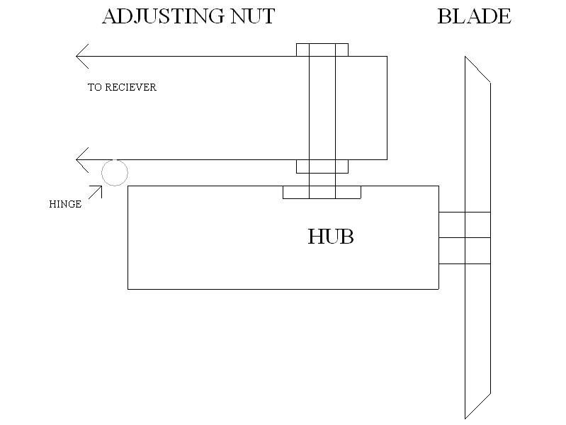

   / Started my welding class am looking for a project #64
Yes, it is like PT's. I was looking to get more use out of the PT trailer hitch that I bought. I also wanted to scale down the size of the disc, since PT's is quite large at 18".
That's what I was thinking, too..... patterning it after PT's model, but adapting it to my recceiver, and using a smaller disc.
I will order a 14" disc, and then take some measurements to position the disc a few inches outboard of front wheel.
I still don't know if I should camber the disc or keep it vertical
   / Started my welding class am looking for a project #65
To camber or not. Why not do both. If you are going to use 2x2x1/4 steel tubing, just add another piece of tubing with an adjusting nut in between to give you vertical or any camber you desire. The 12 inch tubing with the hub would hinge off the long boom.
   / Started my welding class am looking for a project #66
Drawing for edger.
It looked good in my cad program, but maybe you can get the idea.
#67
Looks like you would need to slot the bottom of the 2" tube so that as you adjust the agnle out, it will not bind?
