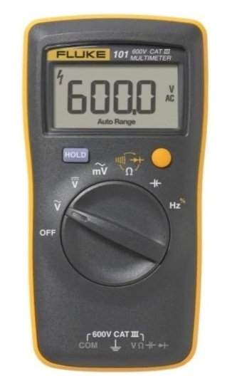

Everyone should have a battery load tester ($25) and a multimeter ($50).
Compare voltage across battery while cranking which should be same at starter.
Measure from battery --negative to starter case...should be 0 zero volts, otherwise bad ground.

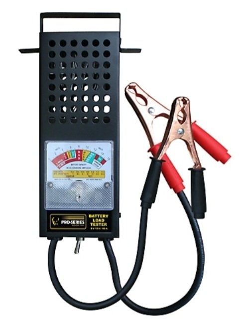

I like this battery load tester a lot better than the modern ones. And while I would agree that cables are a good first place to check, I never make assumptions about what I will find as a problem. Every machine has been through different things. Differing levels of experience and expertise of the guys who have worked on the machines are a major factor in likely problems.

As the other guys have mentioned check the battery, it is most often the problem. Batteries need to be checked open circuit and with a load applied. If you can measure the current while loaded and the voltage droop you can calculate the battery's source impedance which is a strong indicator of the battery's condition. When there is a lot of voltage droop the battery is usually shot.

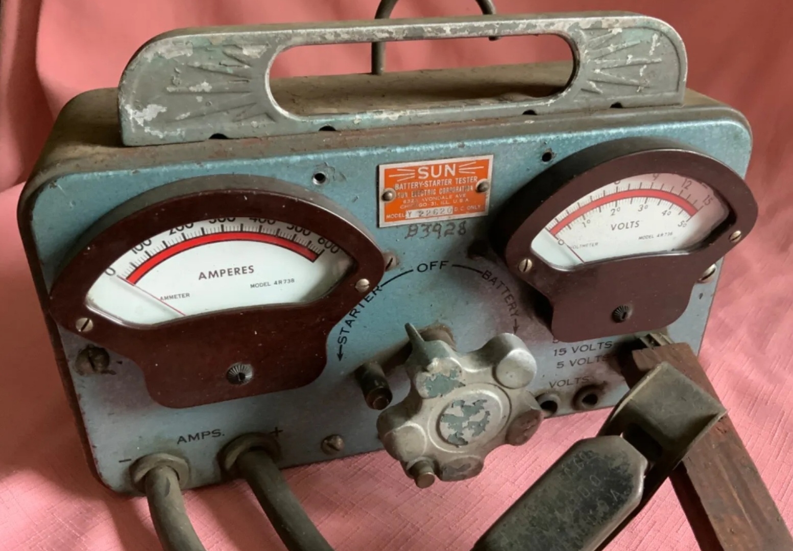

great carbon pile load tester,and a Sun.
/ Starter solenoid #18
Yup, they made excellent stuff. I always keep my eye out for any at yard sales and such.
I was a auto electrician for 13 yrs, I rebuilt heavy equipment starters and alternators,the shop had one on the sun carbon pile load testers,looked a lot like that one but was on a stand. after rebuilding the alternators used it to load battery on the alternator tester make sure it was right before delivering the unit.they last forever and the carbon piles are replaceable
