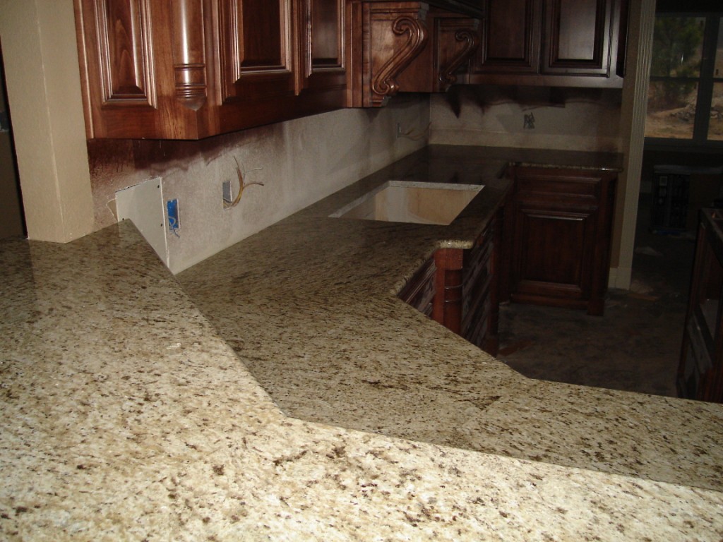

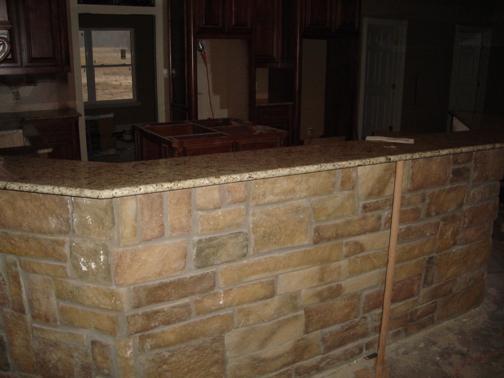

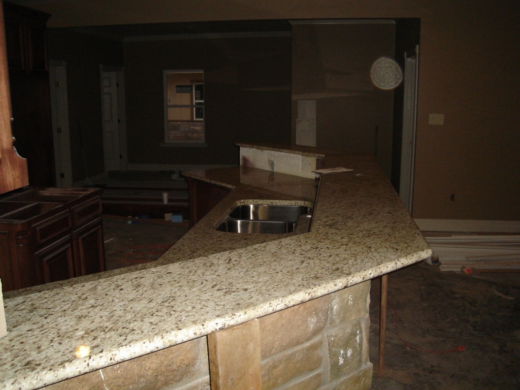

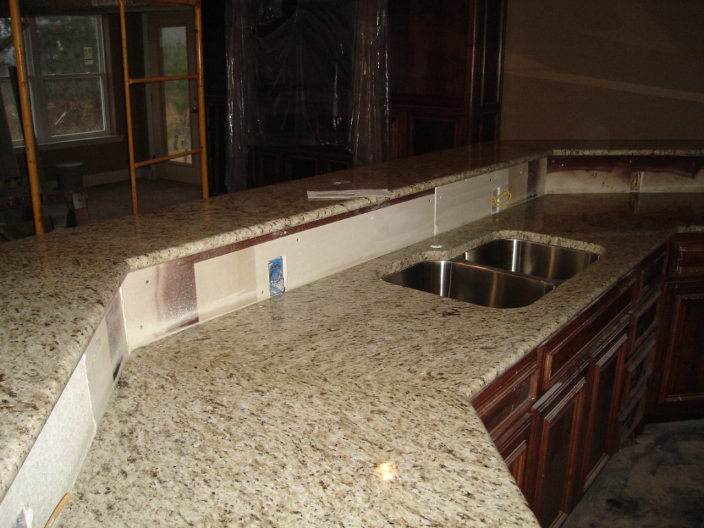

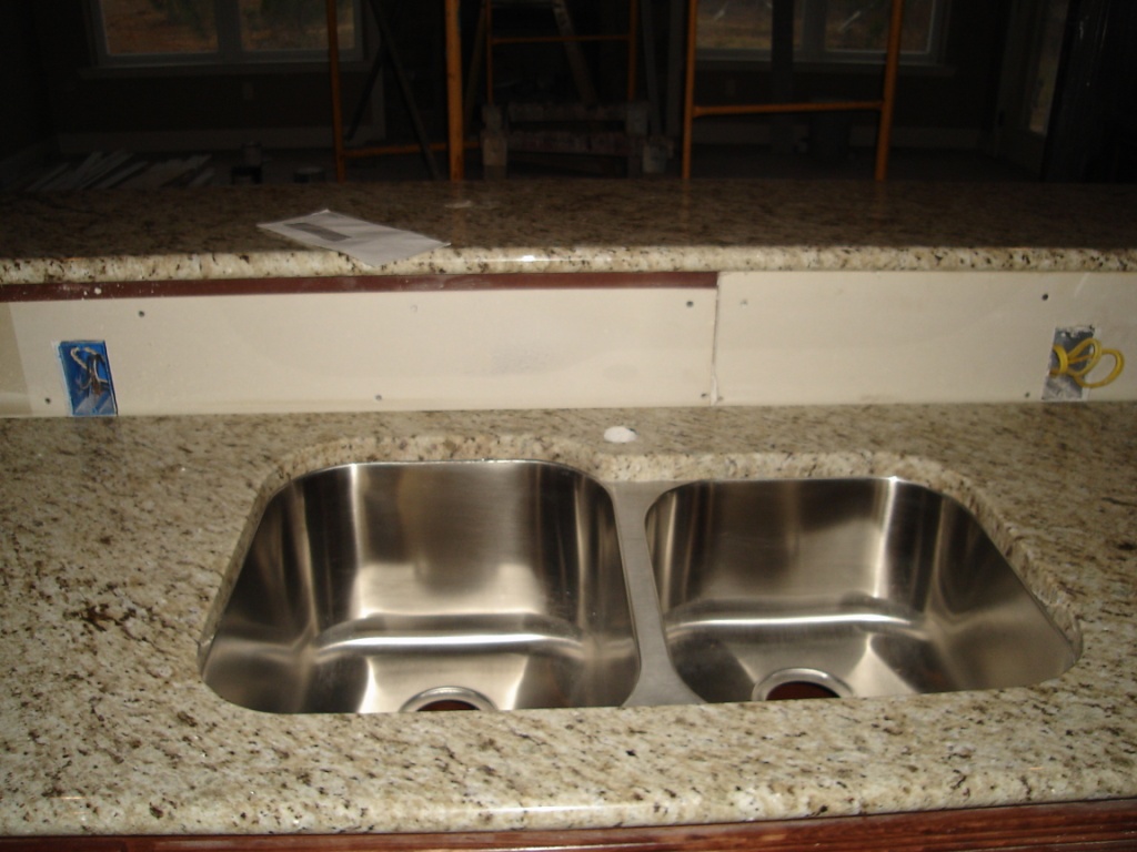

Well they have installed the countertops, I had to go look this morning to see what they looked like. So here are the pics.
