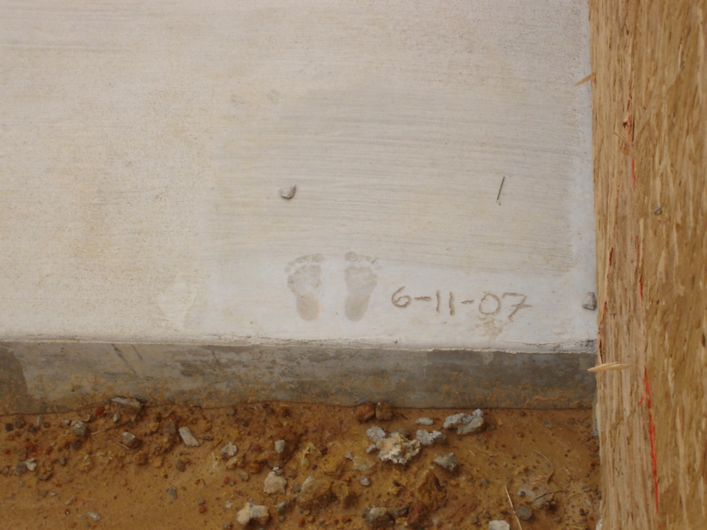

I have to put this pic in also, it is my 11 month olds foot prints in the back patio concrete.

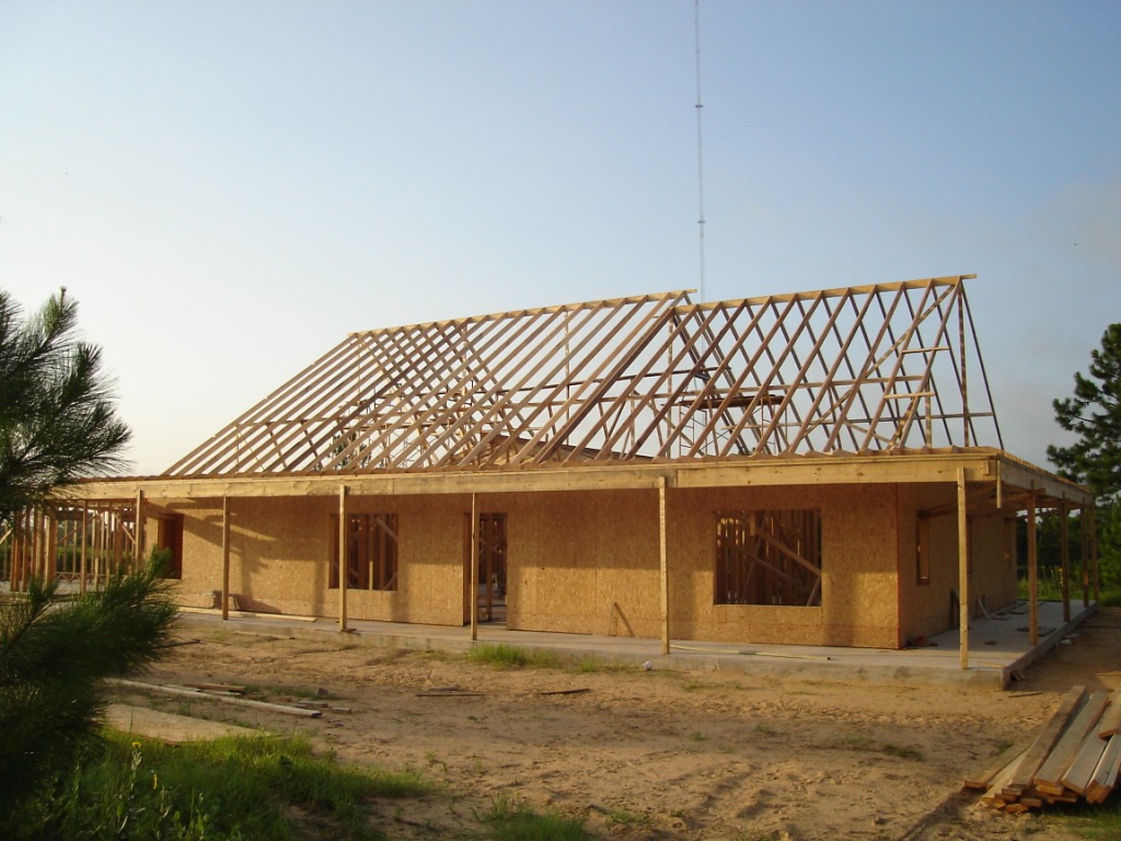

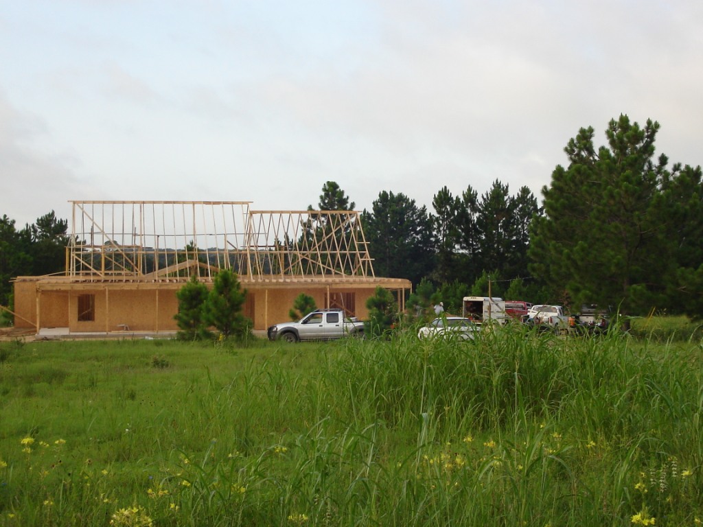

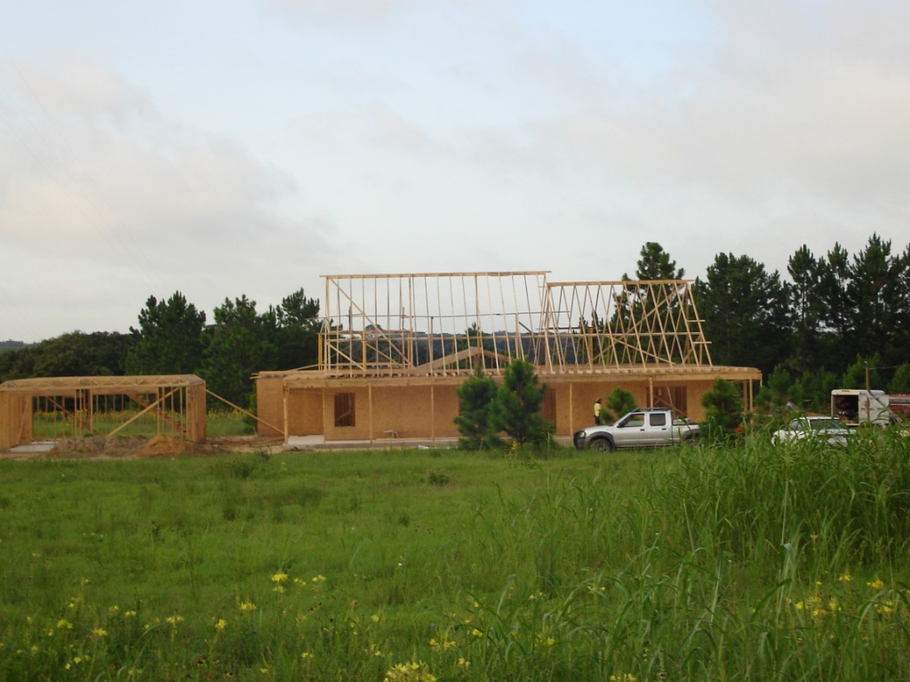

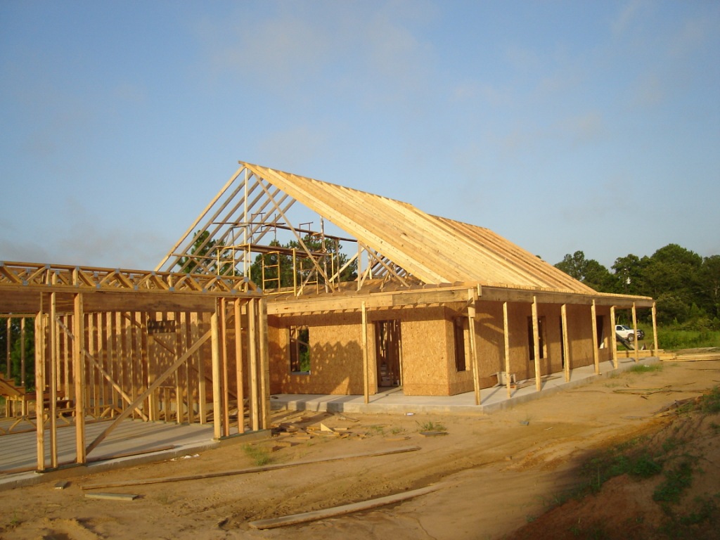

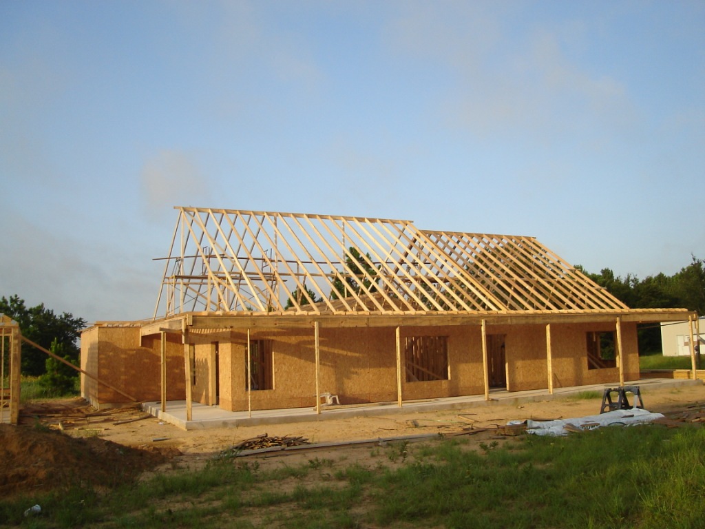

Update,
Well we a starting to make some progress this week. My contractor and his crew have made a little progress in the last couple of days and I have a few pics here to share. We started the roof on Monday morning, he told me it was a bear to get it started due to the height, it is 24' from the grounf to the top of the roof peak. He hope to get it dried in this week. These pic are from yesterday morning.
