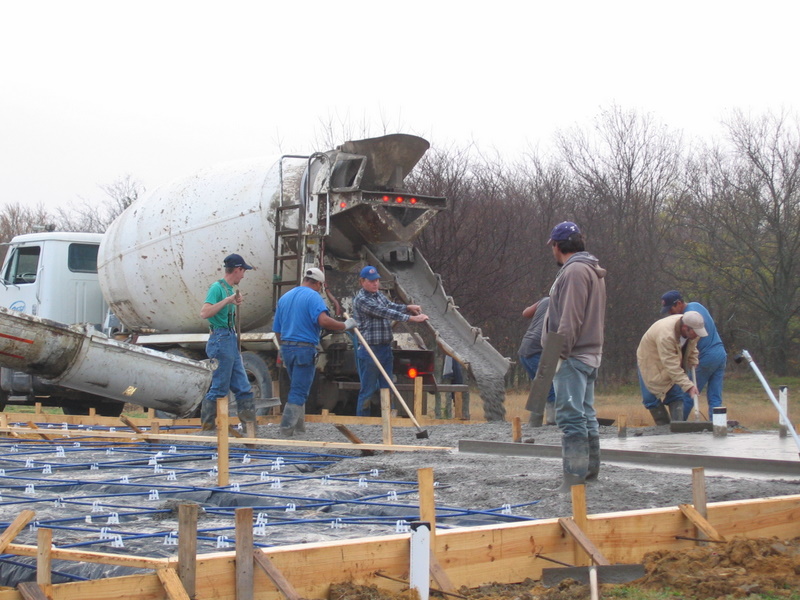

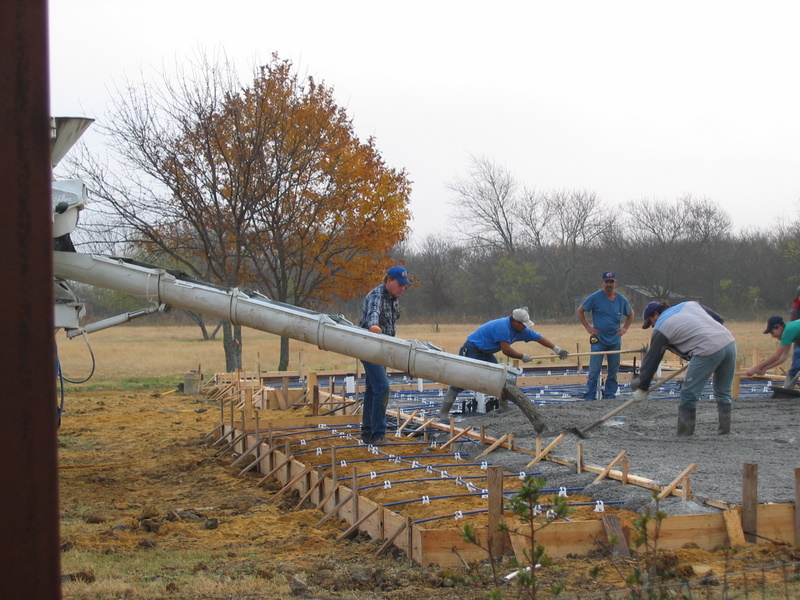

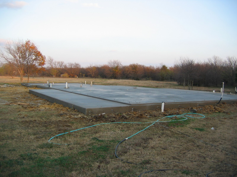

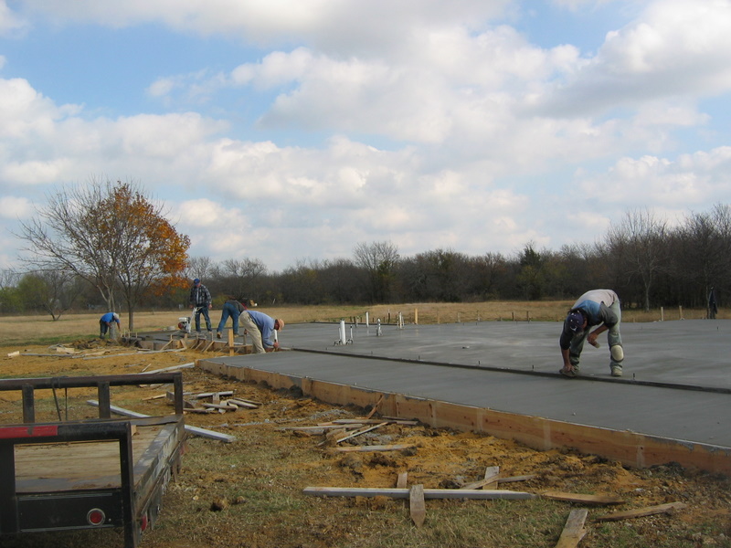

Poured the slab today! Just in time, as we are expecting a hard freeze Thursday night.

   / Starting New House Finally! #25
Congratulations Alan!!!
The hardest part is done, the rest is easy.
Eddie
   / Starting New House Finally! #26
Perfect timing, Alan. That slab will be nicely set before the chill and the ground will be warm enough that it won't matter. Congratulations, you are on your way.:)
