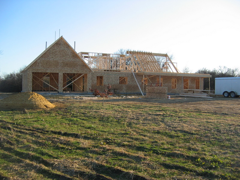

sure feel great to get in doors and windows doesn't it? Must be the camera angle but it looked like the roof of the porch was sloping towards the house. I am sure that can't be right and it jsut must be the camera angle. Do you have a name for your spread/property/house?
Rox, I guess we don't have an official name for the place yet. The slope of the porch ceiling looks the way it does because of a crooked photographer (me). It is flat and level. The floor of the porch actually slopes away from the house.
Here is a picture of the front showing the posts. They put the decorative braces at the top of the posts today. The siding on the dog house is hardie plank. We almost put the same cedar siding up there as the back porch, but decided against it because of the sun exposure this area will experience.
The front door is new, but also will have a shelf under the windows and some window light dividers that go on it.
The balcony on the rear is holding things up. Before it can be finished, a pan has to be made out of sheet metal and then ligh-weight concrete poured on that. They came and removed the temporary bracing (from floor to porch overhang) and put braces back to the wall, so that they can finish the floor. Basically its a big piece of flashing upon which the concrete will be poured.
We just had a third rain since the roofers left the ridges uncovered, which is really hacking me off. I don't know why they didn't cover them temporarily. One of my wood windows got wet on the lower sill. I dried it off and it appears OK, but raw pine is not supposed to get wet.
It took 4 trips to get the 28 pallets of brick delivered (14,000 brick). The turn into my property was too sharp for the big brick truck to make it, and they had to turn around and came back once a day or a several day period.
The electician is supposed to be here Friday and the HVAC contractor Saturday. They delivered a bunch of flex duct and metal plenums today. He is putting in 2 Trane 16i units, plus an auxiliary minisplit in our bedroom and an energy recovery ventilator (to bring in fresh air).
I am still debating on the insulation between open cell completely filling the walls and cathedral ceilings vs close cell foam 3/4" only to seal with lose fill dry cellulose netted into the walls and same on ceilings. Price probably about the same - $8000 for the house. I am not doing the entire envelope but opting for a vented attic with radiant barrier.

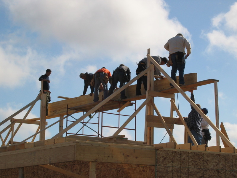

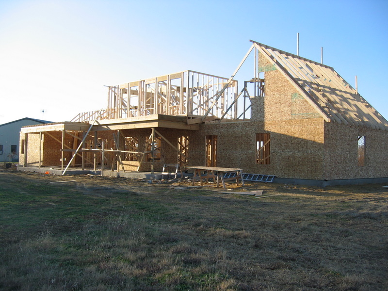

Rox, in the back of the house there is an upstairs porch, or balcony. Below the porch is part of the downstairs porch. There is a bedroom and loft upstairs, and there are exterior doors on both that lead out to the balcony, which is 6 feet deep by 23 feet long. The balcony is covered with a shed roof.
Currently, the floor of the balcony is 1 1/8" tongue & groove plywood, the same as the floor of the second floor inside. Obviously that will not hold up to weather. So the plan is to put a sheet metal "pan" on top of the plywood. they will then pour light weight concrete on the pan, so that the floor of the upstairs balcony will be concrete and weather proof. The light weight concrete is to reduce the load on the structure holding it all up from below.
I found today this metal pan installed is going to cost about $800, and the concrete will add some more cost
